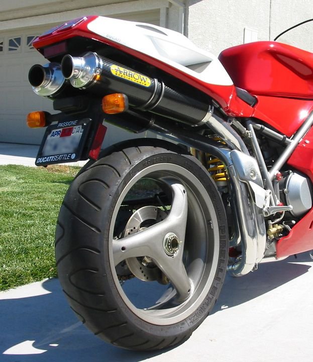

All I can add is that if you're also into having them look good, I would have them coated before installation. Even though they're made of 304 stainless, the surface will corrode. Probably has something to do with the tubing not being passivated after forming.
SLP Tri-Y headers; 304 stainless (uncoated)
Ceramic coated, SS exhaust system.
