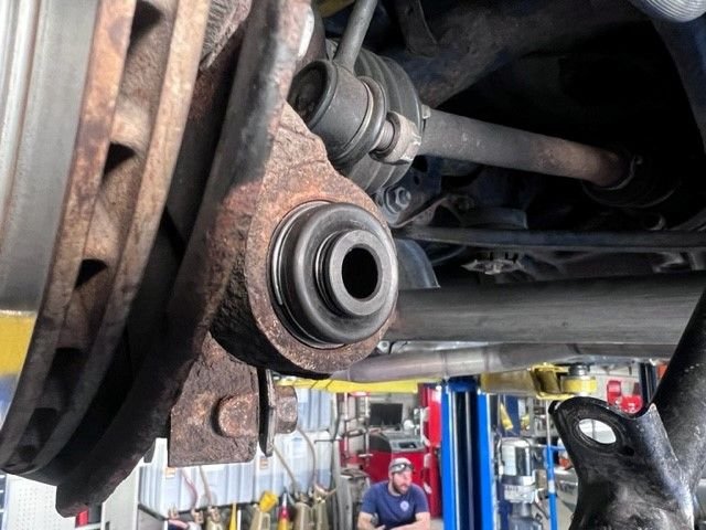

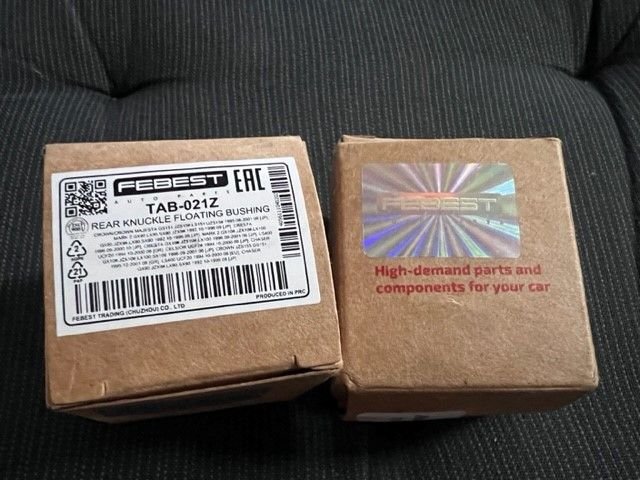

If it feels like your rear end is very unpredictable, then you likely also have bad rear knuckle bushings. There's a floating rear bushing that can get a lot of slop in it. Febest makes them for $18 each on Amazon and they press right in/out with a C-Clamp tool. I've used their Front LCA bushings and they're decent quality.

Quite the complete set they have
