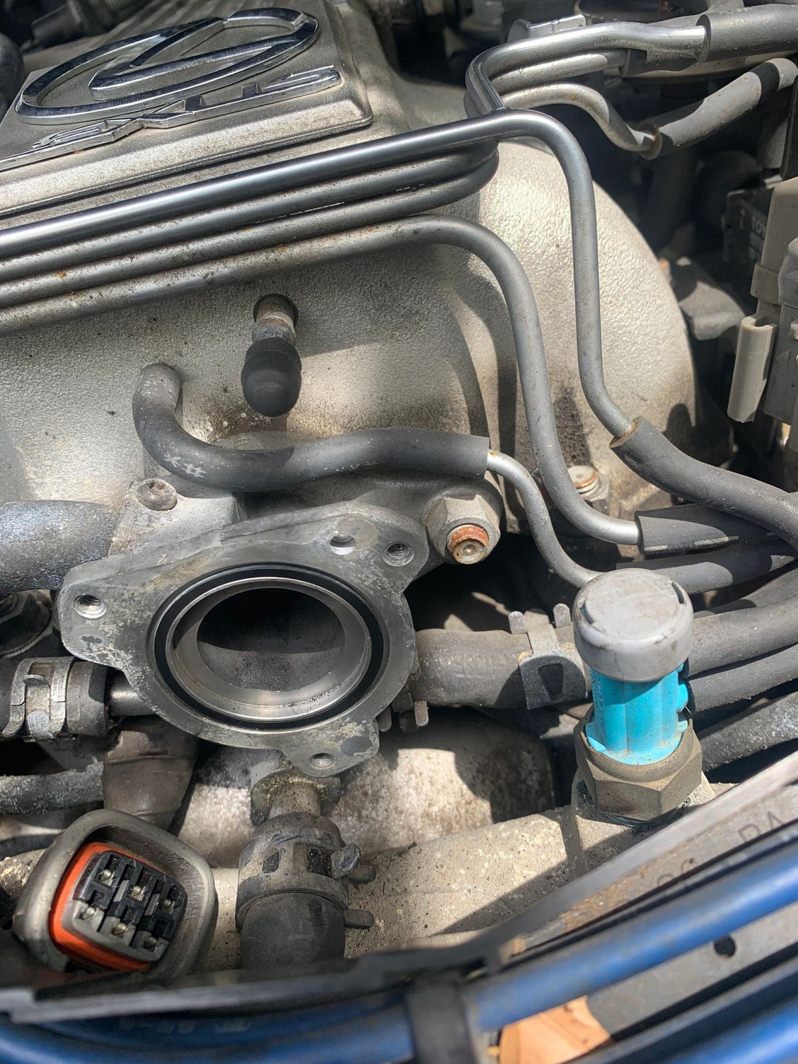

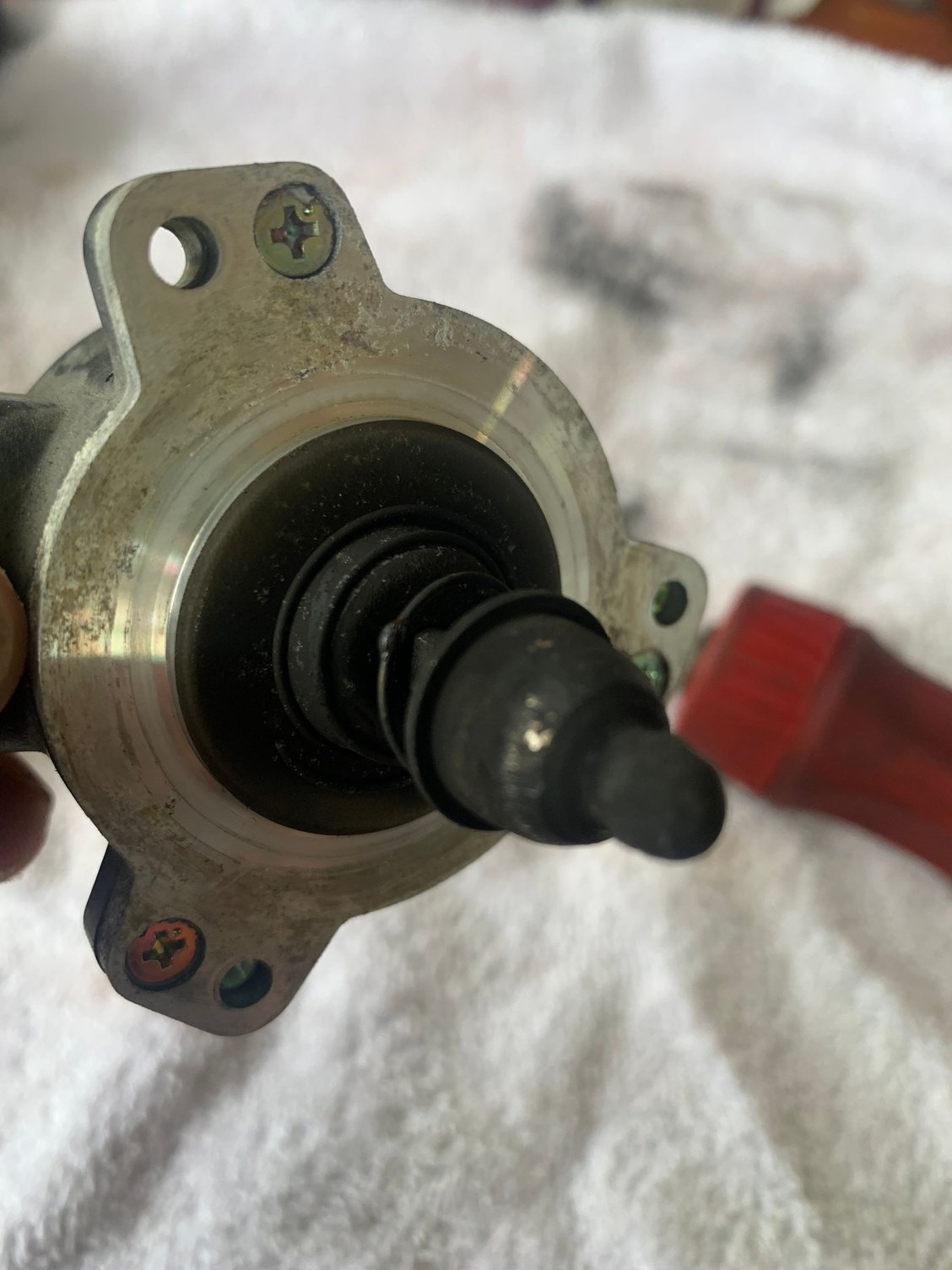

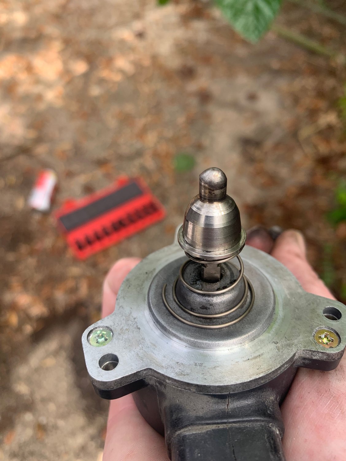

Default Cleaned the IACV and throttle body
In a effort to get the idle up where is should be I removed the IACV disassembled it and cleaned as well as check resistance across the pins as per the manual.
Before cleaning
After cleaning
Super dirty
Cold start idle….about 82*f outside
Cleaned this as well
The resistance was 22-22.3 well in range.

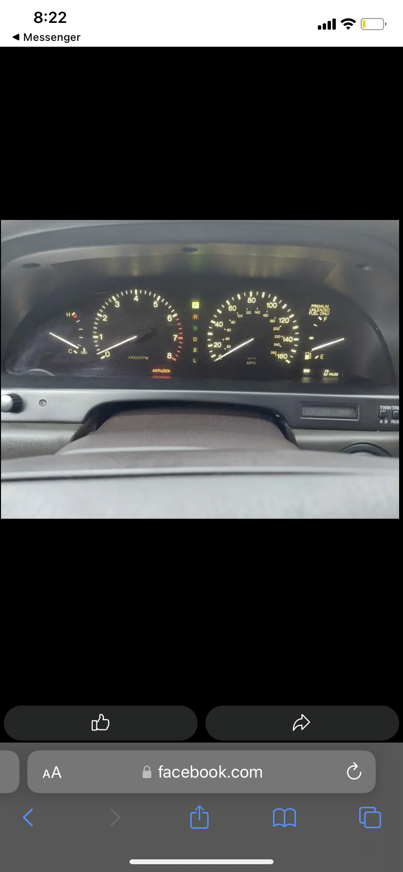

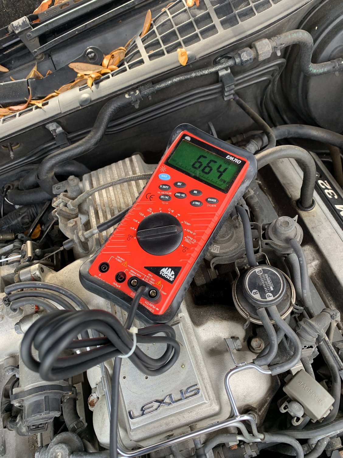

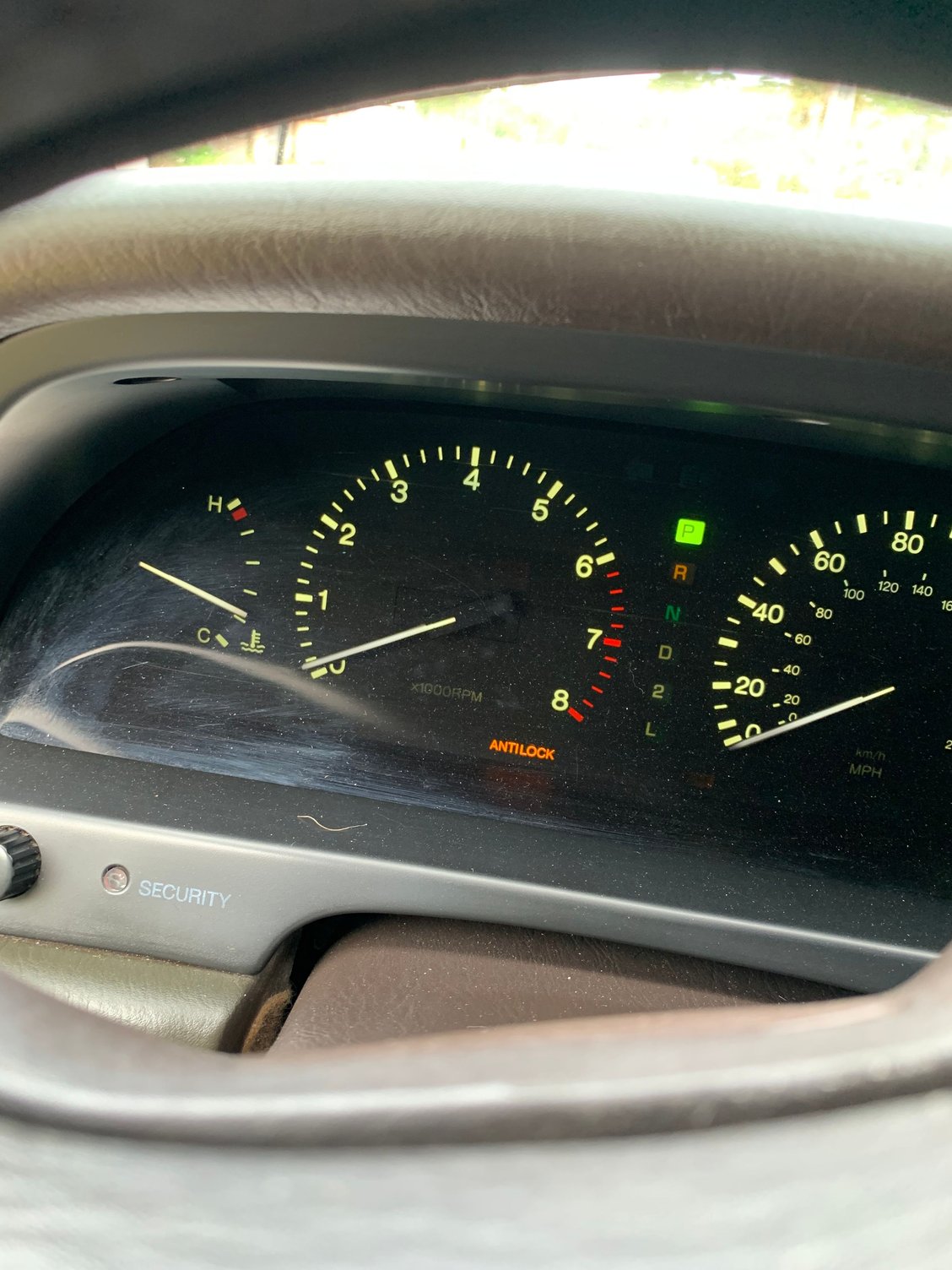

Default Cluster maybe?
So after the iacv didn’t seem to work I realized my volt meter has a rpm function so I hooked it up to a spark plug wire and the results were interesting.
Cluster reading 200-250 rpm
Meter sat at 664-660rpm
so would I be correct in thinking that it is a cluster malfunction, the ecu appears to have the engine running correctly?

In a effort to get the idle up where is should be I removed the IACV disassembled it and cleaned as well as check resistance across the pins as per the manual. Before cleaningAfter cleaningSuper dirtyCold start idle….about 82*f outsideCleaned this as well The resistance was 22-22.3 well in range.Next i am going to replace the coolant sensors, really starting to think ecu but sensors first. The vacuum lines for the power steering has been bypassed (pump plugged with a bolt of some sort and hook up on front of intake mani capped off
​​​​​​​If you want to go a step further with the iacv you can replace the bearings inside. ​​​​​​​

Originally Posted by fondu
If you want to go a step further with the iacv you can replace the bearings inside. ​​​​​​​https://youtu.be/cT7Tlo0I4po
I did take it down further and cleaned and lubed the bearings with a few drops of gun oil, hands were too grubby to take pictures with my phone. Does seem to run smoother after that and cleaning the throttle body.
I was finding it hard to believe that it was really idling that low seeing as it runs so smooth. Now I know that it’ idles right I just need to get the cluster repaired.

Nice. One of the best decisions I made was purchasing a used, working cluster to have for spare parts. 90-92 and 93-94 have totally different clusters internally.
