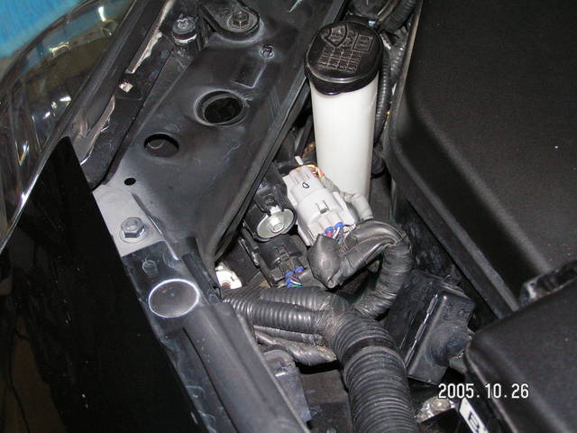

Here is my understanding, please tell me if I'm right. Wherever the lights are adjusted to via the screw on headlights, that is where the computer levels to. Does it matter if the ignition is on when you adjust the screw?
Is this screw in center of pic the one for up and down adjustment?
thanks

Yes, that little 8mm screw is for the up. You can adjust it with the key off, but make sure you find a good level pavement.
The auto leveling function got the signal from sensors located on the front and rear lower control arms. Those sensors send the signal to HID ECU to adjust the headlight up or down while you're driving. The sensors measure the load of the vehicle, the braking, the Yaw rate sensor which measure the turns, up or down hills etc.... That's was what Lexus means of auto leveling while you're driving and trying to keep head light as level as posible.

VVT-i, where is the ECU or computer for each self-leveling HID headlight located and what does it look like? Can you access it for removal without taking the headlights out of the car? I am trying to trouble shoot a single headlight that does not self-level. The other one works fine. I have a replacement leveling motor in case I need it.

The main computer in the LS is behind the glove box, but if your talking about the leveling motor itself, then its on the backside headlight. You might be able to check connections without removing the headlights, but to really do any checking, its wise to remove the entire assembly.
