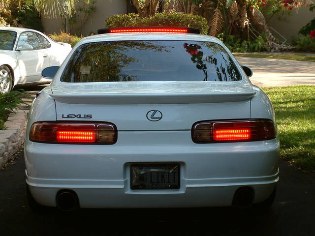

Hey guys just popping in to show off my latest LED retro. I know some of you guys in here like this sort of thing like I obviously do.
LED moonroof HMSL and LED tails:
Click for full res.
The tails don't need much explanation. Just two rows of 16 LEDS for 32 LEDS per side. The Moonroof HMSL (high-mount stop light) is an LED strip I had lying around that I decided to finally use. The weak stock HMSL was bothering me so I decided to do the moonroof light. I had done it once before in my Celica (as seen in pic). The moonroof works as stock. Tilt, slide, everything works fine. A simple wire retracting brace was fabricated to allow movement of the entire assembly with the moonroof. There's a switch that returns the stock HMSL to active duty when the moonroof is closed which is only when it rains. Otherwise the new 48-LED unit is at work. Total 112 LEDS facing the rear. At night, everything behind me turns red when I brake. All LEDS are DOT approved for automotive signaling use.

I've had it lying around for a few years... I'm guessing it's from a Cadillac as they are the only cars with HMSL's that long. I have a collection of LED's, lights, and such to experiment with so I can see what works and what doesn't.
Nowadays they sell LED strips just for this sort of thing... The low rider truck scene uses these a lot on the bottom of their tailgates. Come in many sizes. Not so sure about reliability tho.

Where is your stock HMSL?
Does it switch automatically between the two or do you manually flip a switch?

The stock HMSL is in the middle of the rear deck like most cars.
I have to manually flip a switch because that is the cleanest way to wire it. I could use the sunroof limit switches to make it fully automatic but I'm not interested in the complication, the hacking, and the extra non-OEM wiring. (I had a similar setup with the limit switches in the Celica where the alarm controlled the sunroof -- cute, but major hacking.) Besides I like having full control with my switch. Plus I barely ever need to use it. I've used the switch maybe once in the past 3 weeks?
To remind me that it's on, it flashes blue when the brakes are applied. It's mounted under the back seat on the tranny tunnel. This location keeps my dash clean, makes wire runs minimal as it's closer to the action, and is invisible. Access is simple as well. Just reach your arm back.

And can both the stock and moon-roof mounted HMSL work at the same time?
Is this legal?

Yes both can go at the same time if I want. Legal? I don't see why not. Many cars have several brake lights from Monteros with the stop lights in the bumper, to dealer installed spoilers with LEDs on cars that still have the deck-mounted HMSL. They never get bothered so...

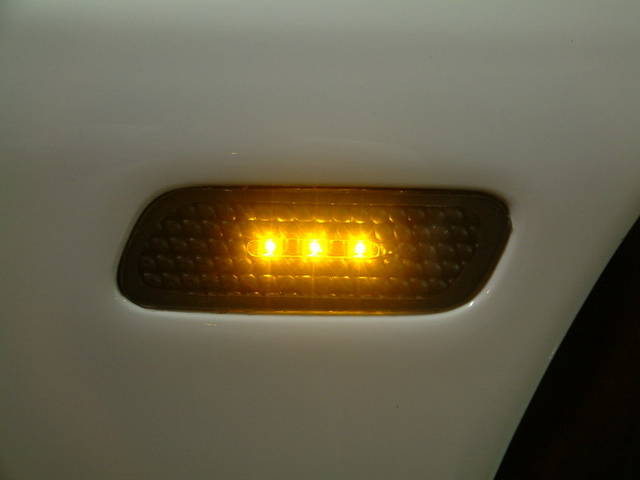

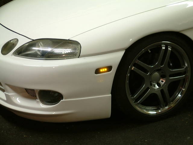

Default Amber LED Markers
As promised, the amber LED marker lights for the front bumper.
Off:
On:
From a distance:
These are completely custom made. Custom LEDs, custom cover, and custom dimpled diffuser lense. The color I used is the same gunmetal on the headlights, high beams, and fogs so it's all uniform.
