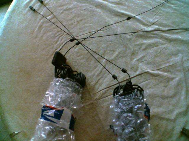

Bump. I'm gonna need this (and a little help) when I install the Kenwood KVT-910 in my ES300 (1999) later this week. Help!!!!
So far, I have the wire harness (this one)
for the ES300. They say its for 1992-99 years. I'm guessing it matches with the wide plug that would go into the factrory stereo behind the dash?
I also have the Kenwood harnesses that the seller gave me
and
along with the wires for the unit
and the Metra dash kit
My question here is this: Will I find the LExus AMp under the passenger seat like on the 92-96 ES300 OR behind the dash (like someone's post here on CL)?
Reason being I noticed that the Kenwood wires (16 pin black plug) may not be long enough if I need to install it under the chair. I know I can extend them to behind the dash to reach the ACC, POW and Illumination/ speakers etc. but I'm confused about whether I'd have to disconnect or bypass the amp and splice into the wires OR can I use the original amp, leave it wired as it is and just use my harness for the ES300 and plug all the kenwood ones up to that. Has anyone who's done this remember how the install went? I know a few people had this radio back in 02-03 and may have forgotten about this mod since folks have moved onto other things.
