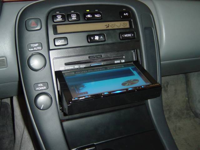

Sorry. Just got your PM. I have the AVN5435 and like what Baoser said the shop that installed mine made a 1/2 Din CD pocket. Also I had to buy an amplifier to use the stock sub otherwise you wont be able to use your stock sub because the stock amp doesn't work with the AVN5435.
Where in Cali are you?
Edit here is another pic, I brought it back to make them push it in to make it more flush. You'll notice in the first pic it sticks out a little...

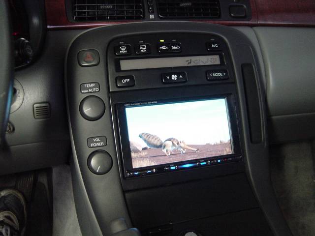

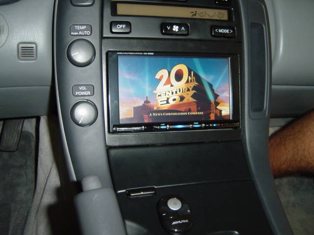

Here are several pics of an Alpine IVA-W200 double DIN flush mounted. I think it looks better without the pocket and centered in the dash opening.

I personally constructed the trim ring using 1/4" MDF and a router table. I use templates to create the outer size as well as an inner double DIN hole to route out the inside. After a little sanding, it's primered a couple of coats and then painted "Satin Black". The radio is set back and down on the SC400 factory stereo brackets, which means you need to drill new mounting holes on the bracket.
I'll try and see if I have any pics of the build and post later.
