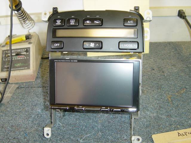

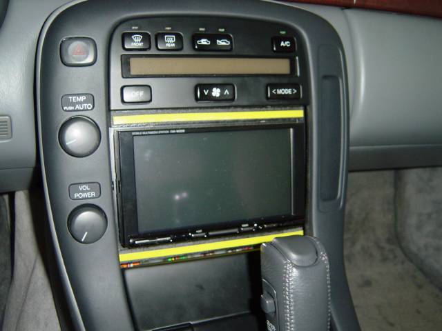

Centered the double DIN stereo, left roughly 1/2" above and below the stereo, flushed the stereo back so that the nose stuck out about 1/8".

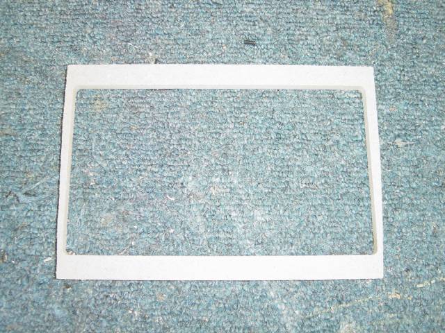

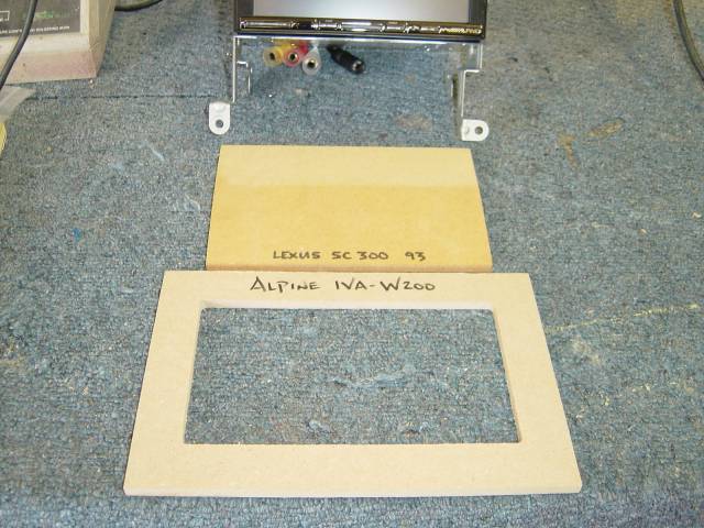

These are the two templates I used to create the trim ring. One is the outside border while the other is the inner double DIN (the hole size is slightly larger than the radio nose piece so that the stereo nosepiece can open, about a 1/16" gap all around)

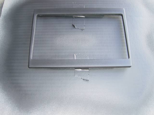

This is the trim ring after using the router table with a flush trim bit, also primered.
Painted the trim ring with SEM's Satin Black spray paint, couple of coats.
Double stick tape on top and bottom will hold the trim ring in place.
