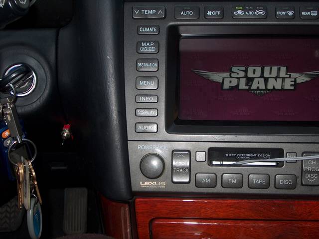

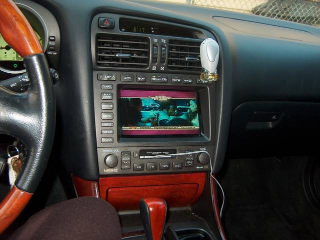

Buy the unit and then do your own installation, you'll save about $700. Excuse the cassette adaptor, I'm still working on hardwiring the audio.....

I was going to hardwire it but it's just as simple (and louder) to run a cassette adaptor (I never plan on putting a cassette in there) to whatever you are going run and just hit 'tape' The sound wire is currently hidden under the nav and will soon be running behind the glove box.. (Right now I have a portable DVD player under the passenger seat but I have a slim PS2 that I'm going to put in the glove, just haven't taken the time out to get back in there). Installation (now that we have the wiring diagram) should be less than an hour, you're cutting four wires (the hardest part is taking a pair of wire cutters to your nav harness).
The store is on 77th St in Canarsie.
