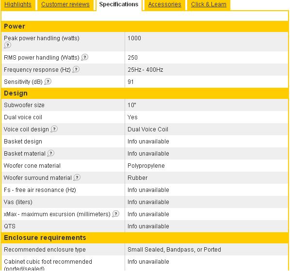

I dont understand that (not to sound totally dumb) thats speaker talk and i dont know that language Like ATLEAST a 800 watt amp???
Or ATLEAST ??? watt amp?
Like in this screen shot can u break it down a little, does this mean if i got 2 of these speakers i would need atleast a 500watt amp or its saying 500watt max power because the RMS is 250??

I'll spare you the serious techie talk - think of RMS as the average power that the woofer can handle continuously. (It's not, mathematically, but you'll get the idea.) The peak power is the maximum power it can handle, but only temporarily. Given this, you size your amp so that its RMS power output is about equal to the speakers RMS power input rating. If you have more than one woofer, multiply the RMS number by the number of woofers to get the desired amp power. (Generally, all woofers connected to a single amp should be identical.) This roughly matches amp to speakers, and allows for temporary spikes in power (like those found in music) without blowing the woofer(s).

yea what he said, 2 10" woofers 500 watt amp, 1 10" woofer 250 watt amp roughly, doesnt have to be exact just around.
