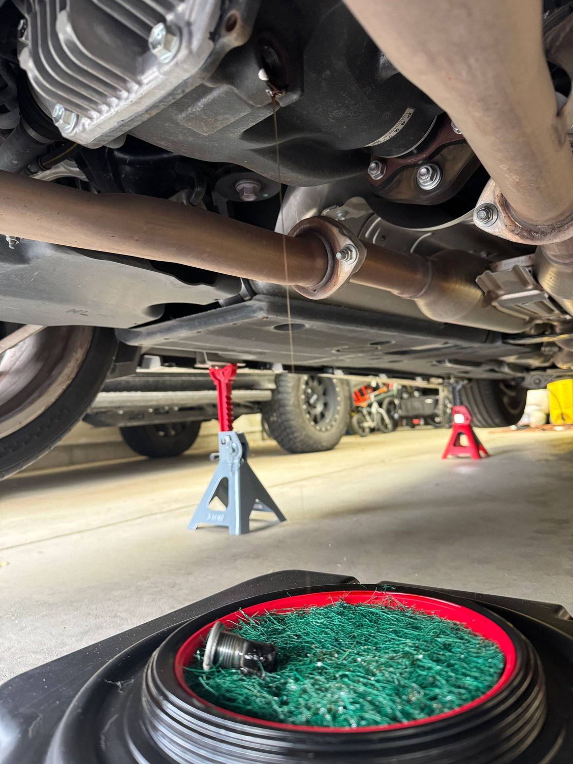

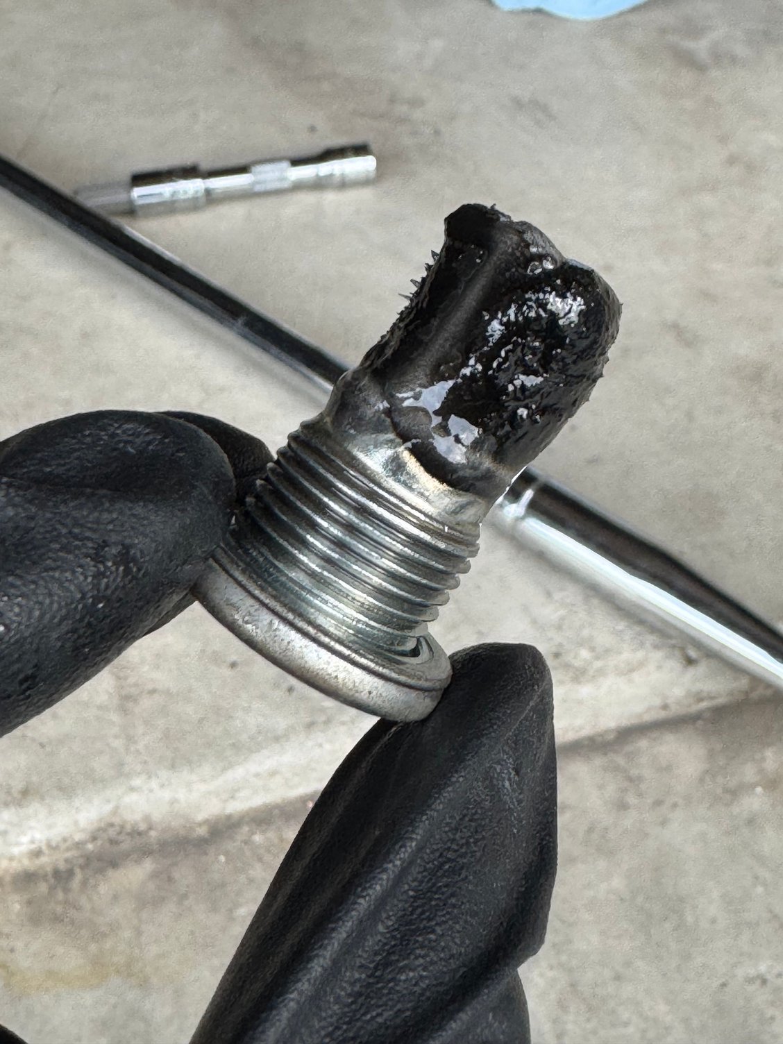

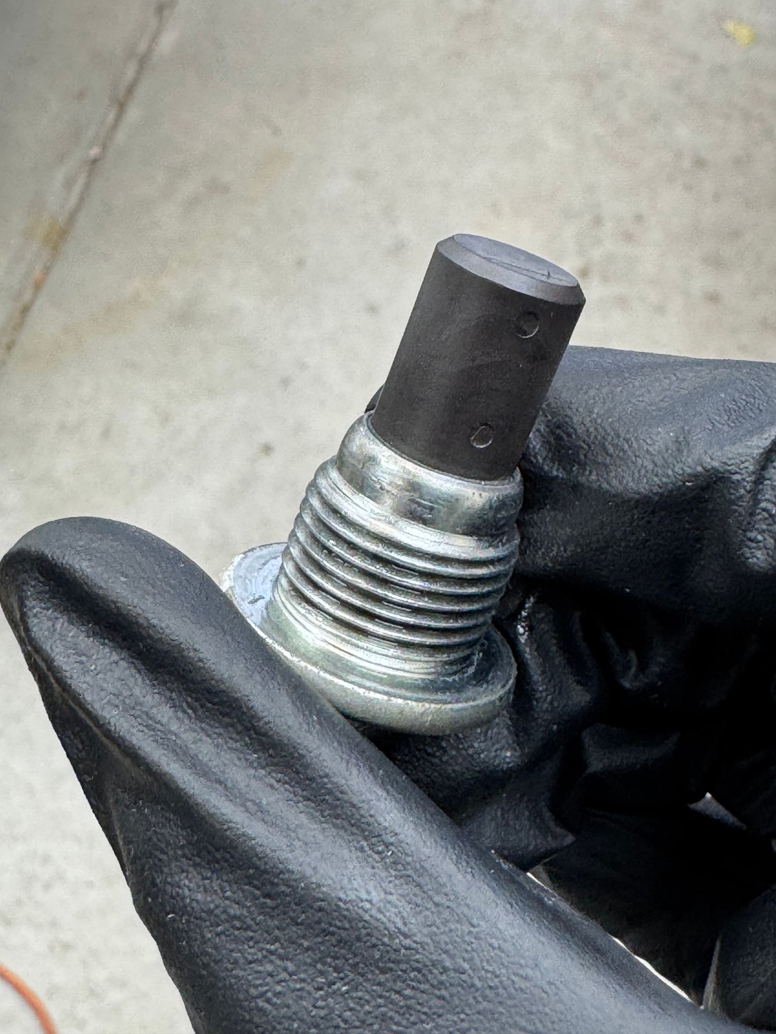

in other news replaced diff fluid at 60k. Fluid still looked pretty clean but a lot of junk on the plug.

Change my Maserati diff. every 35k. I've dropped it after 1k and it is as black as midnight!

if I were original owner I’d probably do it at 30k. Although the fluid still looked like it was in good shape at 60k for this one.

I'm assuming you service like any other diff. Pump in new fluid until you get a small, steady stream flowing out of the fill hole?
Old Jan 12, 2026 | 07:58 PM
  #2996
sbao's Avatar
sbao
Joined: Feb 2023
Posts: 49
Likes: 41
From: CO
yep there’s nothing special to this diff 🙂

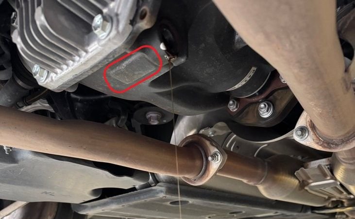

I will say though that it’ll help to have some extensions/swivels on hand. The placement of the exhaust tube gets in the way. You can kind of see it upper right here.

Thanks for the tech tip.
Unrelated, this is a great shot of the rear (center) jacking point; the more you know!

That's a very nice size magnet the LC has on its drain plug...in comparison to the one on my Maserati Granturismo. Size doesn't necessarily equate to less/more strength, but it's still good to see.
