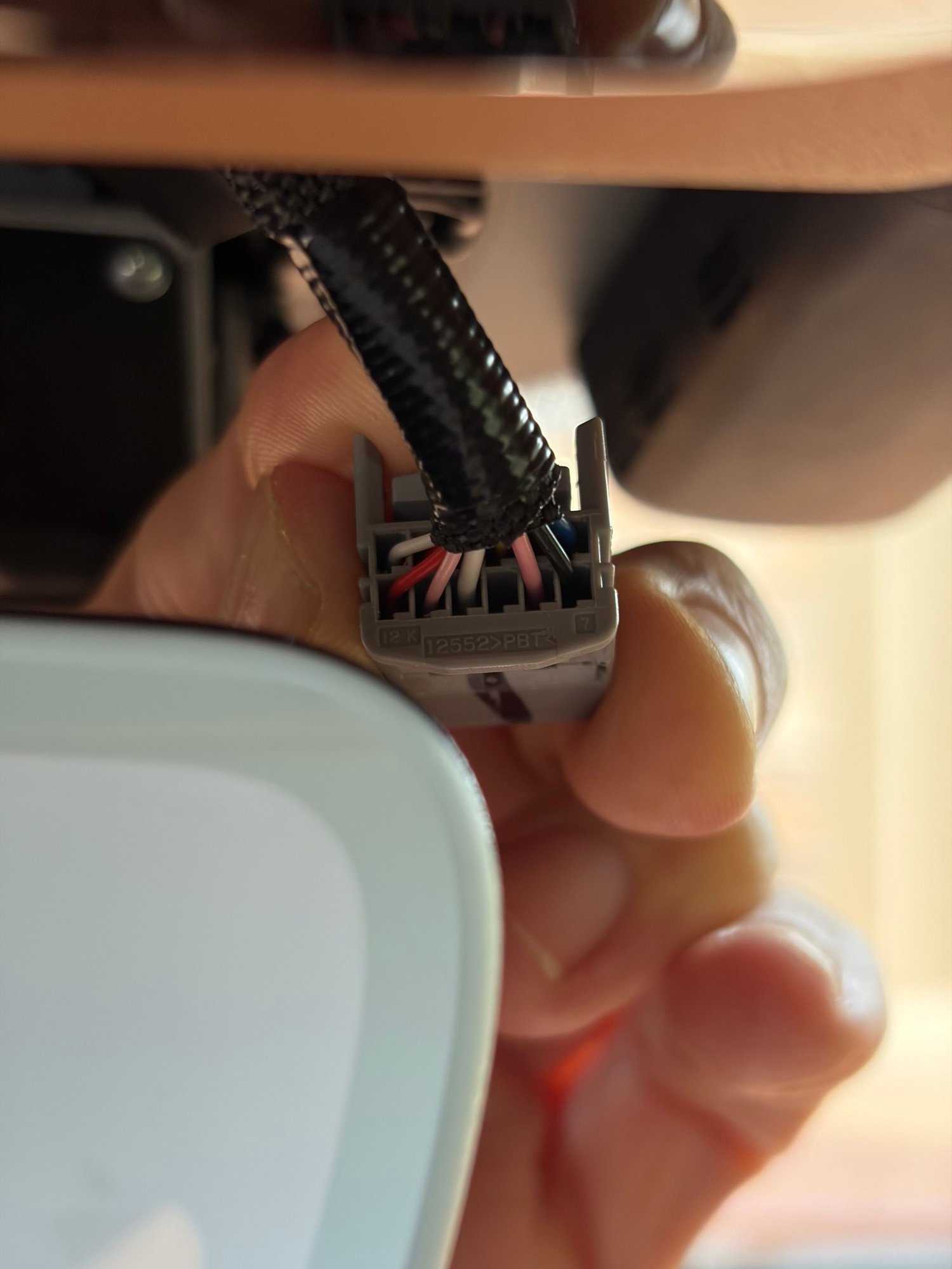

resurrection of old thread. Went to wire my 2026 and struggling a little. I think they have changed the wiring harness. This is what I see:
Using my multimeter, I find the white wire (bottom row, 3rd from left) is grounded (gets me a beep on Ohm). And blue (upper far right) gets me 12V on Accessory. However, I get nothing when I plug everything in! Briefly my Max 360c Mk2 would turn on, them immediately off a few times. Now nothing. Still works with cigarette lighter

I sorted this out. For anyone with wiring harness as pictured (mine is a 2026 Bespoke convertible) - white is ground (bottom row, 3rd from left), black is 12V with accessory position (bottom row, far right). Radar detector works perfectly now and installation is extremely clean. Blue (top row, far right) is also 12V with accessory, but for some reason my detector just wouldn't work with it.
