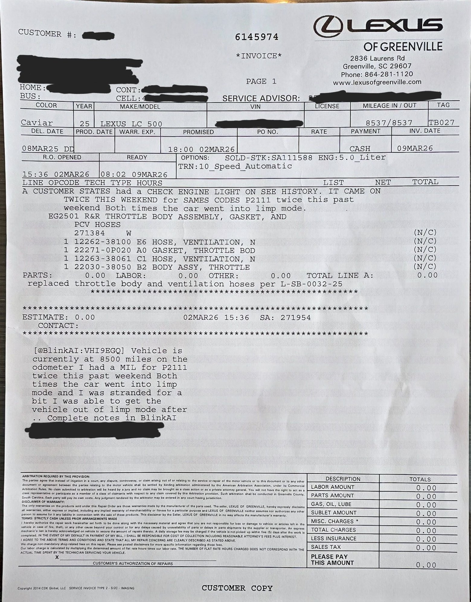

Anyone run into this on their LC? I was surprised to get a MIL on my 2025, which the dealer seems to think is this LSB. I was surprised to see this goes all the way back to the ISF. This is my third consecutive 2UR-powered vehicle too.

Interesting. This happened randomly last June. Then it didn't happen again until a couple of weeks ago. I came across the LSB and showed it to the dealer. They agreed the problem was the same as described in the TSB. I'm all stock under the hood. For what it's worth it seems to be heat sensitive issue. It's only happened on the hottest days after prolonged period of idling or driving it hard.

Originally Posted by Beachtyme
Did you take it in and have the dealer address the issue / LSB?
Yep. I just got the car back this morning. Seems fine, but as long as the MIL wasn't on it felt fine before too. I attached the service ticket.

Originally Posted by tecman
Estimated parts cost for DIY from Bell Lexus:
Yeah the total out the door with labor was $1500, but covered by warranty. $0
