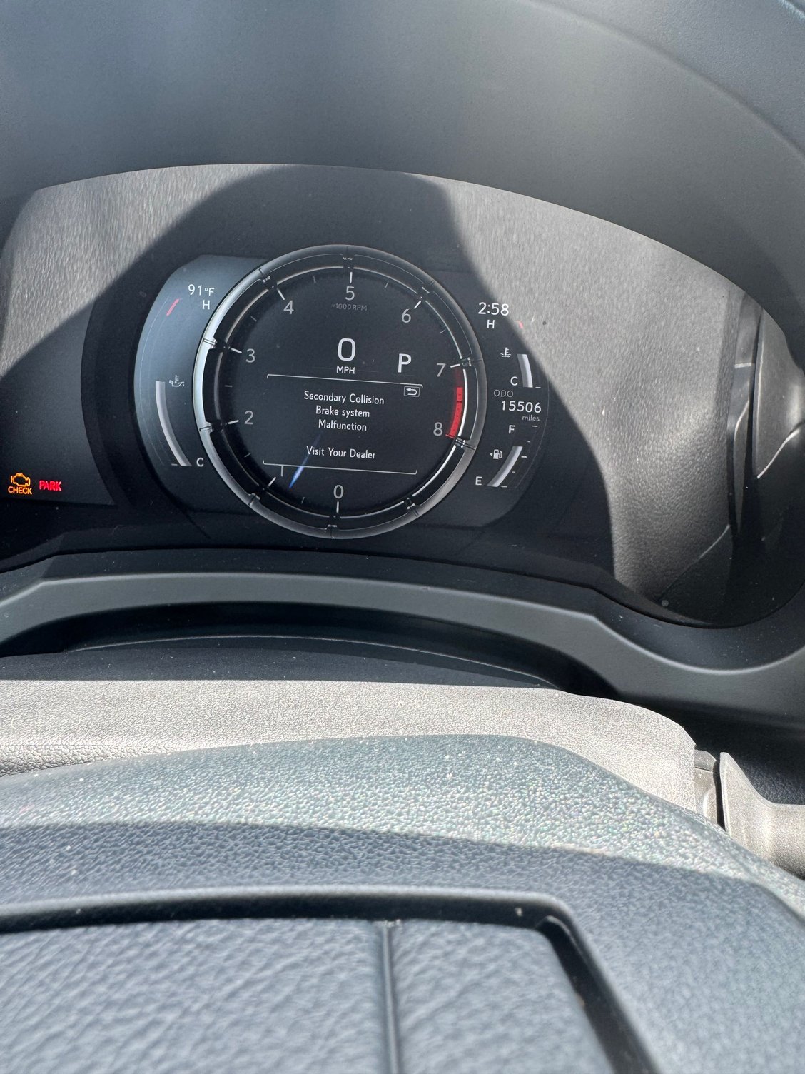

I have a ‘23 with 16k miles and had it replaced under warranty a month ago. A bunch of warning lights came on (see attached). The continued to drive fine. The service advisor originally thought it might be a depleted battery () but then told me it was the throttle body.

I had my TB replaced at 14k miles. I had all the same error codes that Phillip posted. I forget what thread it's in but someone explained why we get such strange codes for a bad TB. My car drove perfectly normal while it was going on. It was covered under warranty.
I had the exact same issue as my neighbor Philip... At 13k miles, I got a bunch of warnings, but the car drove just fine. Took it in, and the service department said the throttle body needed to be replaced (under warranty).

When I had my 22 LE I got the same codes. Ended up pulling the throttle body and cleaning really good. Codes never came back until I sold the car
