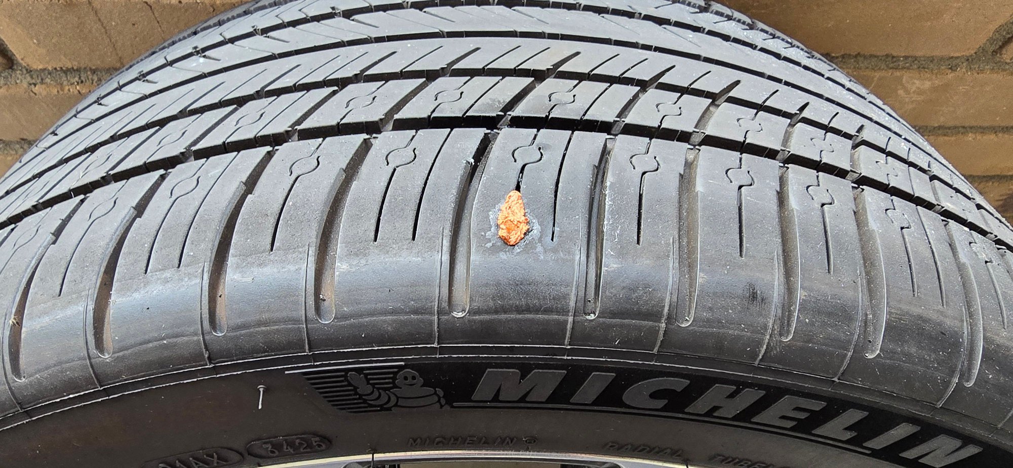

Nothing beats a good tire plug, in your driveway. 😛
My sincere apologies to the professional tire patch, community.
Old Feb 17, 2026 | 02:12 PM
barncobob63's Avatar
barncobob63
Joined: May 2025
Posts: 603
Likes: 294
thats pretty close to the sidewall.
Old Feb 17, 2026 | 03:51 PM
Timado404's Avatar
Timado404
Veteran: Marine Corps
Joined: Nov 2024
Posts: 779
Likes: 602
From: ATL
Yeppers, it is. I've had a plug in that spot, on many occasions. A tad closer and I would have gone a different route. Should be fine for grocery runs. 😅
