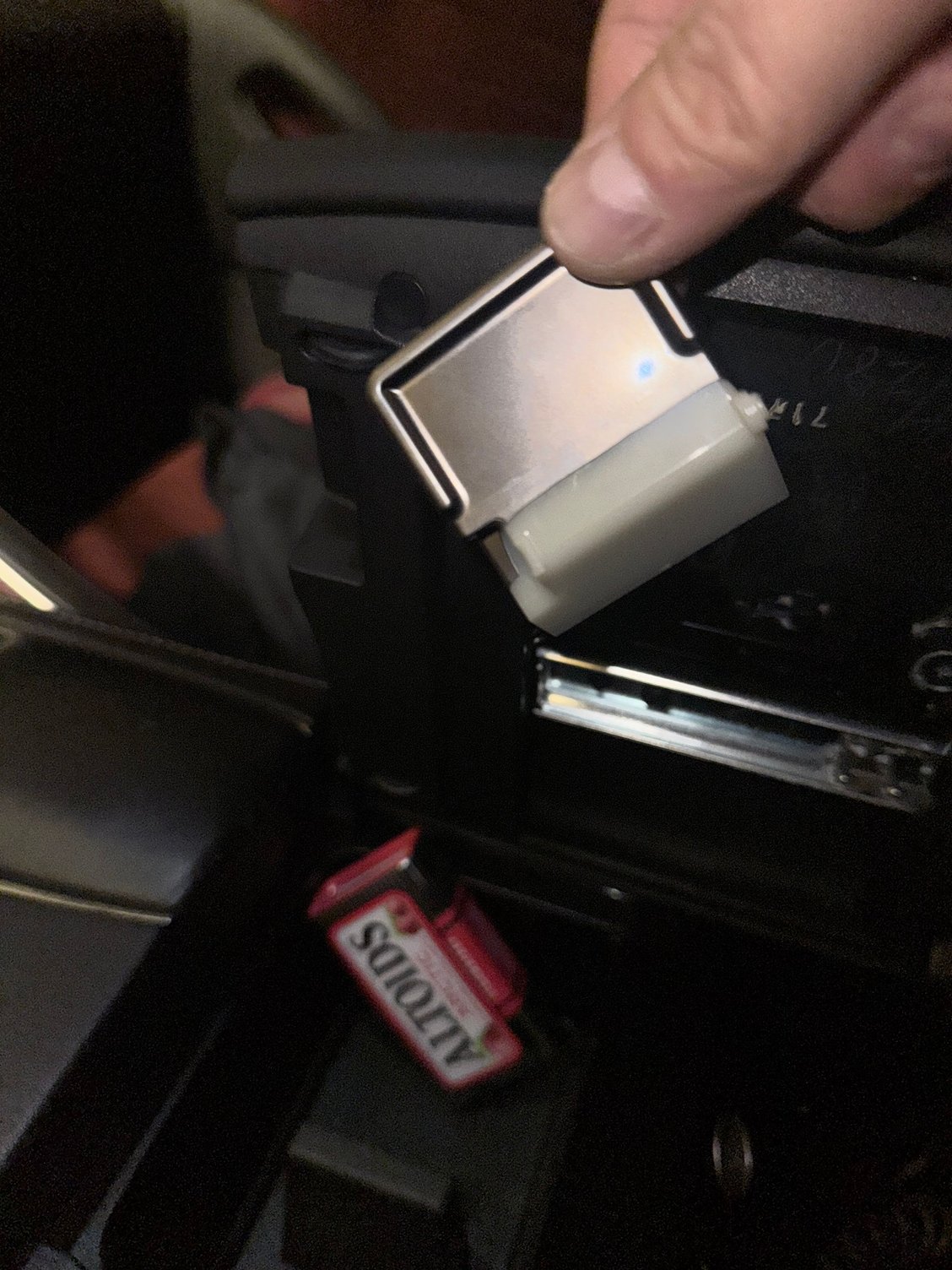

Has anyone had the lever break on the center console that opens the lid?
My lever piece got loose and then just broke off. Was wondering if there is some DIY out there than spending $500+ for the whole piece.

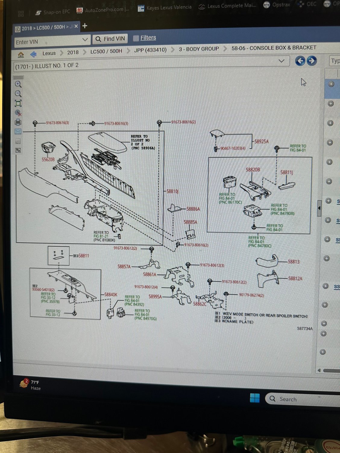

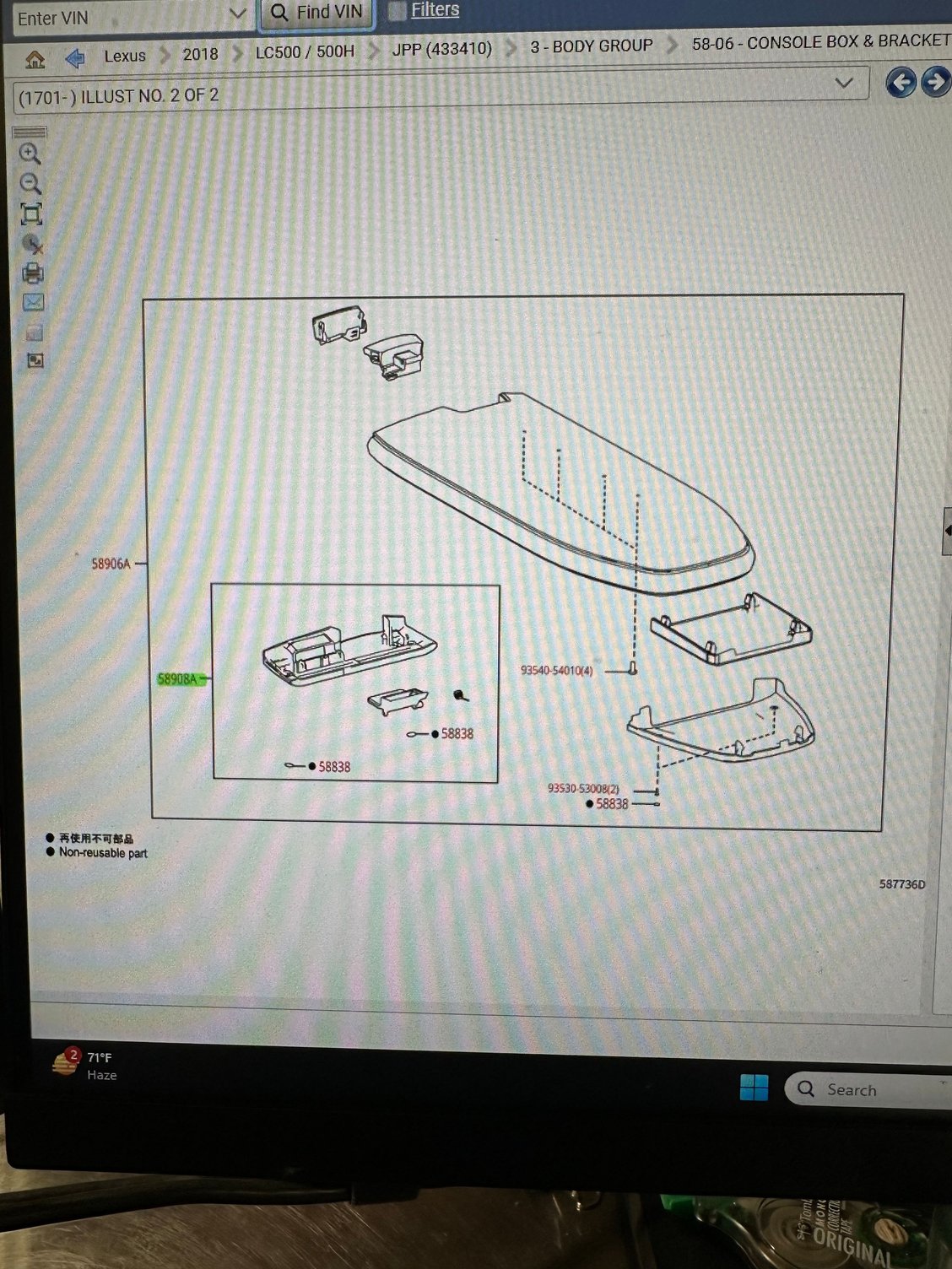

So my parts department was able to confirm the part that I found on lexuspartsnow.com

So the part I swapped out wasn’t it and the other option is to order the whole center console which is $3k. If I can’t figure out an alternative or some used part from a junkyard, velcro may be a sensible option.

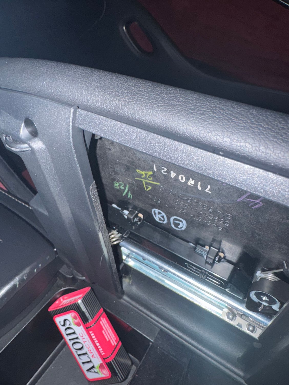

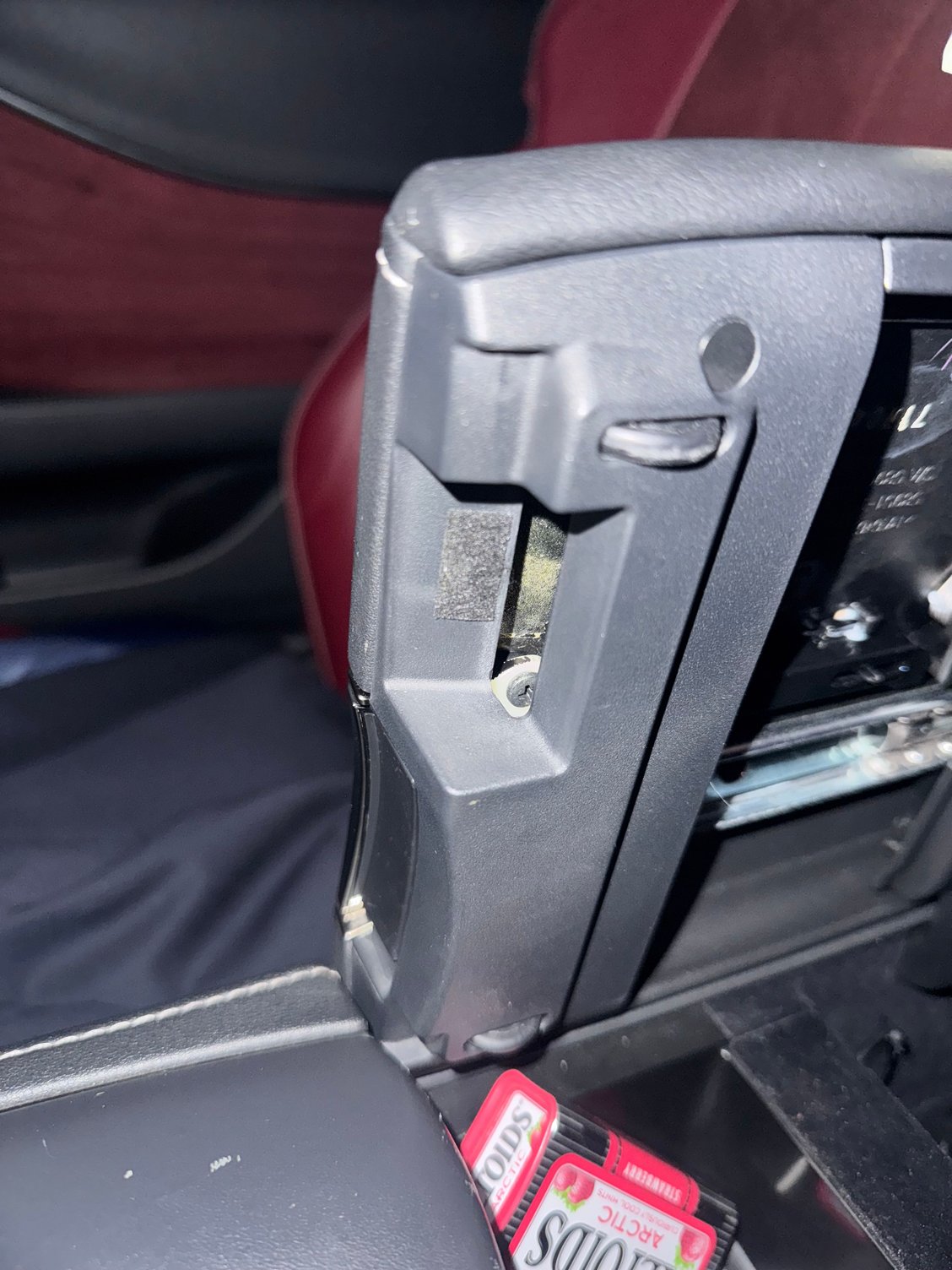

So the part I changed didn’t fix the issue. I’ve included what I think may be the culprit that are the hinges and would appreciate anyone that can take video and some pictures of theirs so I can see what an operating one looks like. Thanks in advance.

^^^^Might be easier to go to a dealer and check one out in the flesh

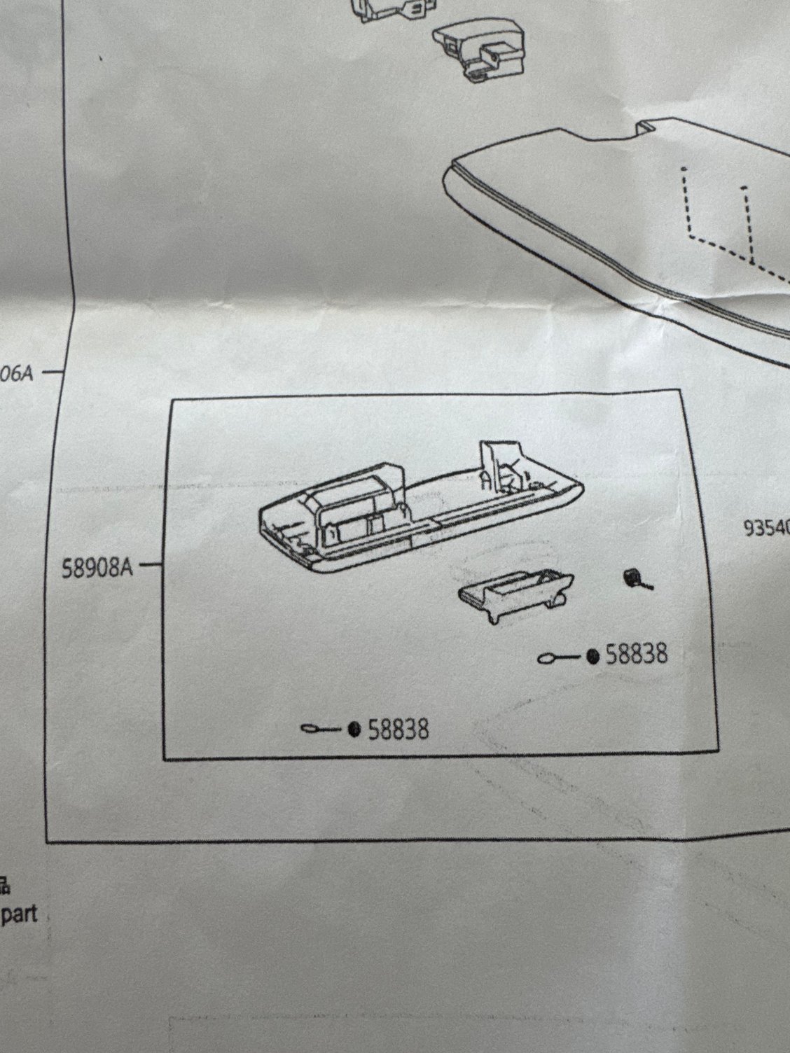

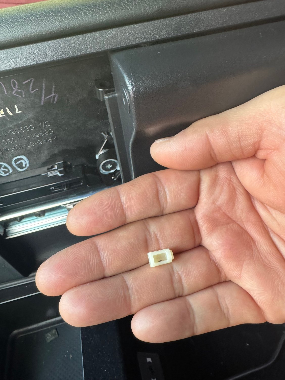

Old Jul 31, 2025 | 10:15 PM
Mikerx80's Avatar
Mikerx80
Joined: Apr 2012
Posts: 277
Likes: 47
From: Ca
So the lever piece I got ended up working. Shout out to
wholeSlab. He had reached out to me through CL and did FaceTime and walked me through what it should look like and it just needed to “hook.” Working perfectly now.
If your center console breaks get this piece from your dealer. I was seriously considering even Velcro at some point as changing the whole unit would have costed $3k.
