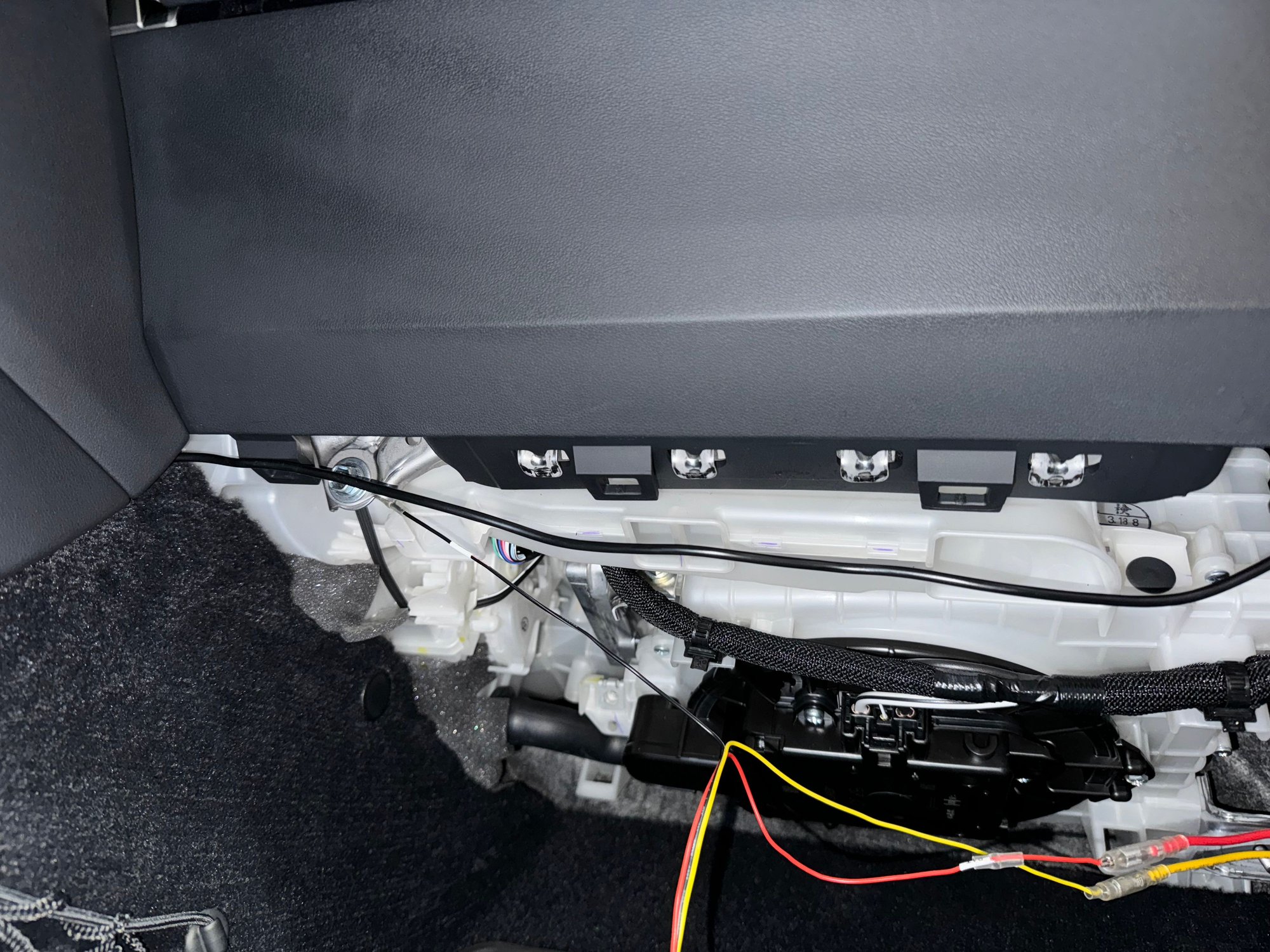

I was able to tuck the wire behind the A pillars down to the fuse panel and route to my glove box for now. I think I have a route to the back camera but I have to work on it.
At this point, I will order the hardwire kit from Rove and wire it to the fuse box under the glove box.

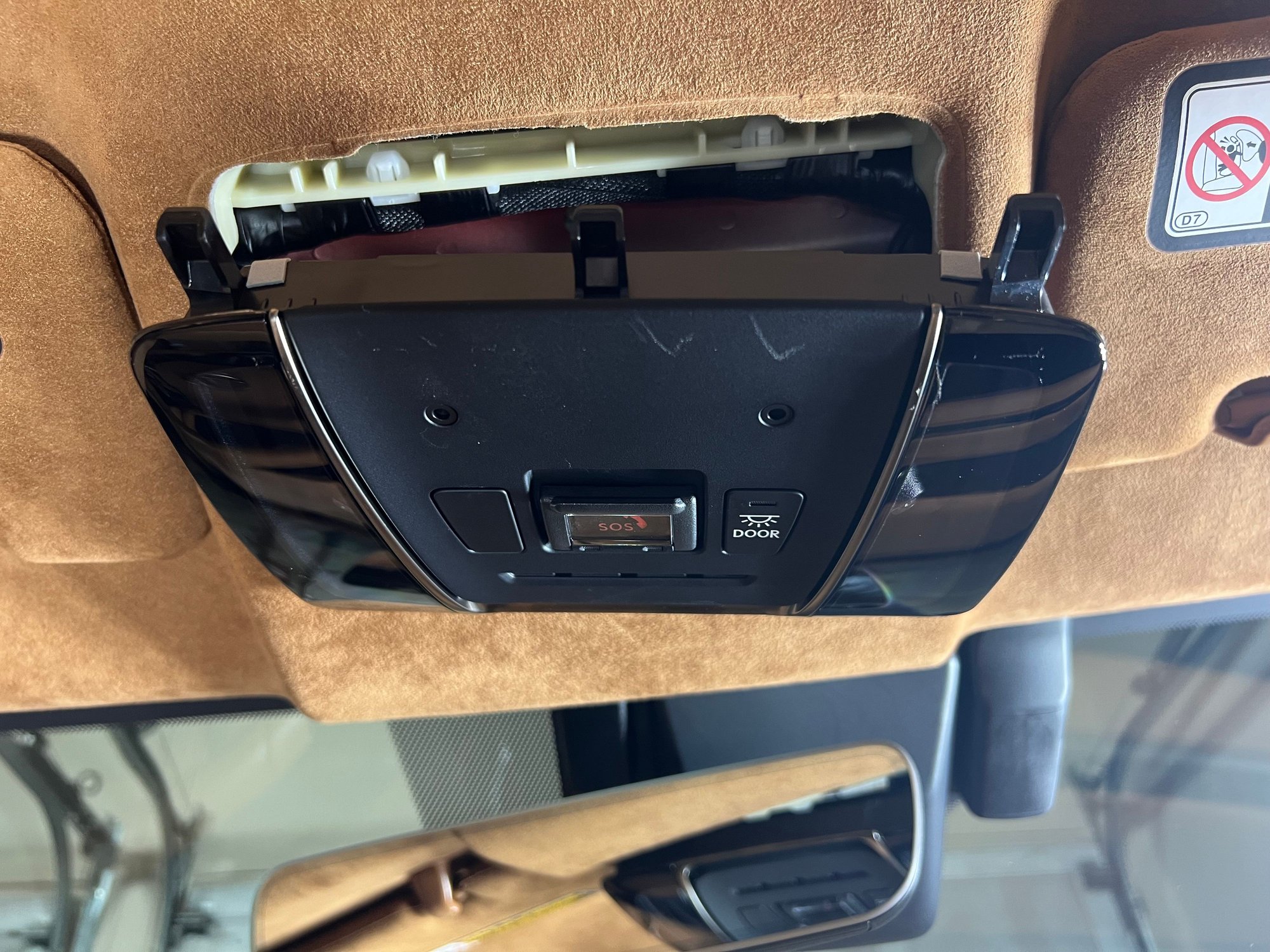

You can pull down the overhead console from the rearview mirror side.

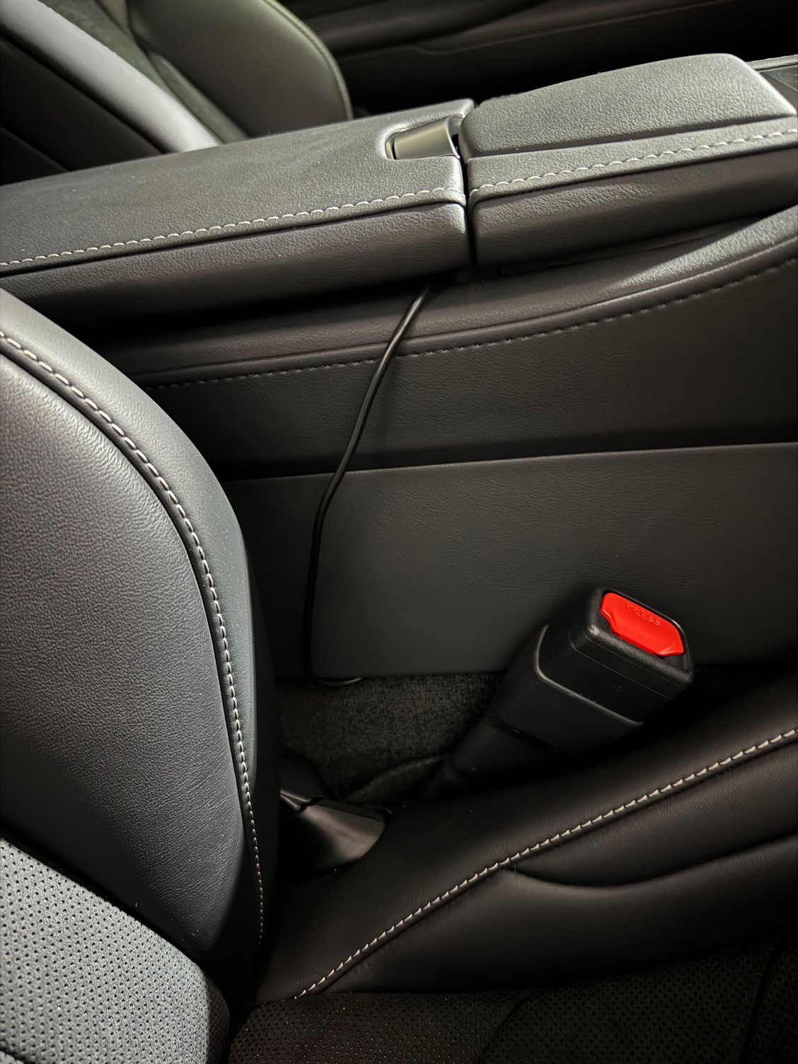

I routed the wire for the rear camera. There’s so much slack from the extra wire that I’m not sure where to tuck it. I will order shorter USB-C cable if I can’t tuck the extra wires. I’m just concerned the extra wire might affect the side curtain airbag from the A pillar. I pulled out the A pillar trim and I’m not sure how to put it back now.

Did you route the wire behind the a-pillar airbag? That's what I did. I had the same trouble with extra slack all at the back where the rear cam goes. I bundled it and zip tied and crammed it back into the headliner. Did you start at the rear and work forward or start at the front and work back?
Did you drop the entire a-pillar? It is annoying to seat it back properly. Start with the corner at the windshield and push down and in simultaneously. When it seats properly you'll know because everything will line up. Once lined up, then align the red push pin near the middle and snap that on, then finally the white retaining clip at the top.

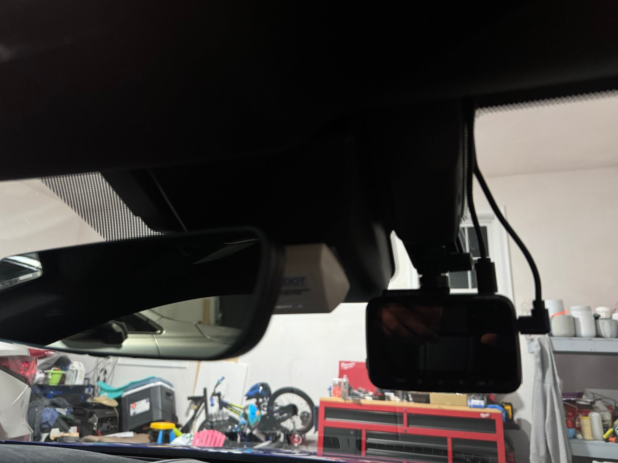

Alright. It’s done. I was able to tuck most of the excess wiring in the front headliner and the rest in the A pillar and put it back to original. The onky wire I got showing now is going into the glove box for the power source. Once I get the hardwire kit next week, it’ll be gone.
The tip on the white clip on the A pillar is key. Thanks @np20412
From the passenger side. From the driver side, the camera is barely visible.
I like how the rear camera is mounted flushed to the glass.

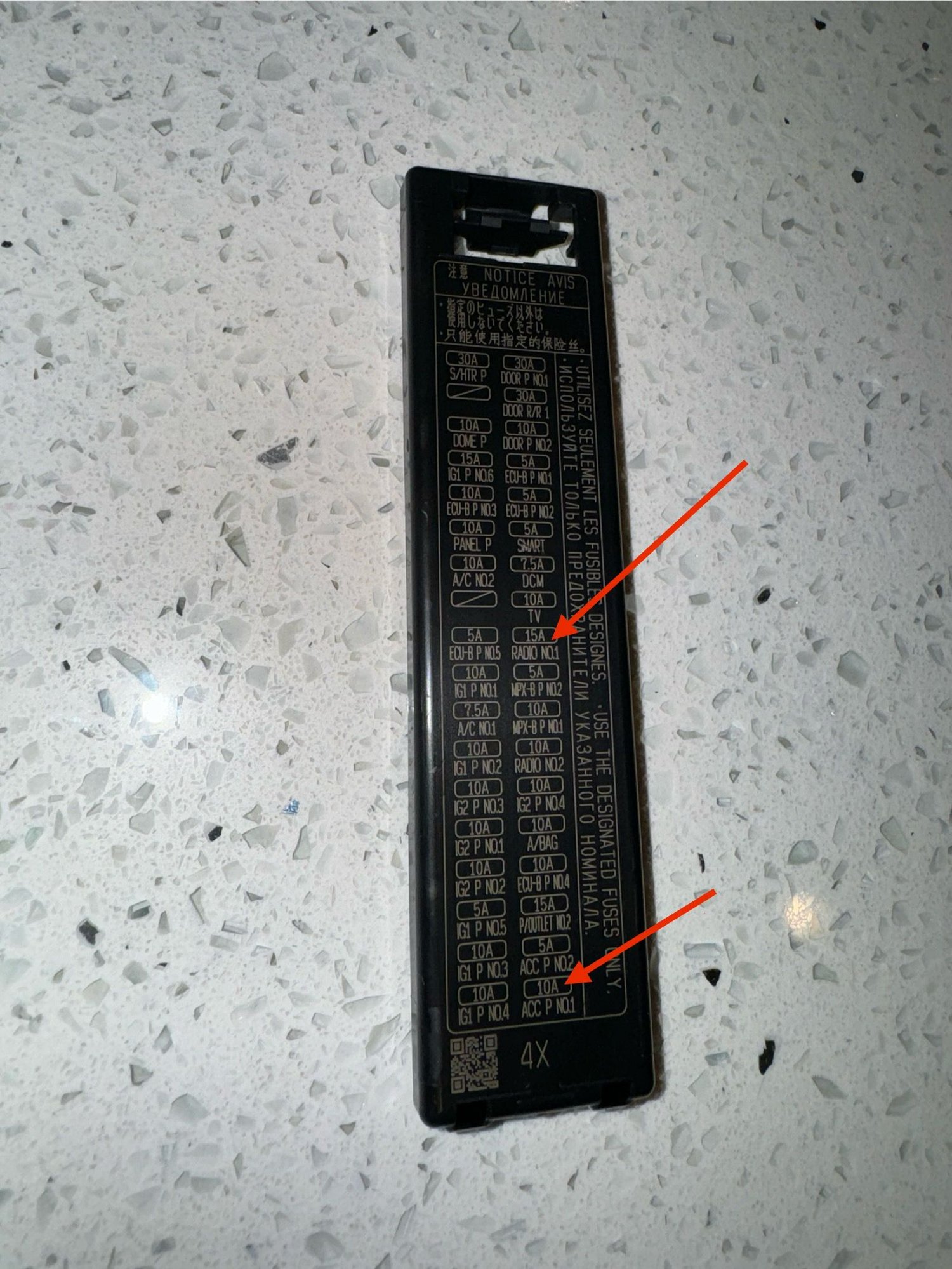

My dash cam install is now completed with hardwire kit and parking mode recording.
Here are the fuses I tapped. Again, this is using the fuse box on the passenger side under the glove box. Pictured above.
-Radio no.1. This is power straight from the battery and will provide power even when the car is turned off. Make sure you have some kind of voltage cut off to avoid completely draining the battery and leaving you stranded. I debated whether to use this but the Rove hardwire kit has a voltage cut off and I set it to 12.0V.
-Acc P. No.1. This is for power when the car is turned on.
