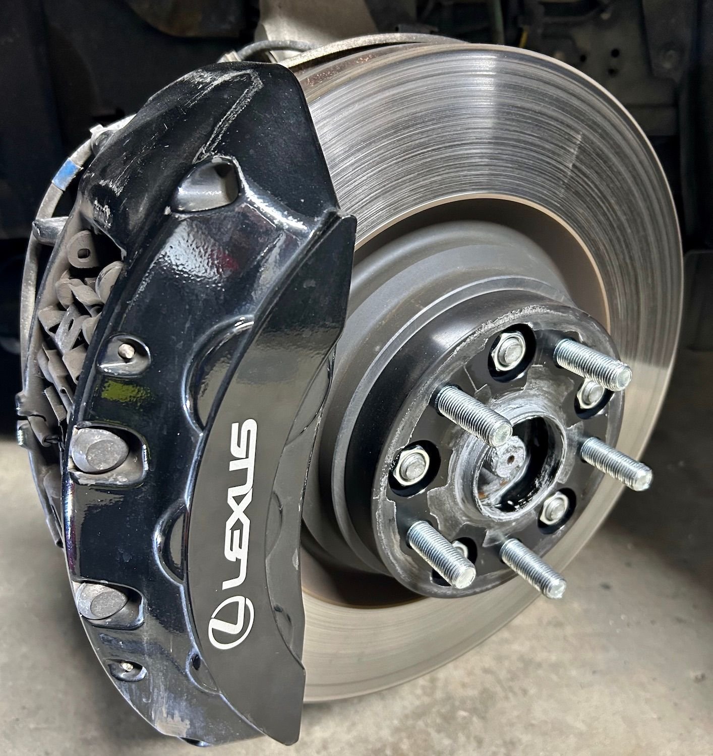

Im trying out some 20mm spacers. Installed the rears tonight and will get to the fronts this weekend.

This place is in Nevada, I've used their spacers on my LS460 for 4 yrs with no issues. You will need design 2 for your LC and they also have extended bolts that look like they are extra, it's best to call them if you have any questions.
motorsport-tech.com
motorsport-tech.com
Looks like you are showing Design 3 with the Studs, am I correct?
Why did you recommend Design 2 for the LC? I would assume all 4 designs should work, stud modification might be needed for some designs.
Design 2 is required for 2024+ LC because of the switch to lug bolts instead of studs+lugnut
I've just ordered from this company linked above, Motorsport-tech. I spoke to them and they said they have done spacers for 2024 LCs already, and they have the correct extended lug bolts for stock wheels (R14 ball seat M14x1.5). You need Design2 as noted above and will need 27mm+spacer width for your bolts. I went with 4 20mm spacers so 47mm lug bolts. $337 shipped for everything, $60.50/ea for the spacers ($52 if you don't get them in black, $77 if you want steel instead of aluminum), $3.50/ea for the black lug bolts, $25 shipping.
Will update when they come in and when I mount, they told me hopefully will be machined, anodized, and shipped out by the end of next week.
@Gerf many thanks for the recommendation on that company!!
