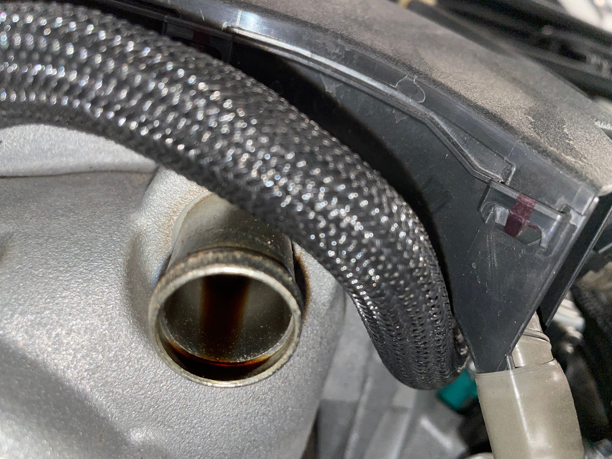

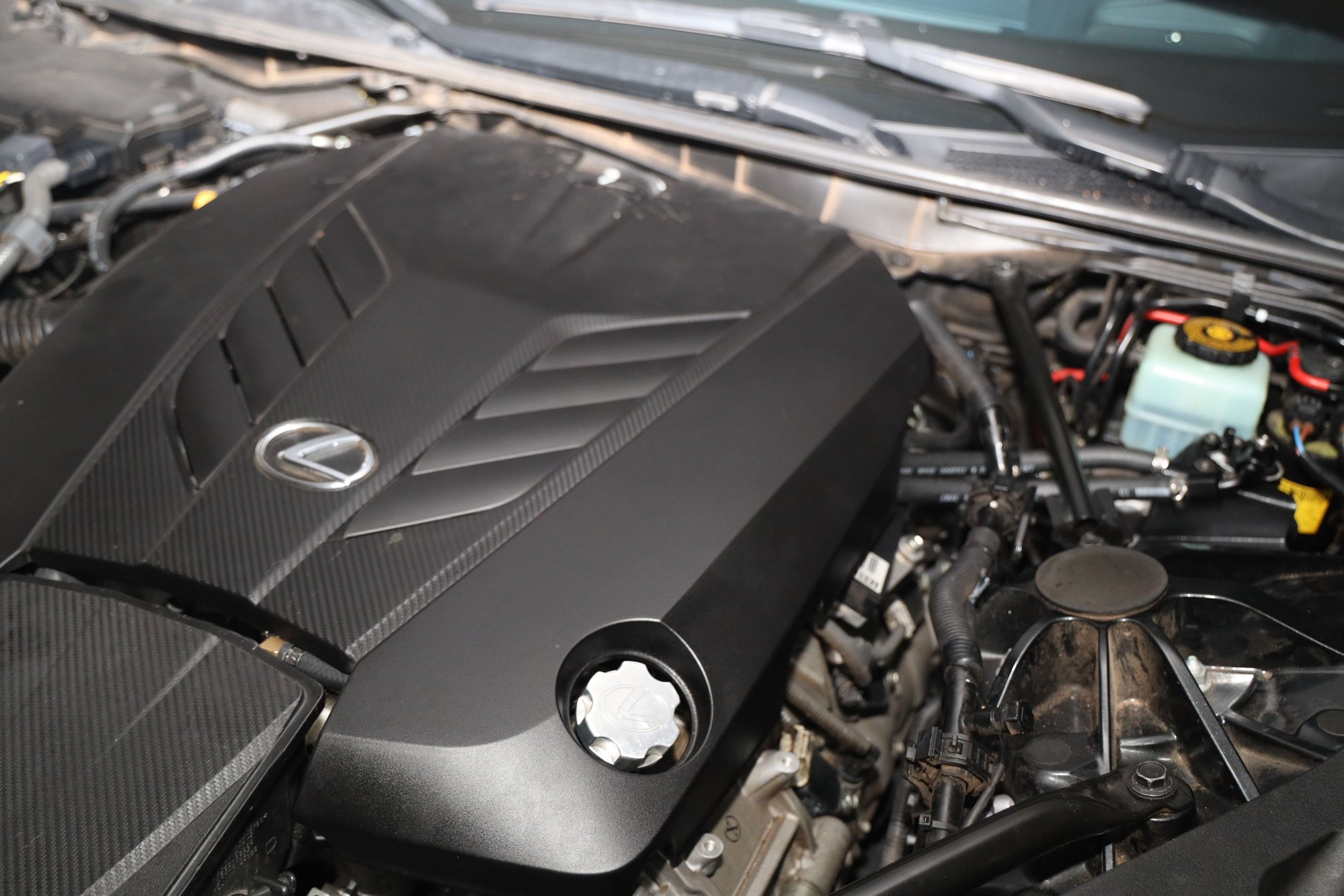

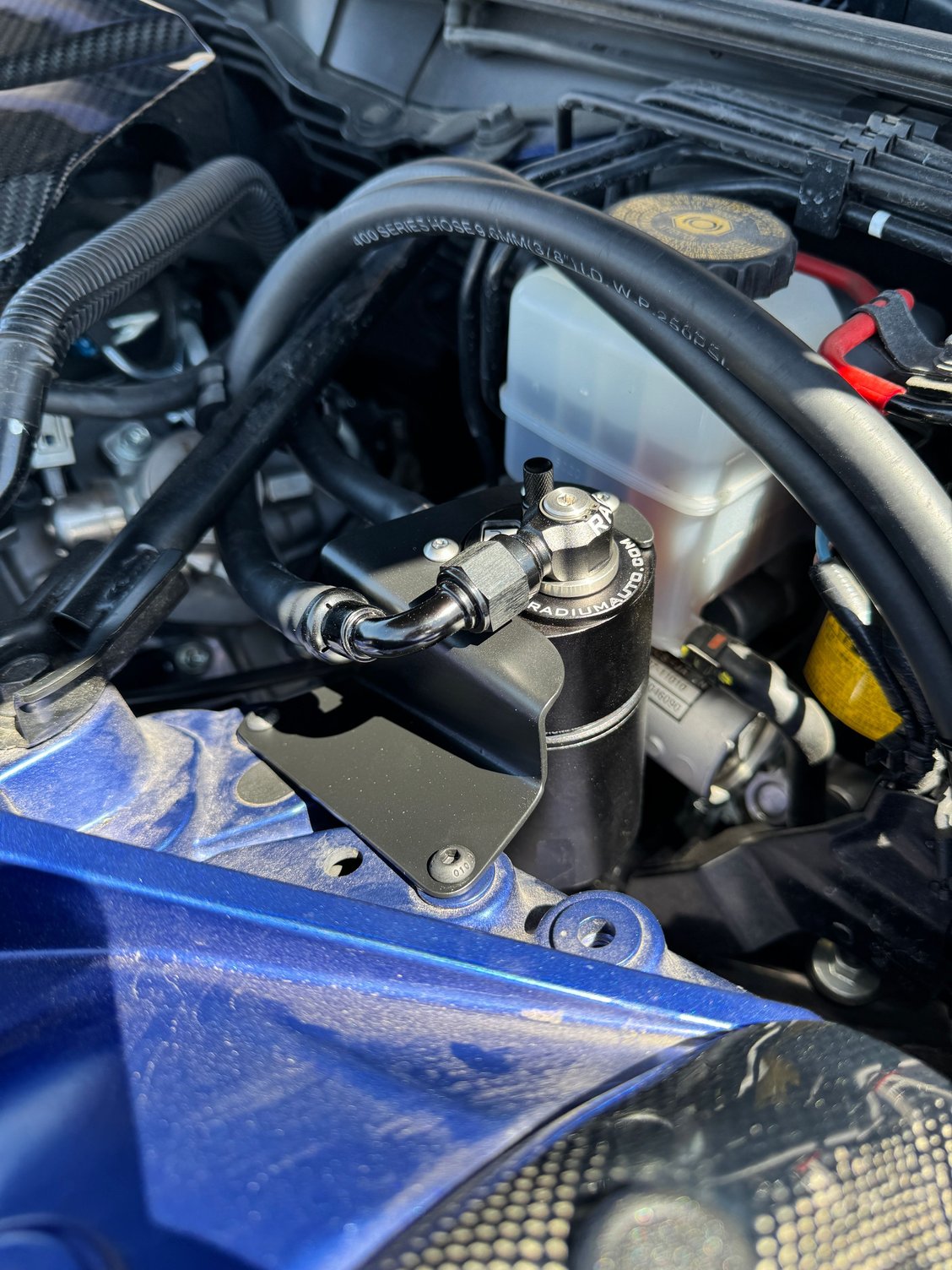

After pushing the car for 1000 miles I Went into dealership for low oil light and no leaks were found so they pulled the pcv hose off and saw oil sitting inside the entrance of the manifold. Decided to go and try and fit the Figs Engineering catch can kit for the RCF/GSF, on the LC. As expected, the mounting brackets didn't work so I had a shop in town (Crown Concepts in Tucson Arizona) fabricate and powder coat a custom bracket to fit in the engine bay on the drivers side. Besides the mounting bracket, I bought an extra pcv hose just in case i needed some extra length to the hoses. Happy with the turnout and fits with the engine cover still!

Id be surprised if Crown refused to sell the bracket to others. They are a really cool show that likes doing fab work so id give them a call and ask. It was a little over 300 dollars for them to design, draw, cut it out, and powder coat the bracket. Id assume it would be less for others since some of those steps wouldn't be necessary. I havent heard of the Figs cans having any problems. I’ll report back after many miles of hard canyon driving and update the thread. I have run my finger inside the catch can and it comes out wet and has a weird smell of oil (no puddle of oil yet though). So I assume its working correctly.

Very weird your quote to be higher. Looking forward to seeing your set up. My catch can did actually start to collect oil too. Have oil all around the bottom corner of my can now so its definitely working. Very happy with it

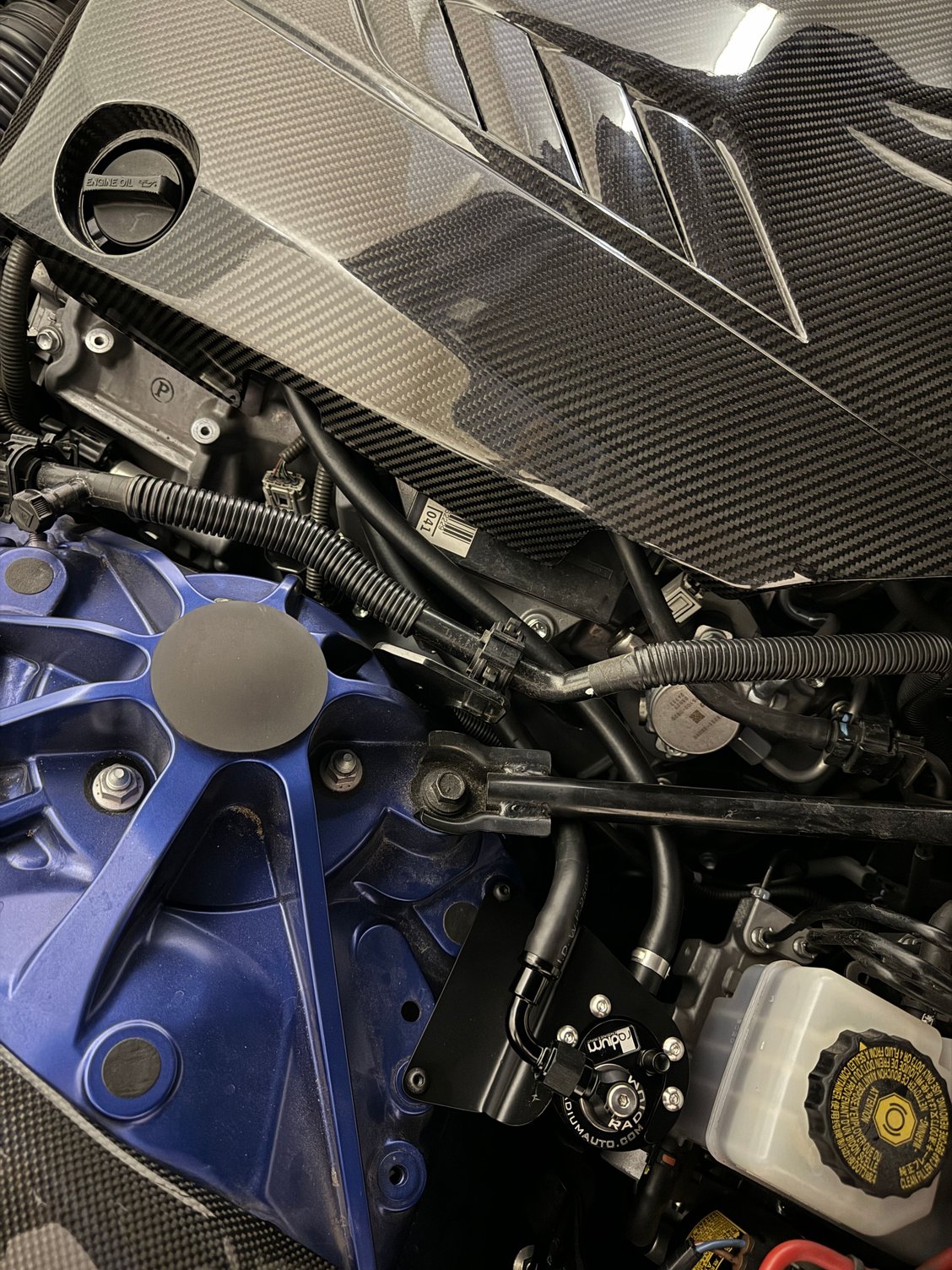

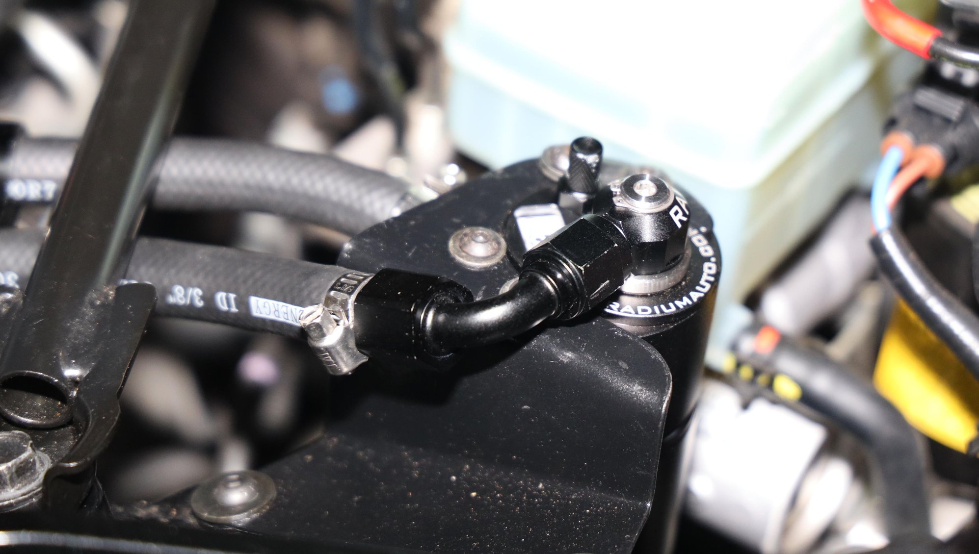

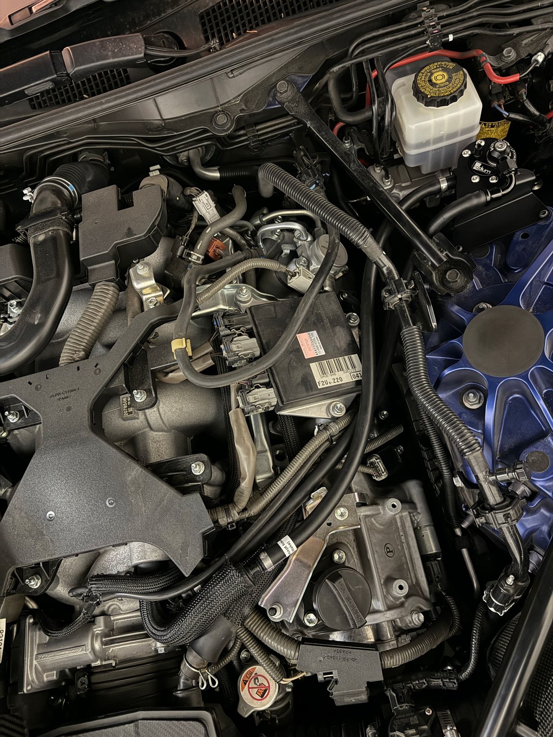

I know there's not much interest in this mod, but I finally completed the installation‼️ It was more of a chore than I expected. I ordered many wrong parts that I had to return. Attaching the hoses to the odd size of the Lexus interface turned out to be a problem. One of the parts I needed (2 pcs) was only available from China and took three weeks to arrive. One big surprise was the increase in my KCLV. In the first twenty miles of driving, my KCLV increased by 2 points This was unexpected
Oh and a nice surprise from Crown Concepts - They only charged me $278.80 for the bracket
Lou

Looks awesome dude! Very cool to see its caused your kclv to raise! Thanks for sharing the progress
