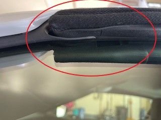

Thanks. So I understand, the procedure would be while setting up the appointment for maintenance, tell them to contact the District Service Rep about this issue prior to arrival? I only ask since I've forwarded the photos to the Dealership the second day of ownership and they didn't seem concerned (said it didn't leak while they had it).
Any idea what the actual adjustment/fix is in case?

So dropped into the Dealership for them to review the right side gap and seals. Initially the Service Manager said they haven't seen/heard of this before but if needed they would get the Rep involved. Told them I'd wait in case before leaving it. In back one of the Technicians said they new exactly what the problem/fix was since it was previously discussed during a roundtable meeting. Not sure what they did, but the light hole on the right side when viewing from inside out is gone. The seals also appear to match around the windows side to side now at the tops edge when the windows are closed. Took them about 1.5hrs.
The Top was not adjusted, still about .100 difference left to right on the pinch/mating surface. I was told there is no adjustment for the tops seal pinch (which still appears cockeyed when looking at it).
Right side light hole gone.
Left side seal window closed.
Right side seal window closed.
Left side seal window open.
Right side seal window open.
