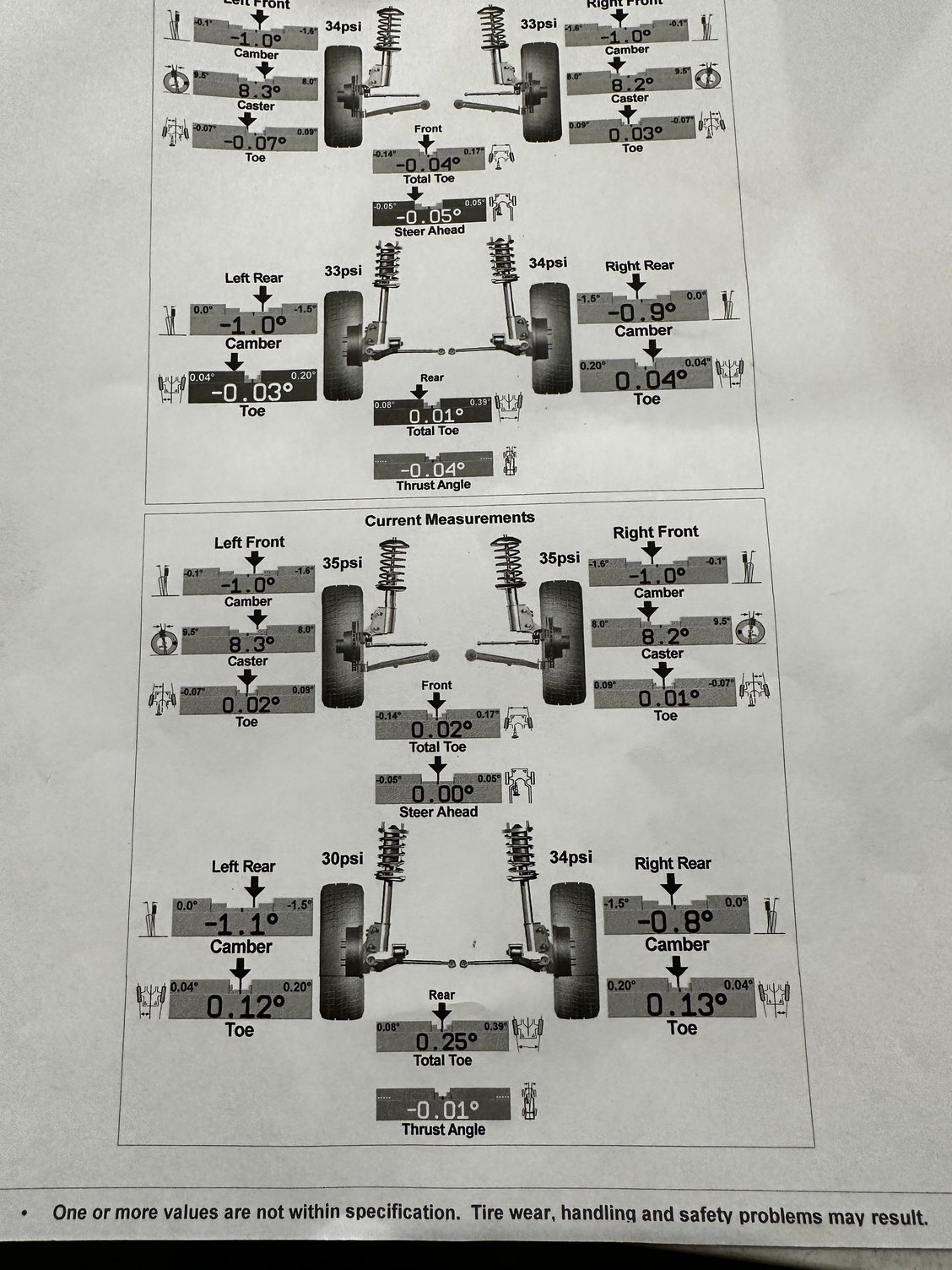

Having an issue with my steering wheel, when the car is driving straight the wheel seems to be crooked at first it was towards the left, now it towards the right. I've gotten multiple alignments from lexus and other shops. Nothing seems to be out of the ordinary with the alignment. I am running hks coilovers, with spc adjustable ball joints in the front, and spc rear adjustable arms in the rear. Not sure what the issue is. Attached is the latest alignment sheet from lexus

How are the suspension bushings on your car?
For example, the front lower control arms have two bushings each, forward and aft.
Consider the age of the oldest ISF, most of these cars have worn out rubber bushings.
Even if you get a perfect alignment on paper, the dynamic alignment once your car is driving on the road will be much different because your tires are fighting eachother while the bushings deflect.

I have the USRS from rr racing installed as well.
