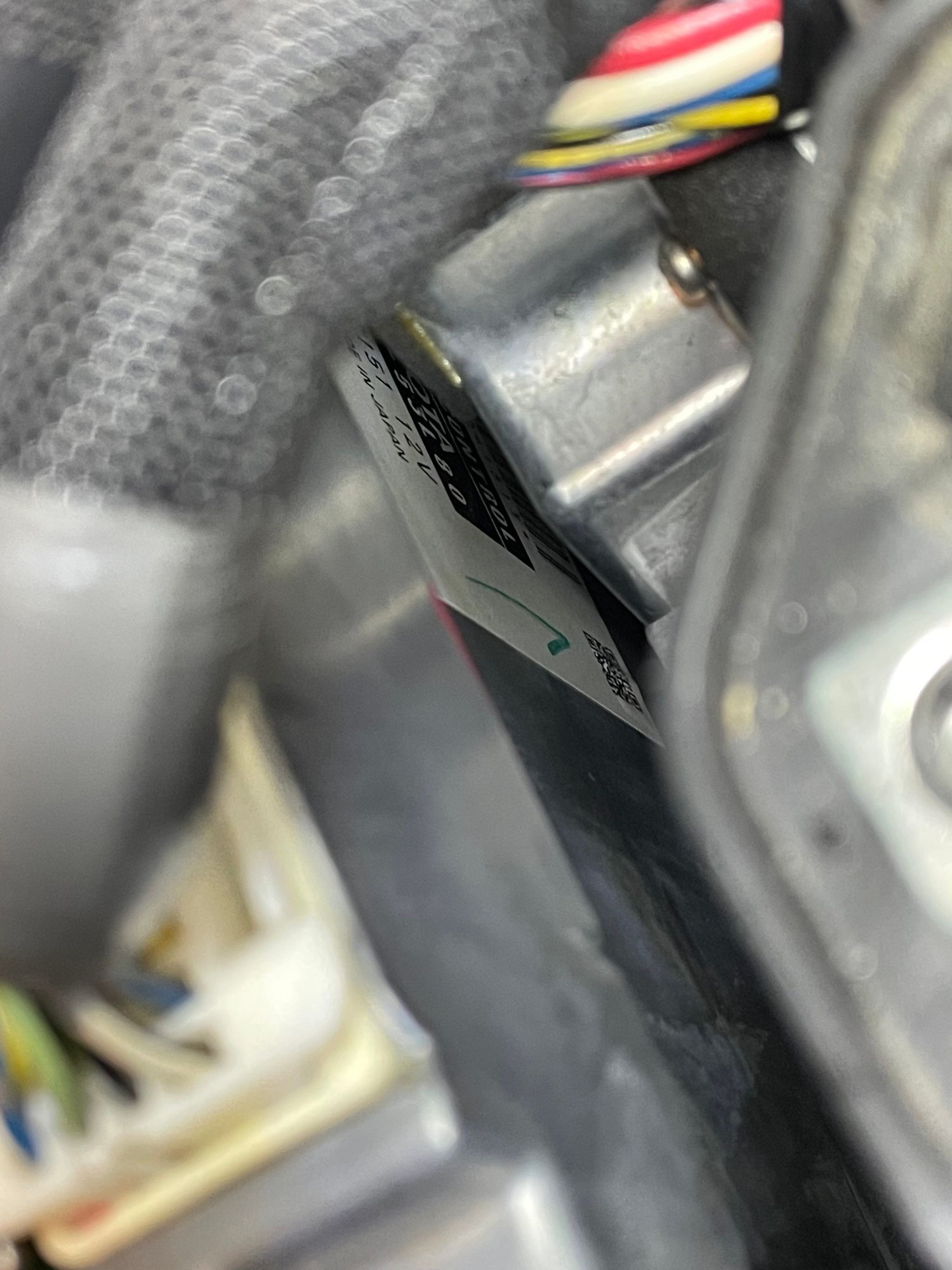

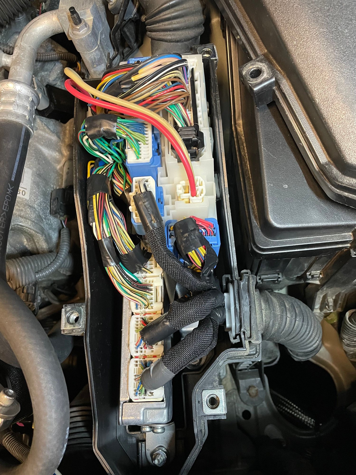

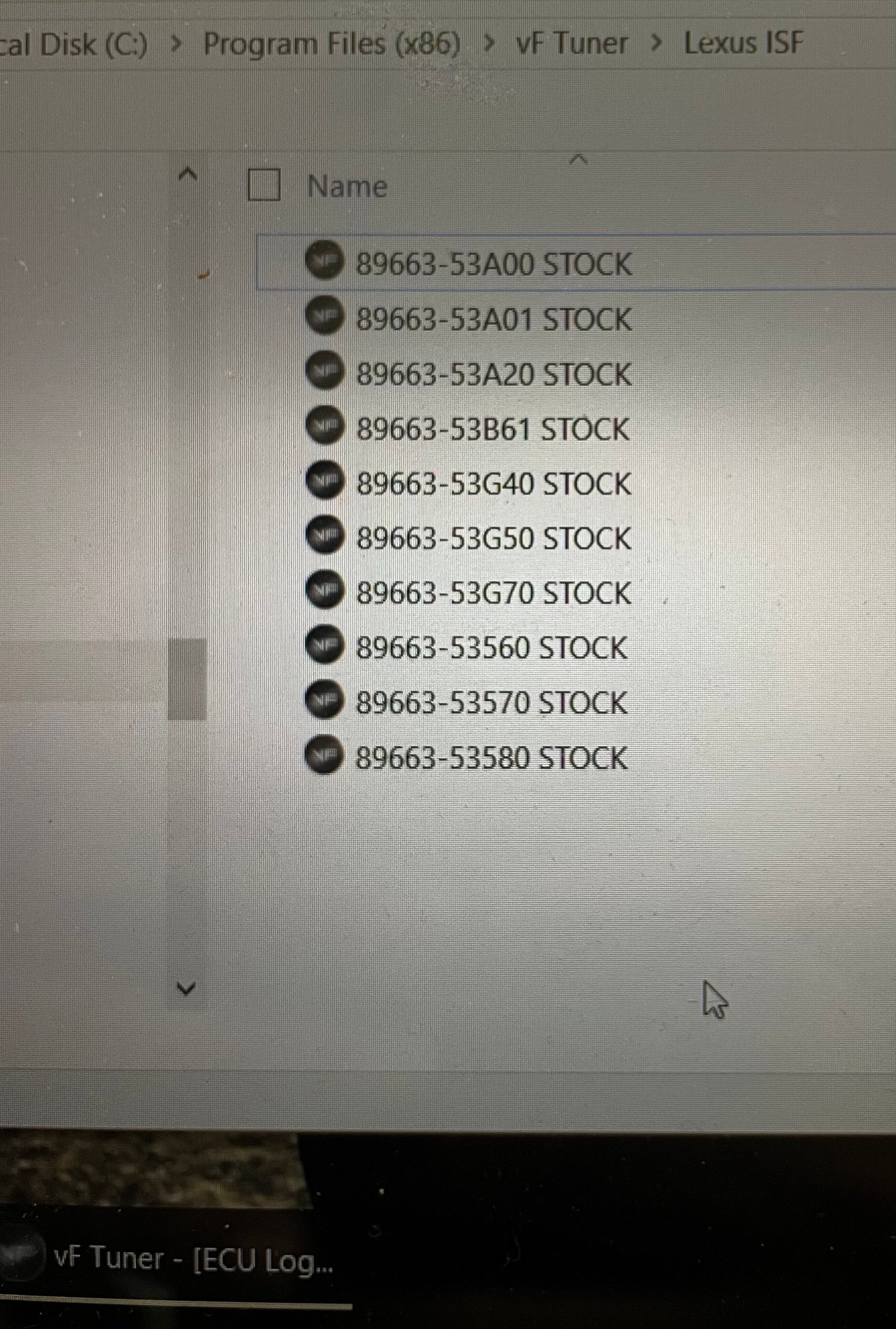

Positron's Avatar
Positron
Joined: Aug 2011
Posts: 123
Likes: 231
Originally Posted by Defratos
I need to know what my ECU number is for Loi to see if he can tune my GCC spec ISF.
I am guessing it is similar number a long the lines of 89661-XXXXX.
Finding the ECU part number is easy. You can see the number through the opening as pictured.
A google search after that should tell you the ecu ID number.
