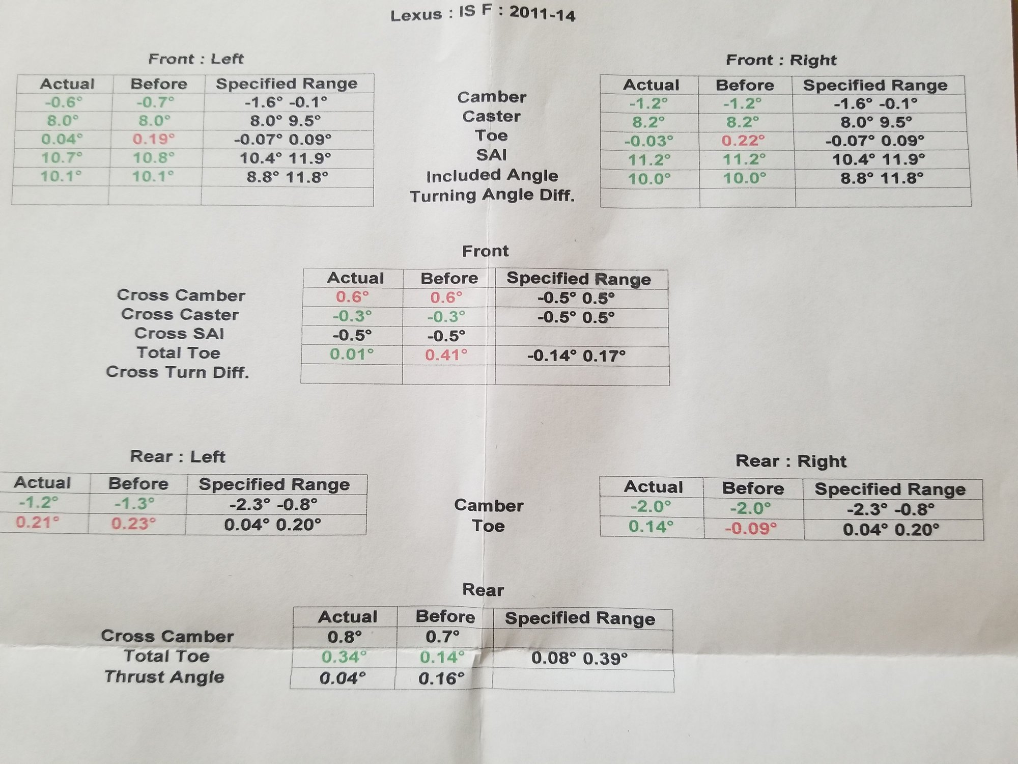

Aligned after new tire install. Kept pulling right, back on the rack for adjustments, still pulled. Checked with me in the car. Still didn't feel right, he was thinking radial pull could be the only thing left and swapped sides. He did suggest upgrading the control arm bushings for better tire wear etc which has been well talked about here. Above is the print out. I am currently all stock suspension. Any thoughts would be appreciated! Want to get the most out of the tread as we all know tires aren't cheap. Thanks again!

Front and rear Toe are not in check,
-Front try to be around 0.00-0.02 out
-Rear 0.10-0.12 in
even both sides

Front toe is bizarre. The numbers should either be both positive or both negative. Never one pointing out and one pointing in which is what you have on your sheet, and it doesn't surprise me at all it wants to go right with the left wheel toed in 1mm and the right wheel toed out almost 1mm. Positive angles are toed in, negative angles are toed out. Unless you really know what you are doing, toe should be between 0.00 and 0.04 degrees on both sides.
Left/right front camber is jacked because the subframe isn't properly centered, and caster is also off because the subframe isn't centered.
Rear toe is also bad and should be symmetrical, as mentioned above, Should be +010 - +0.12 degrees. Thrust angle should be as near zero as possible, and even though it's better, it's still not very good.
