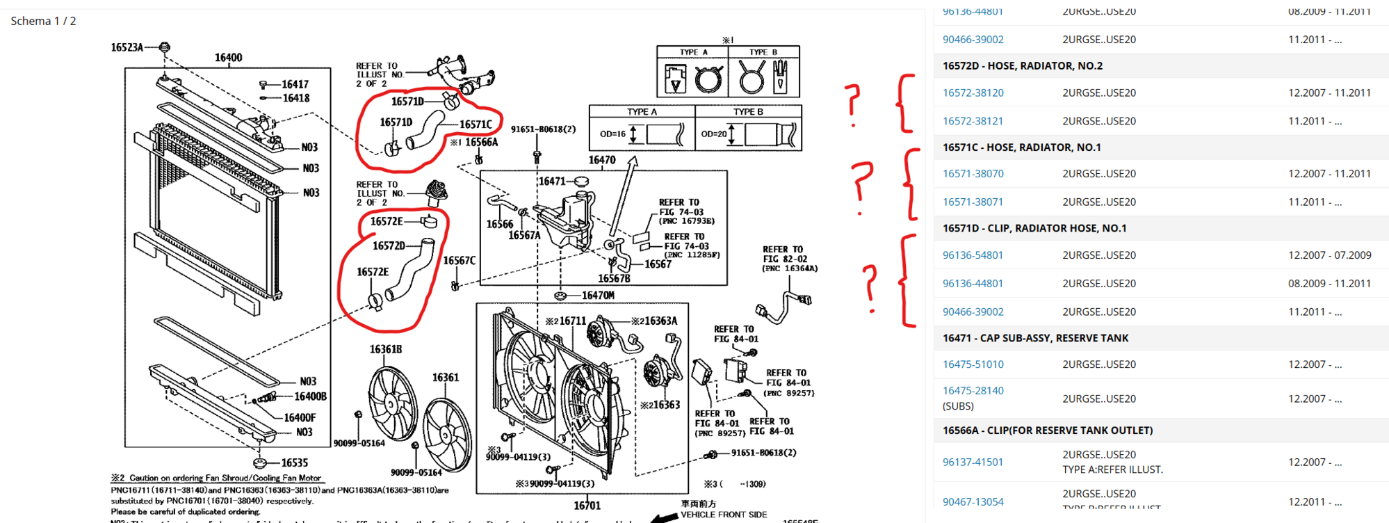

I noticed my 2008 IS-F with 114,600 miles had a worm clamp securing the hose from the reservoir tank to the radiator. I ordered what I thought was the correct clip (96137-41701) and a new hose (16567-38030) to get rid of that clamp. The new hose would not fit over the radiator outlet. Here is the hose that was installed and the new hose:
This lead me to this thread and the differences in the radiators. My ELE-INSP FAN/REPL SCREWS service was done at the dealer on 4/9/2015 at 55,808 miles. It does not mention anything about a new radiator. It appears I have the new style radiator which was likely replaced during the ELE campaign? While attempting to swap hoses I did notice my radiator is leaking at the seal:
I decided to go ahead and order the 16400-38H10 part number which should come with the hose and clamp I need. Ignore the temporary clamp on there, its the only one I had laying around that would fit. Total from Bell Lexus was $331.97 with free shipping.
My question to you guys, should I just put the hose (16567-38031) and correct clamp (96136-42101) in and wait a while until I want to do a transmission filter service? Will this radiator pop any day while driving? Thanks in advance!
Replace that radiator as soon as you can. Once it starts leaking at the tank seals, it's just a matter of time before it blows coolant all over the engine bay. So yes, it will pop any day while driving.

Does anyone know if it matters which radiator hoses and clamps go with the 16400-38H10 radiator?
