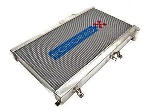

Why not get an aluminum koyo and run an external trans cooler? No risk of fluids mixing in the future

Koyo makes the radiator. Part number is HH012170
​​then for the trans cooler you can go with a Hayden 679 or 678

Replacing the oem radiator with the koyo won’t affect your warranty. Not only is it all aluminum but it’s also thicker and holds more coolant. On my personal car I added the koyo radiator, trans cooler and oil cooler. Never had any issues with over heating or concerns of coolant and trans fluid mixing since all three are separate.
