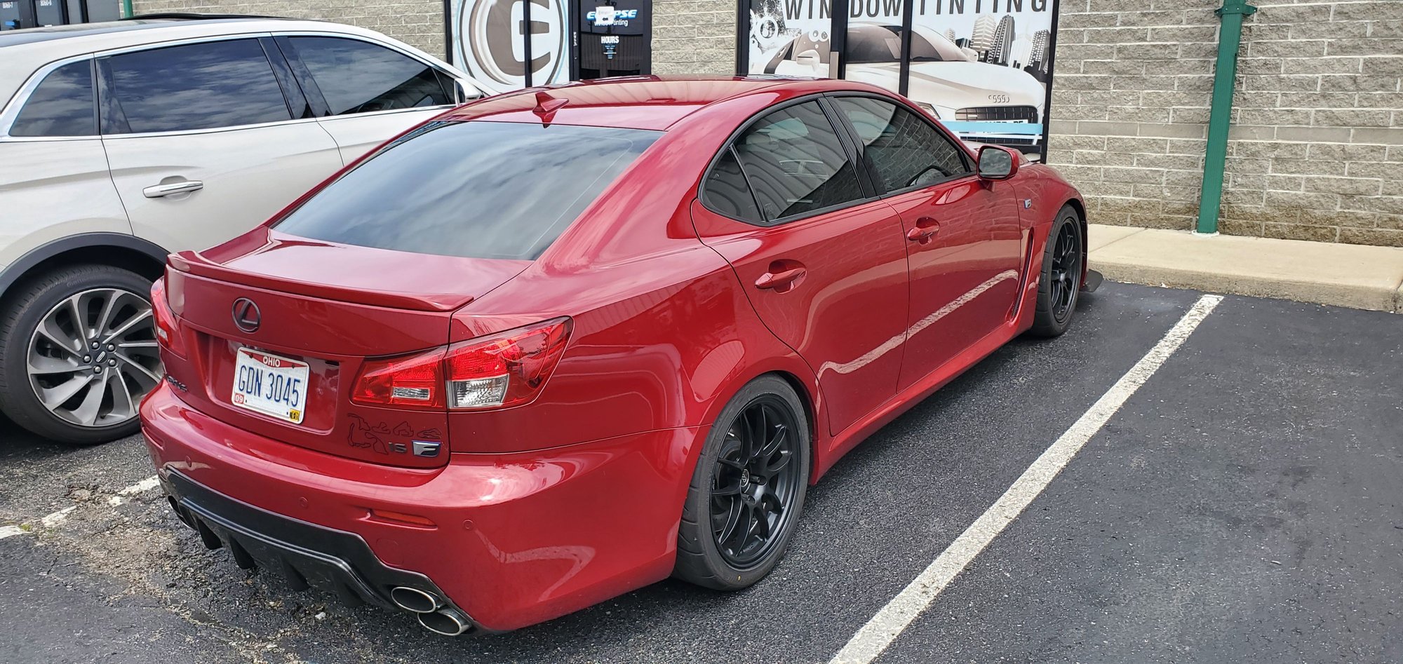

My car came with a Toms Kit, and I’m removing it. I have no knowledge as to how the diffuser is held on. Any tips for removal without damaging it?

As far as I’m aware it’s double sided tape so use some heat when removing it. Take your time.

Double sided tape, maybe some tapping screws and/or clips on the underside. Plastic trim tools with heat is your friend. Or goo-gone as an alternative to heat.

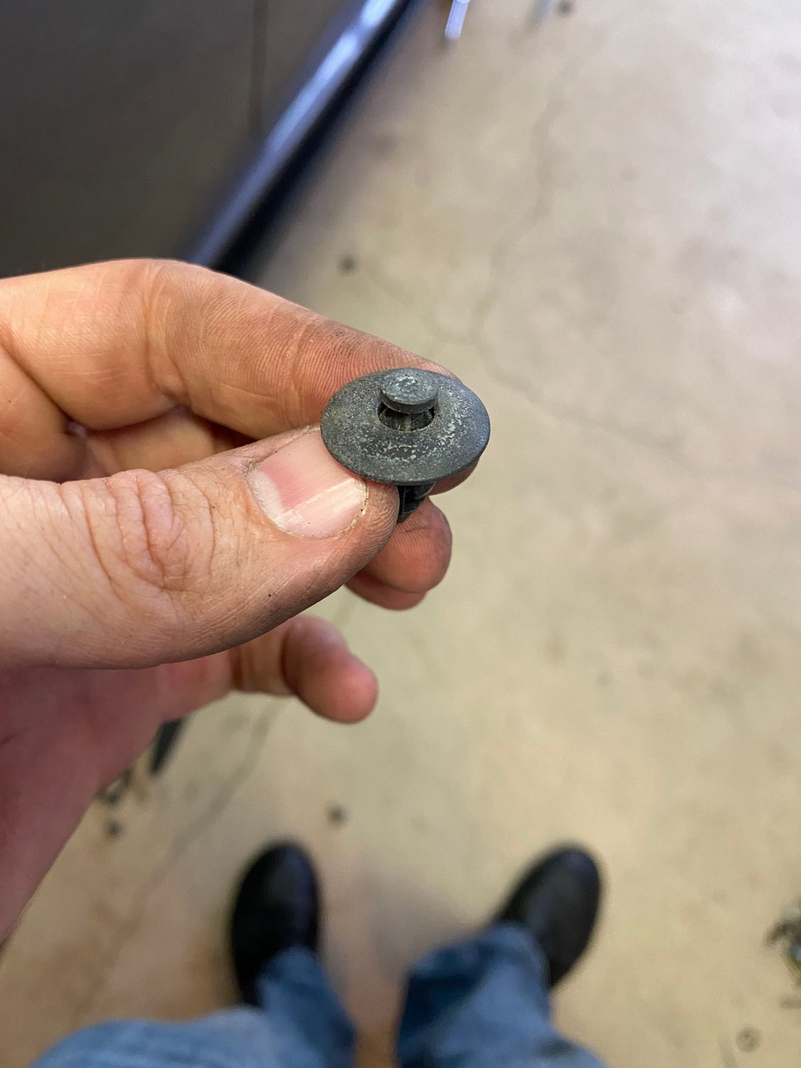

Is there a special tool for removing these, or do you just push them inward in the center and then pull them out? Some of them don’t want to push inward in the center.

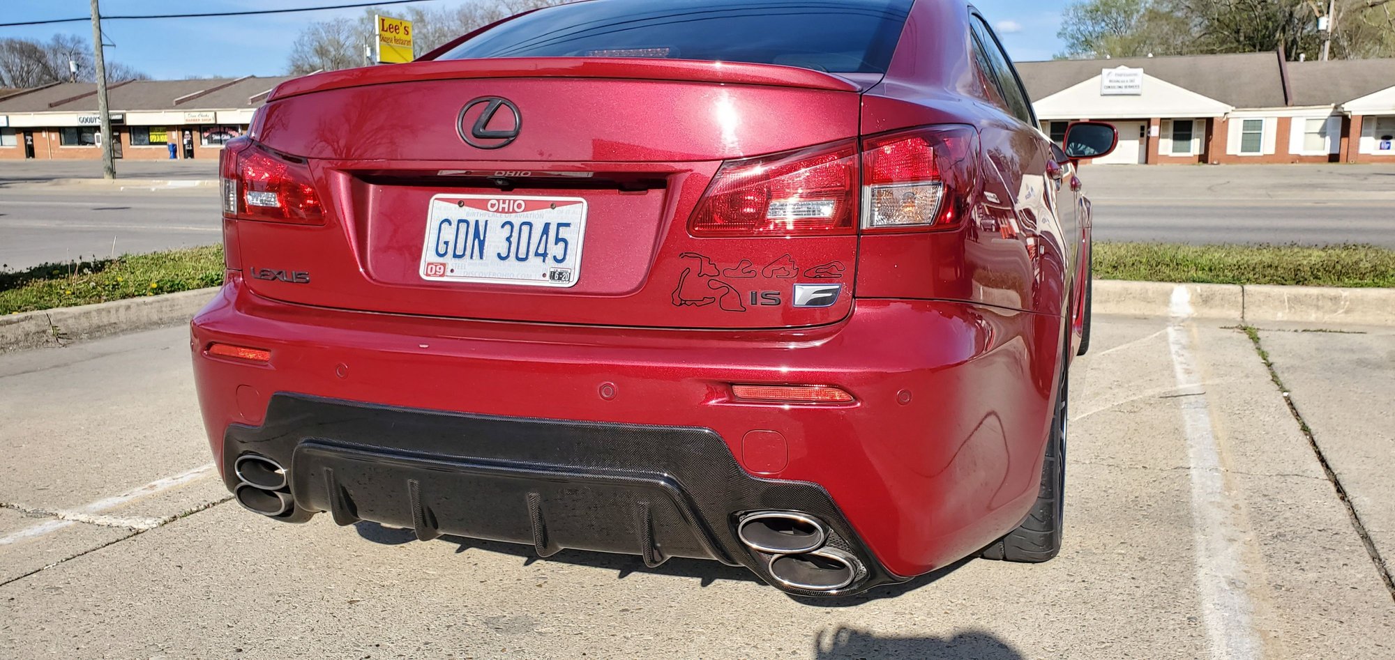

Looks like they used gasket maker to hold the diffuser on. I guess that’s one way of doing it.

They're supposed to push in to release, but they don't always work nicely. That's why I bought a bag of 100 of them. I toss them if I don't like their behavior. That and they break if you look at them cross eyed.

I broke roughly 50% of them. Do you know the name so I can buy a similar bag? Thanks!
