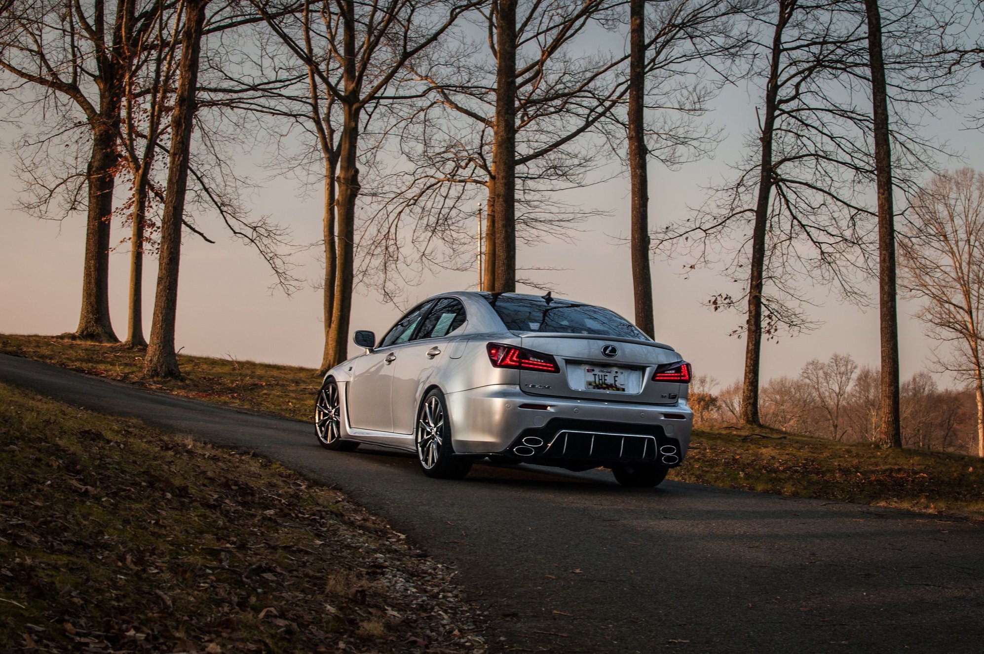

Spacers I have run H&R bolt on ones on the 08 wheels, but didn't push the car and as my 08 wheels had all seasons so it wasn't worth it to push the car anyways. I ran 15mm front and 20mm rear, but my rear was already rolled from a summer wheel setup so 15mm rear may be better. I was also on stock tire sizes which I believe were 225 and 255. I was also lowered on coilovers, though not slammed. Compared to some F's my rear was even higher than stock ISF rear height. Spacers will run you ~$200. Here are photos from my 2008 ISF:

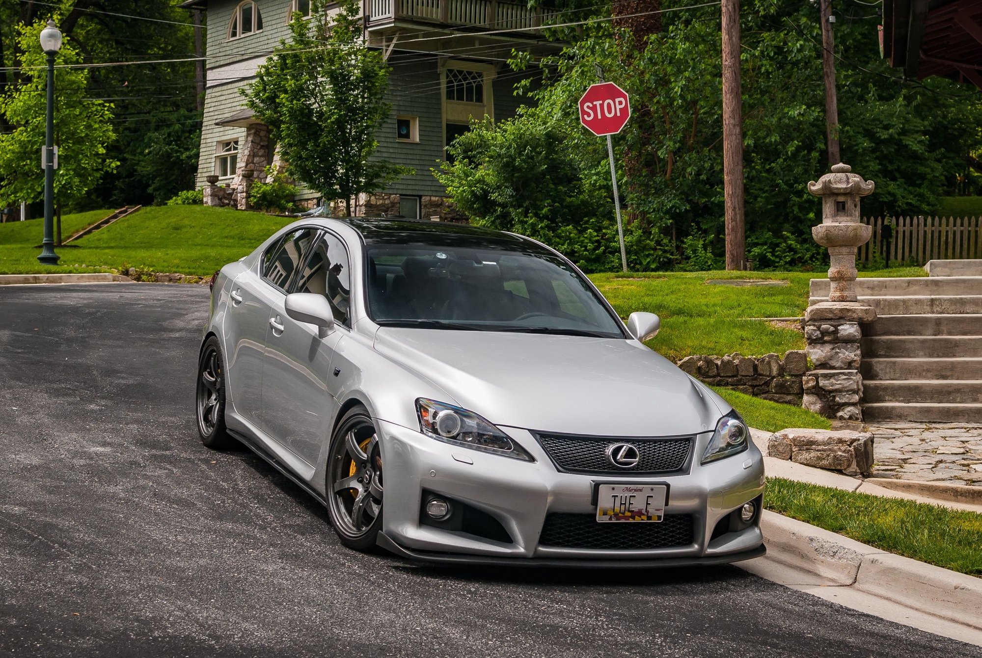

However, I recommend simply going to aftermarket wheels. There are plenty on the market that you can find that will look better or similar to OEM wheels, yet weigh less than even the OEM BBS forged wheels. After 3 different setups I have settled on 19x9.5+45 square with 255/35 and 285/30 for a good setup. My 2012 F doesn't have anything rolled and doesn't have rubbing, even lowered on coils. As a nice plus, the 19x9.5+45 Rays Gramlight 57CR I have weigh 22 lbs, while the narrower 08 wheels weigh 23 and 27lbs, though the extra rubber decreases the weight savings though adds grip. They were under $2k shipped, and were a more pricey rarer color as well, I think regular black or gun blue is like $1700 shipped. You can save even more weight and money as well as adding comfort by going to an 18" setup. Aftermarket wheels you can always sell for at least 70% of what you paid(in my experience), so it's not that much money lost. Here are photos of my white 12 and my silver 08(same wheels and coilovers).

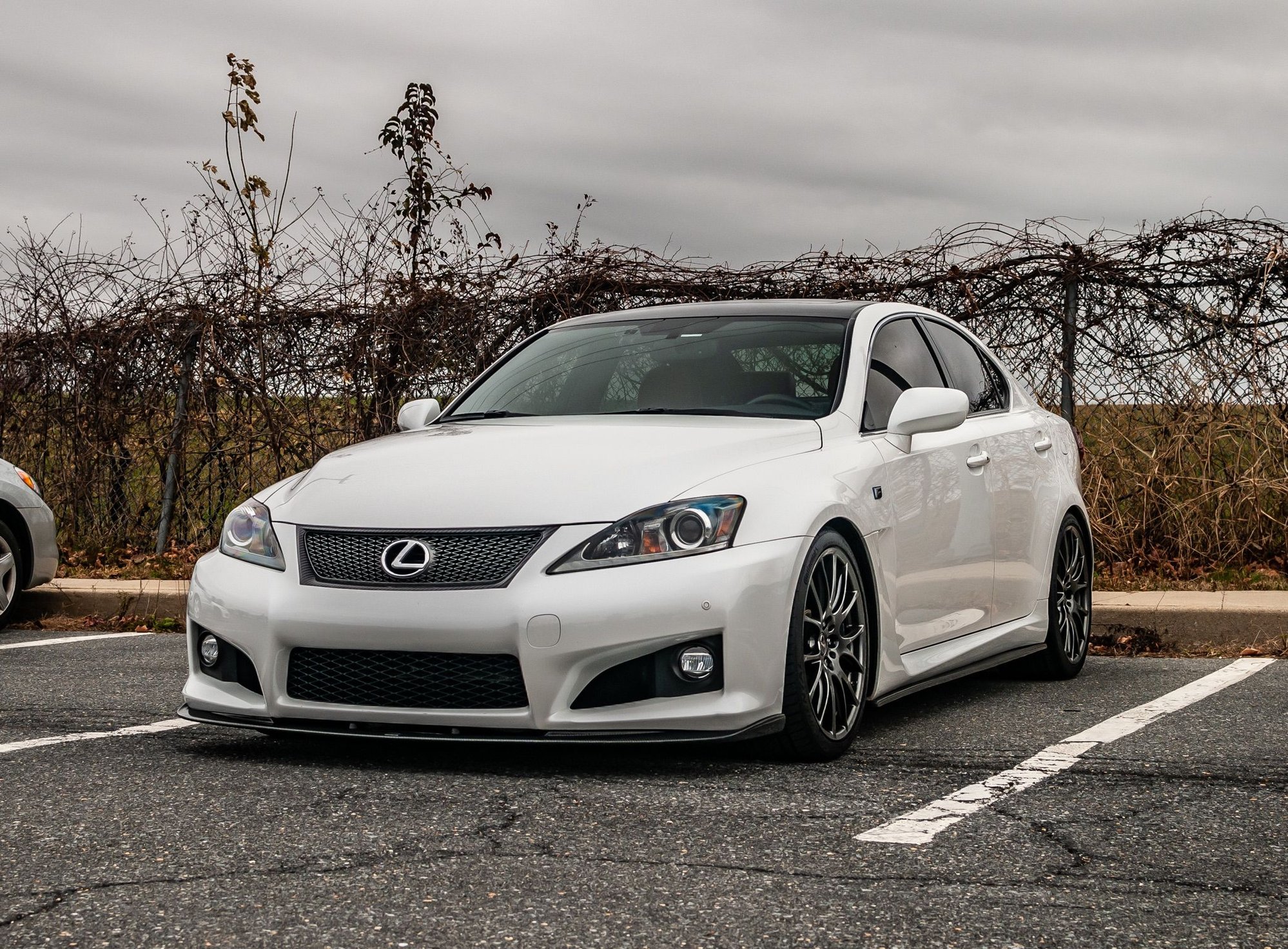

My new F is a 12 so I have the nicer 12 wheels for my winter wheels. I did not add spacers, and the 12 wheels come a little bit wider and have a bit of a nicer offset as well, so they look nice lowered but not as flush as my aftermarkets. This 12-14 wheel style is rare and I've seen them for $1800-2500 for sale. Obviously there are 10-11 style as well as RCF/GSF style wheels also, but you'd have to read up on proper specs and tires to run to avoid any issues. Here is my 12 lowered with no spacers:
