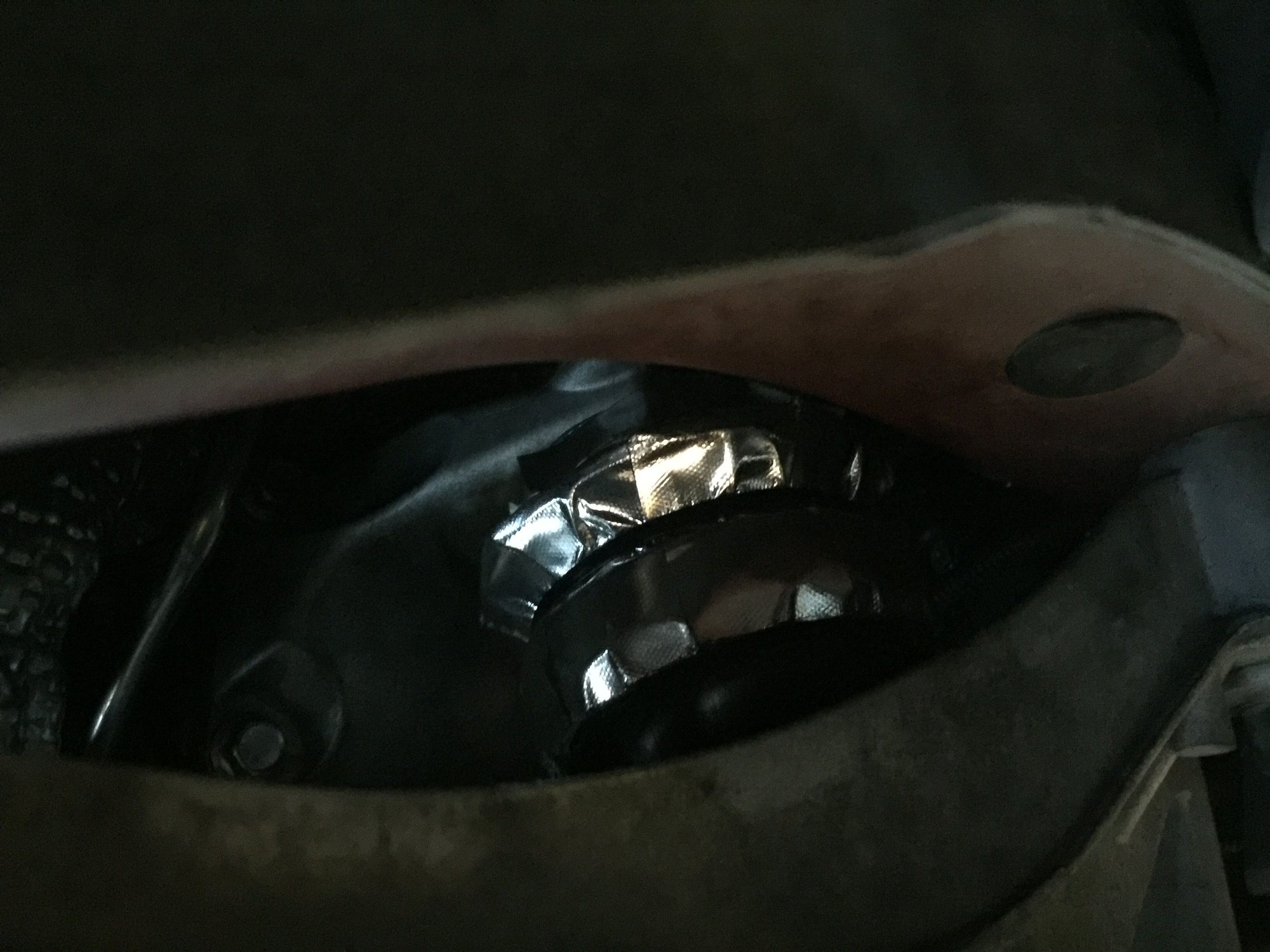

Before anyone rushes to any judgment I have not contacted Figs about this yet, I just got the chance to look at it after work today. Their customer service has always been great for me. This is simply my firsthand experience with this product that I installed myself.
Yesterday while driving I noticed a very noticeable noise/vibration on sharp left turns coming from the engine bay area. Inspecting the engine bay I noticed the header runner was extremely close to the frame rail, I stuck my phone down into the engine bay and saw this:
At this point I thought maybe the nut backed off from vibration but when I got a wrench on it was still tight. I dropped the front pan and this is what I found on the drivers side:
I've had some people on facebook say heat shielding could have helped prevent this.
I saw your post on FB, but couldn’t find it now. Which group did you post this?
I wrapped mine in some heat shield material before installing them on my isf. I’ve had a set on the RCF for 3 or 4 years now and also wrapped in the same material, but it’s only driven about 3K miles a year.

Lexus IS F Owners. Nice job on that wrap! I was not aware of that recommendation when I installed mine. Also, did you paint yours? the bottoms of mine were not black.
ok thanks, found it. I painted mine with High temp POR 15.

I wanted to give an update.
After speaking with Mike, we think that since I daily drive my car with EL headers in the Texas heat the mounts may have failed due to thermal shock. He is going to warranty my mounts and I will give them another try with heat shielding. Thanks again to Mike for taking care of me

Had mine finally installed this weekend. Thanks to Ron @JT2MA71 to suggest heat wrap. I will report back after I put some miles on them and let everything break in. Felt good on the way back from the shop. Very mild vibration at the idle otherwise pretty much very close to stock.
