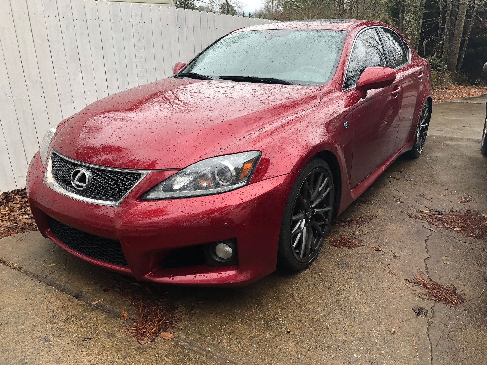

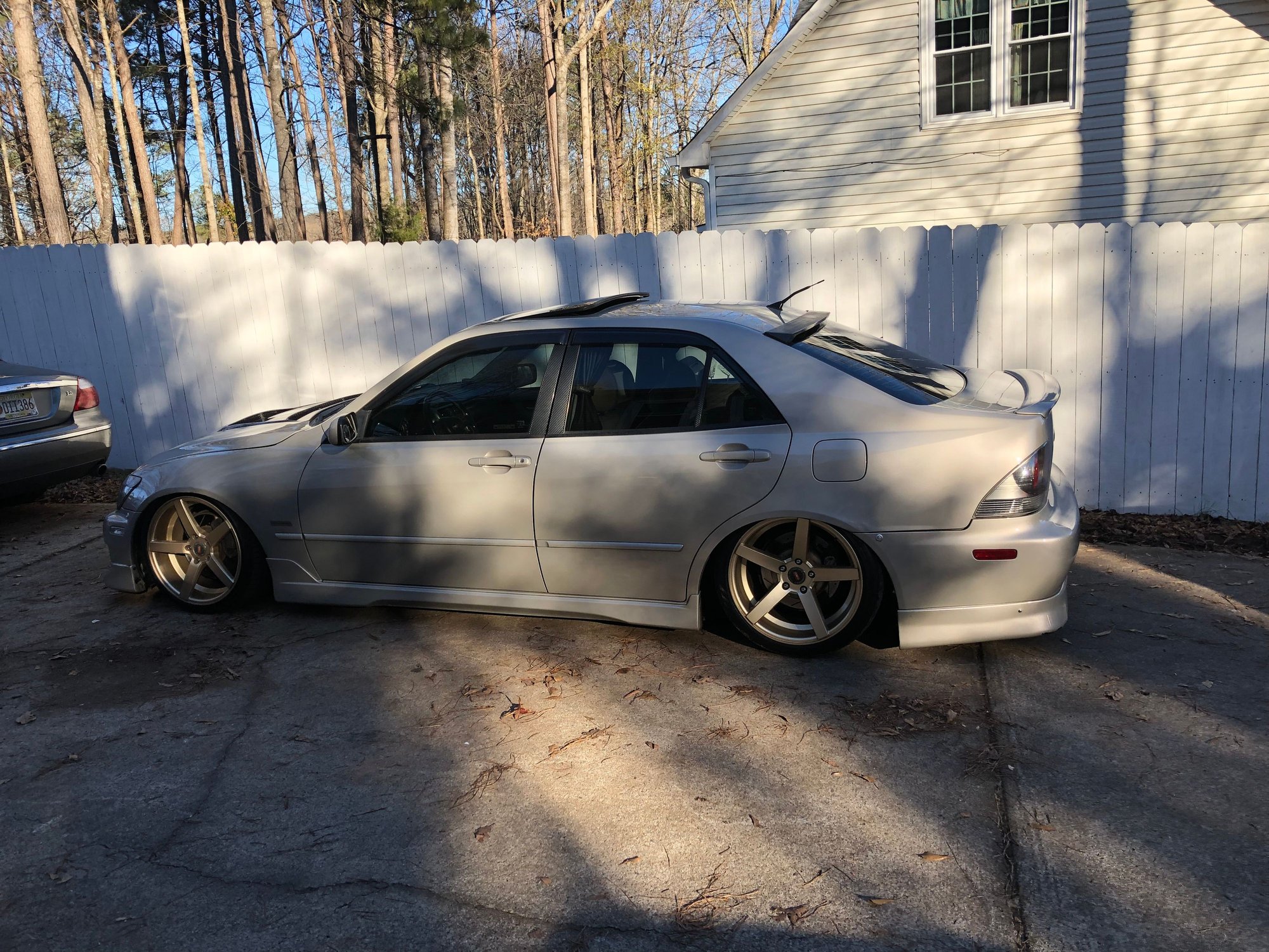

So I’ve searched around on the forums to find something related to what I need and while I did find some pretty good threads about wheel fitment. I have a specific situation I need help with. I have a bagged ISF (yes I know). I don’t like super flush fitment when aired out and what not. That’s not why I have air. I have air because I like sitting a little lower than stock but still being able to clear the ridiculous roads in Atlanta (I had problems with drivability at stock height.) my question is does anyone have any wheel specs for tucking? I have a 2011 isf which is the year before they bumped up the wheel size. So my frame of reference is poor because I have the smallest 19” wheels Lexus made. Does anyone have any insight. I don’t want to rub excessively while going down the road. But I don’t want super wonky stock fitment when I air out.
I know 99% of people here think stance isn’t the best option when you have an F but this is what I want. Thank you in advance for any help. Attached is my f (not aired out) and my girlfriends is300 which is aired out and tucks. I’d really like to just a TAD more conservative than my girls car.

19x9.5 +38 255 (No Roll)
​​​​​With 275 ( need roll fenders)

Onefastf is that square?
Yes Squared
