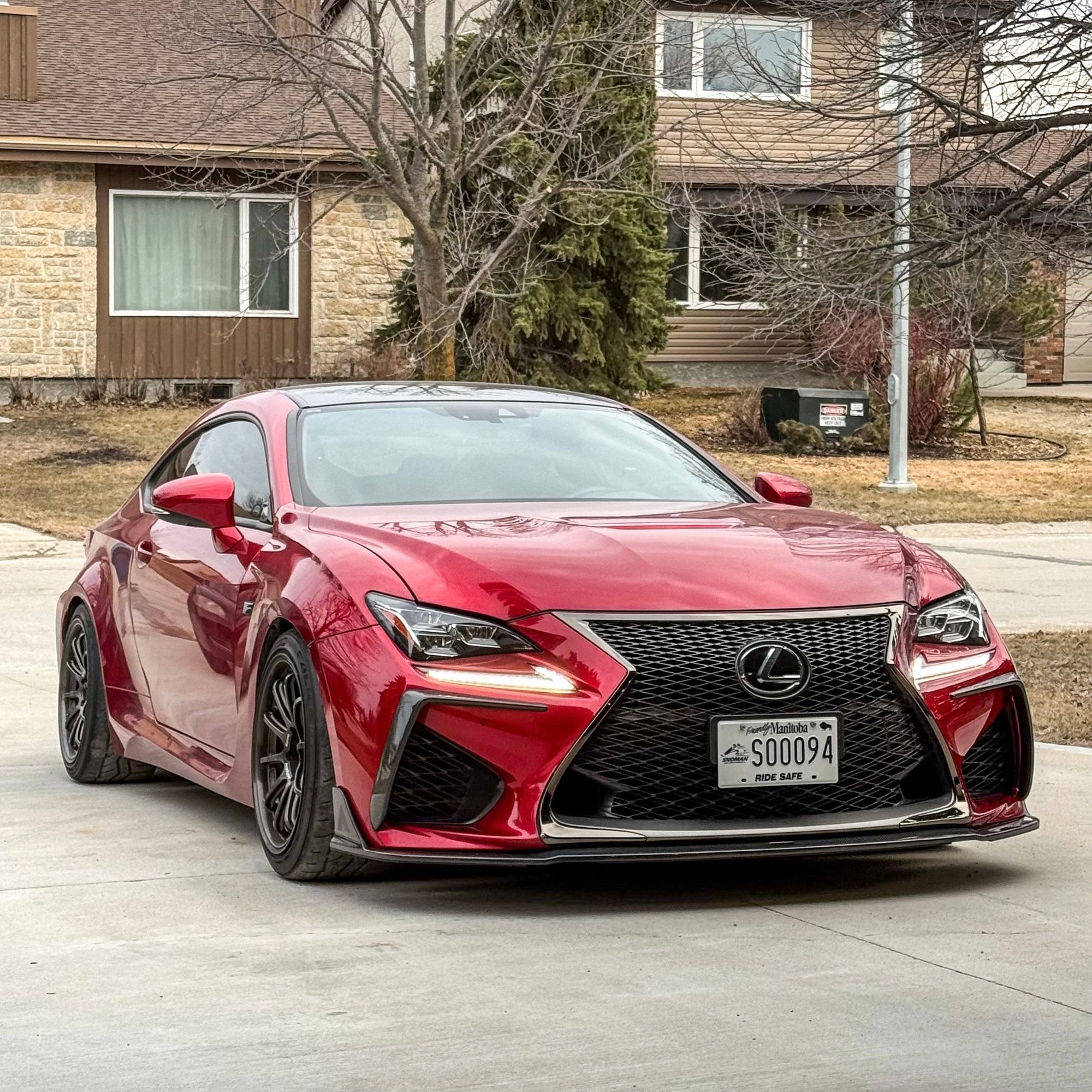

Bonus pic of the car (although not an IS F) because I’m relieved and I hope this helps out others when the same issue occurs.
