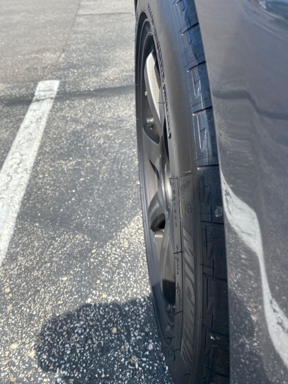

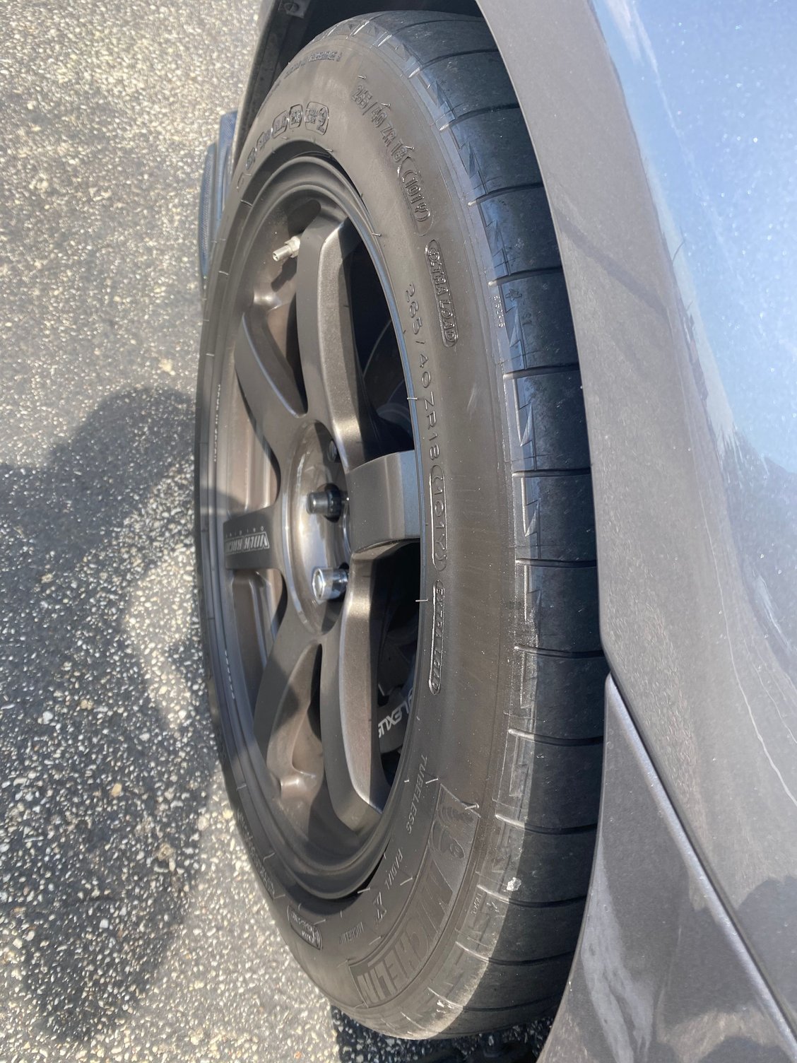

265/40 on a 9.5 et 45 wheel. Don’t mind the OEM brake dust. Plenty of tire for a 9.5.

Thanks for pictures. That's type side wall I'm looking for👍. Is it me or just angle of pics there seem to be just tad bit of poke? Could just be my imagination.😳lol.

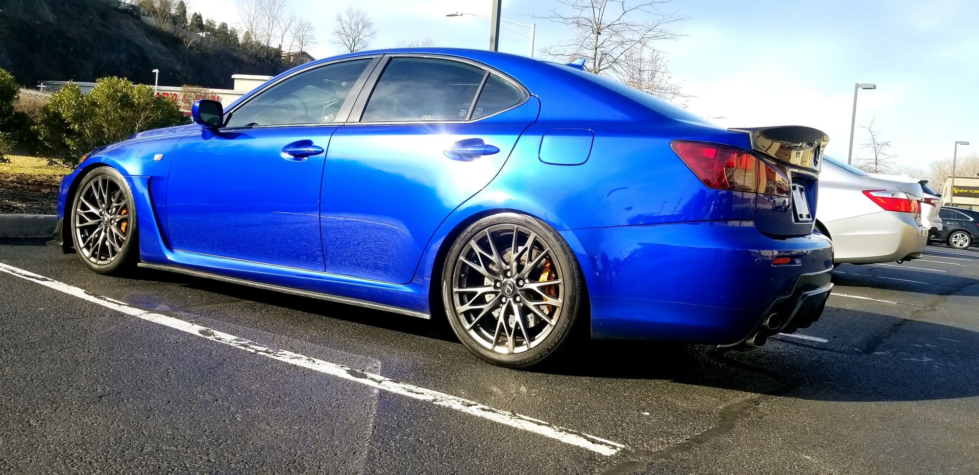

Here are pics of my F air out to 25%. This is my parked setting. I have 3 preprogrammed settings two driving one parked

My current normal driving height setups. With Airlift3H suspension I can change my ride height and dampening as needed depending on roads conditions with in matters of minutes. And with Figs LCA there is noticeable difference in NVH.
Typical ride height
This is my lowest driving setting when on perfectly smooth roads
Rear shot yes I'm parked in the handicap parking spot, because I'm handicap now, my ISF is in better shape then me LOL
Now that that you see my different ride heights from different angles hopefully it helps with recommendations

They are TE37 Sagas. Hands down my favorite wheel. I’ll post clearer pics today. They don’t poke, but the angle I shot at was to capture tire bulge and rim protection, and it does oddly look like they are a much lower offset in those pics. I’ll get front and top down pics to show true placement. I think you could tuck on a 45 offset, but they are still a low enough offset to widen stance and fill the fender wells. I went with the 45 so I could lower without fender mods and still run lots of tire.
