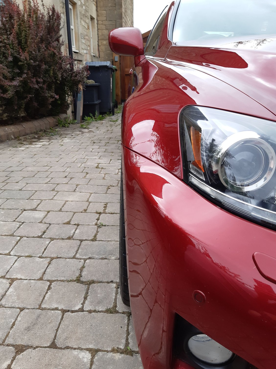

Cheers guys, its 8.3mm clearance on the control arm, so its tight but I know 285/30s are run without spacer by other owners & a 35 makes no difference to clearance. As we know, manufacturers vary in size slightly so it's a suck it and see. I'll report the findings.
So this is the 285/35 18 on a 9.5 +45. Will need a trim or roll as its way over size at 25mm bigger than the 275!+
This is the 275/35 on the same rim. Fits great, 5mm+ clear of the control arm, and at full locks L&R. Stock height btw.
I wont be messing with bodywork, going with Toyo R888Rs in 275/35 in the rear.
This is a 275 next to a 285. Same tyre type on the same wheel! Even if it was 15mm bigger that would have worked. Be careful people...
