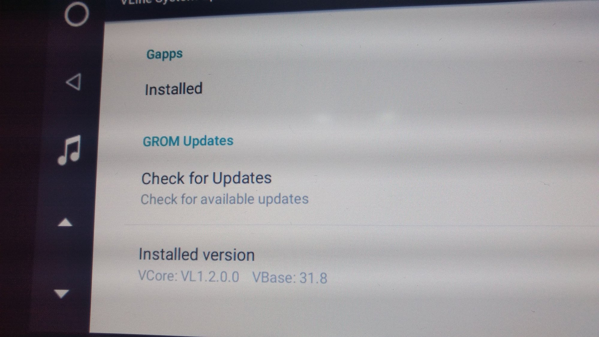

Can you please check what is the FW versions on your VLine (Settings -> About Device -> VLine System Update) ? Is it gen6 version ?
This is what I have
Old Apr 30, 2017 | 06:37 PM
  #482
gromaudio's Avatar
gromaudio
Vendor
Joined: Apr 2016
Posts: 1,086
Likes: 202
New OTA will fix the issue. You have new VBase firmware and old VCore. I hope by end of the week it will be released.
