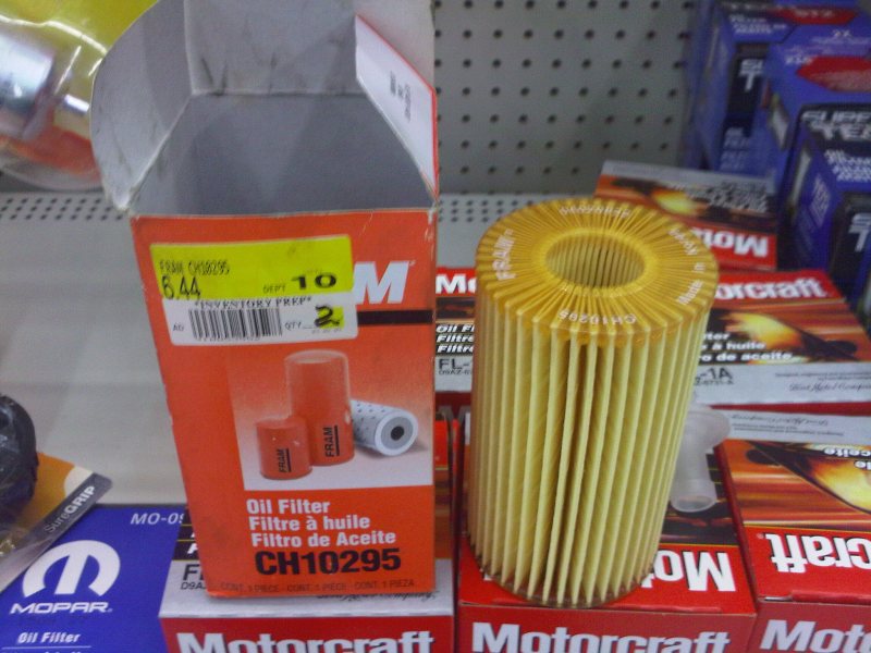

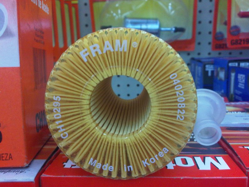

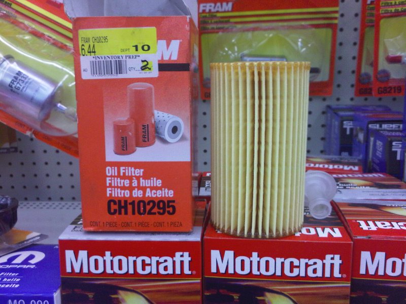

Now...Today I was at Wal-Mart waiting for a prescription fill and I saw the Fram filter for the 2UR-GSE. It's yet another design and color. See below:
No idea if it fits, but it looks like it should. Of course so does the Purolator until you actually stuff it into the housing. No, I didn't buy one. I have 9 YZZ4 filters in a box at home. It's going to be a minute before I run out of them.
