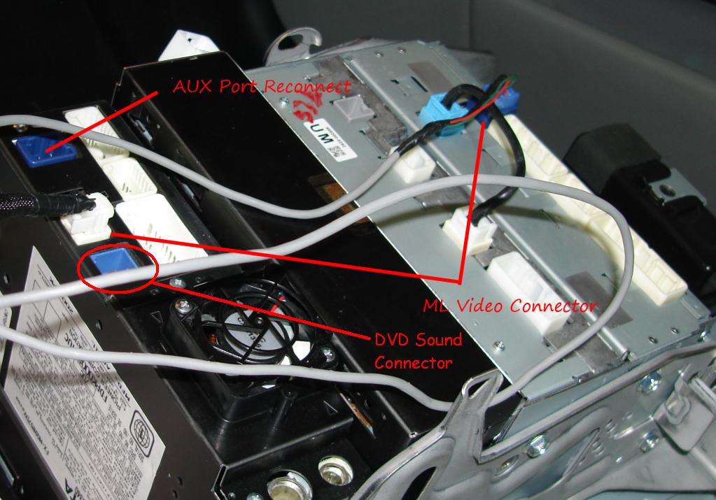

brattygirl - the DVD sound is a single connector. I've borrowed the pic from the ISx50 NonNav to Nav install thread to show the location of this pin. It is a single pin connector and it only affects DVD sound. Be sure it is plugged in. There is also a splice underneath the console for this wire that could be a problem too.
Here's the location of the splice - it's ST1 in the diagram:
HTH!

lobuxracer,
Thanks for taking the time to show me the images of the ML system. I am positive that there is no wire connected to the DVD sound connector. I looked at that connector several times because there was no wire attached to it. I will disassemble the console again look for the missing wire and double check the ST1 splice. I am going to try to get to it this weekend. I will keep you posted. Thanks again for the images!

i can't remember the IS i did anymore, but on my gs and ls (both with ML), i believe there is a harness for that plug. iirc it's tied together with the two wires that's like RCA plug to the two jacks (on the bottom side of the picture lance posted). but that's on the ls and gs, on the IS i can't remember exactly
dunno if it helps, but in case that's the case, maybe you can try to trace the two jacks that i mentioned, and see if there are any other plugs tied together with it?

^^ I tried pulling up more pics from my nav overide install, but I couldn't clearly see that wire or plug on the back of the unit.

i can try to go through the pics i have too, but not sure if i took picture of the bottom part of the unit

Thanks Guys! I am pretty sure the DVD connector is the issue. If you find a picture of the bottom of the unit that would be great.

Yes. The DVD sound connector is simply a wire that connects the DVD Changer to the main screen....
Try unplugging it and plugging it back in...???? Maybe the pins are not lined up correctly?
