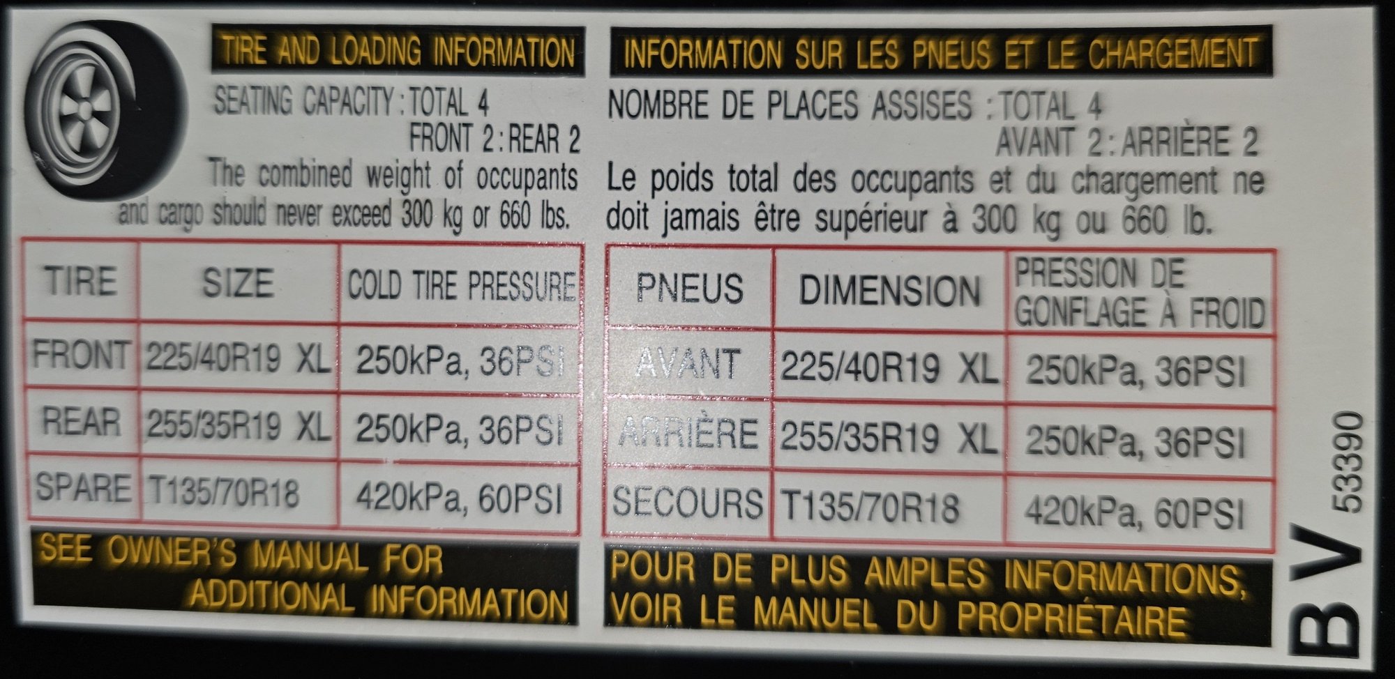

Also another question for you guys, are the tires supposed to be at 35psi all around? I thought the rear was supposed to be higher around 37 compared to the front

The sticker on the driver's side B pillar says 36 psi on all four corners.
It sounds like there's an issue with toe in at the back of the car. Might even be slightly toed out which really makes the car unhappy.
My wife's GS F runs those same Bridgestones in the exact same sizes. Her car is 100% stable at any speed. If it's tires, it's your specific tires, not the brand and model.
When you do an alignment does the toe in the back get adjusted? I’ve never done one myself but we have the equipment at the shop. What do I tell my guy when I bring the car to him tomorrow?
Also I believe my cars sticker says 35 front and 37 rear psi? I would have to double check

The only adjustments from the factory are toe front and rear. Everything else is replace parts until you are good. This sticker is on every IS F I have seen.

Not sure exactly what I was talking about with the tire psi sticker haha thank you so much for your input!
