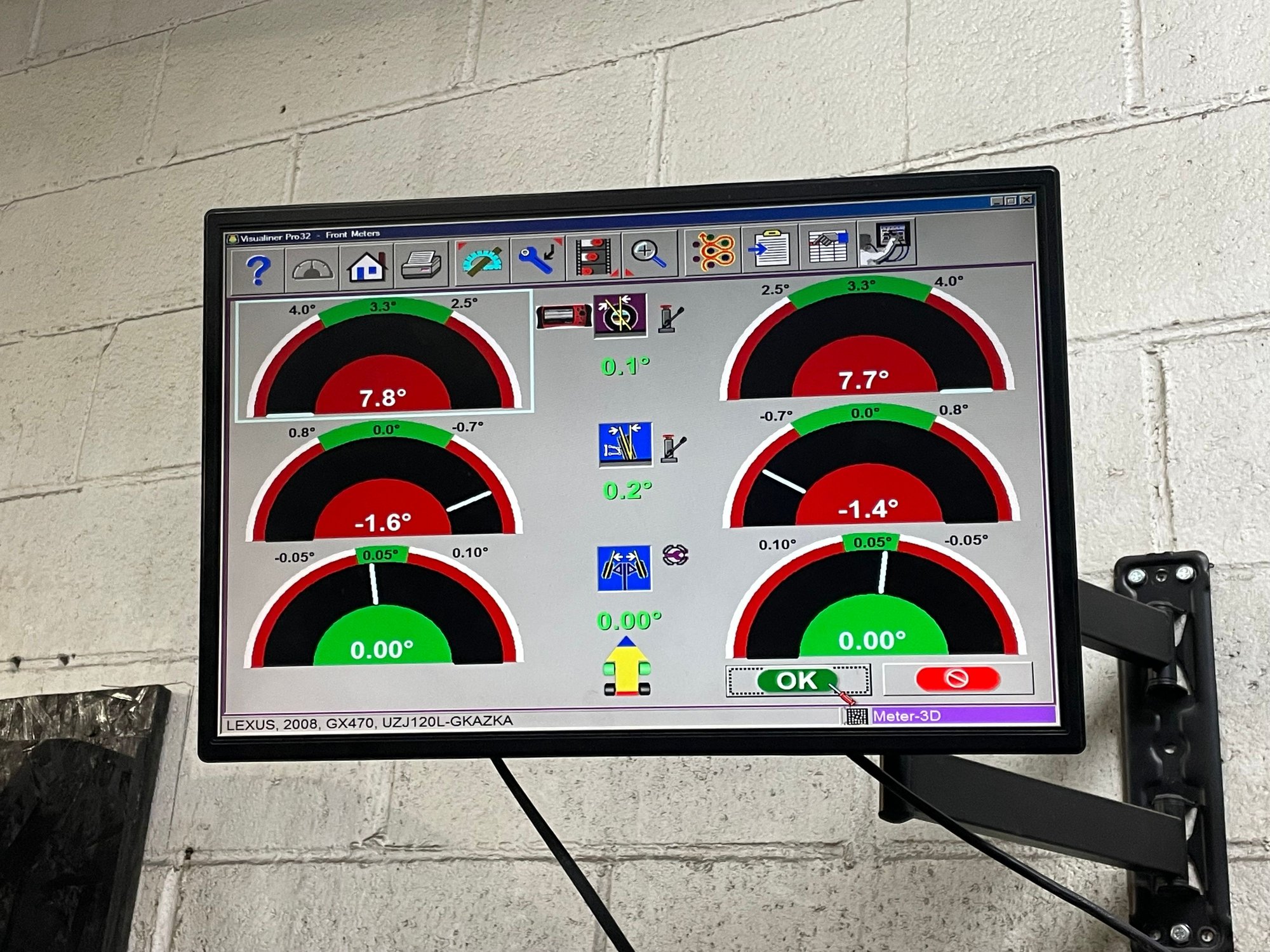

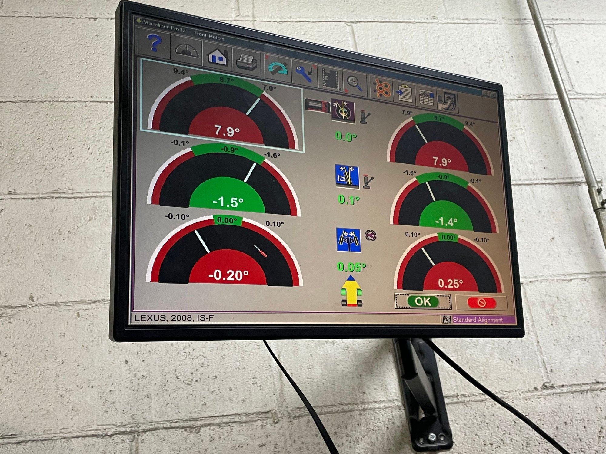

Currently at pops shop setting the car up for alignment, being super confused and not knowing anything about this stuff I’ll drop a picture of what my alignment looks like now.
If anyone can give me some recommendations to do something aside from just alignment based on the readings please let me know!!
Before alignment specs

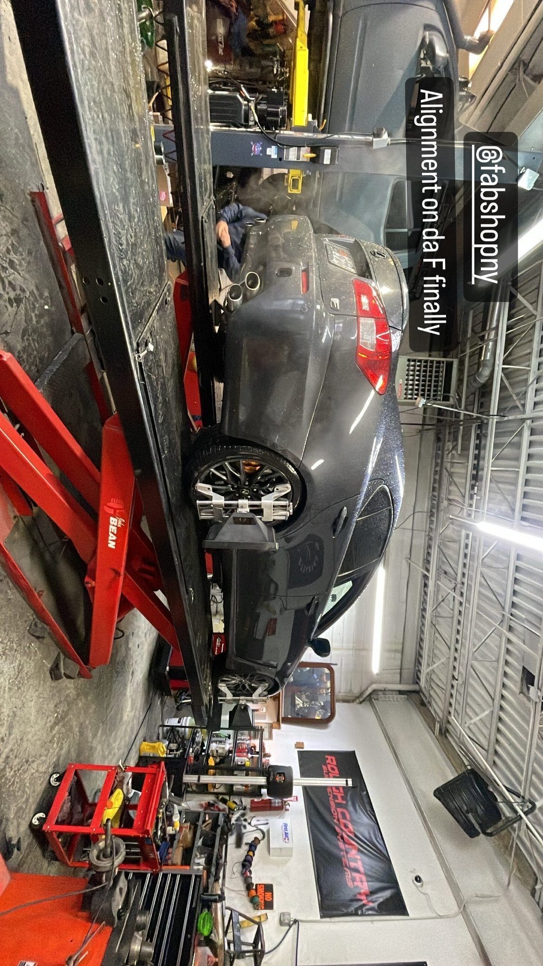

Da whip on the rack lol

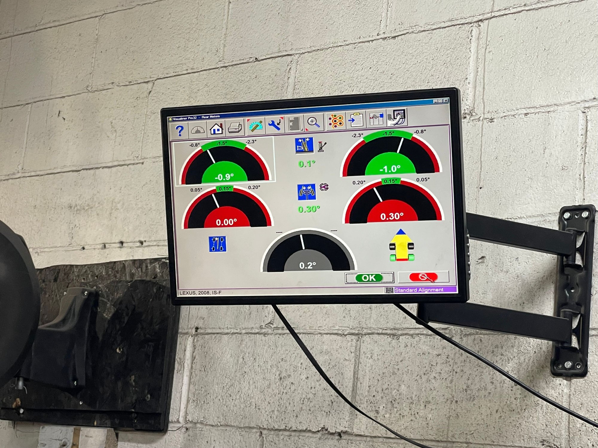

Alignment done, so far driving feels better 100% unfortunately it’s raining today so I can’t really push the car to its limits.
below, I will attach the alignment numbers after we got done with it. Let me know what you guys think.
This looks like the rear alignment and toe is way off. At least camber looks good. No new recommendations. Your alignment target numbers are not based on current numbers.

First post is not helpful. Second post shows good numbers front and rear with OEM bushings.
Yup toe was very bad.
What do you mean by my target numbers are not based on current numbers?
Also wanted to say that I checked the air on the tires again and it was all at 34psi… I was using the jacked up air gauge when I initially filled up my tires. They are now at 36psi
You mentioned performing alignment based on the readings. What I meant to say was that your starting numbers are irrelevant. Maybe I misunderstood you. Looks really good now. Hope this resolves your stability issues.

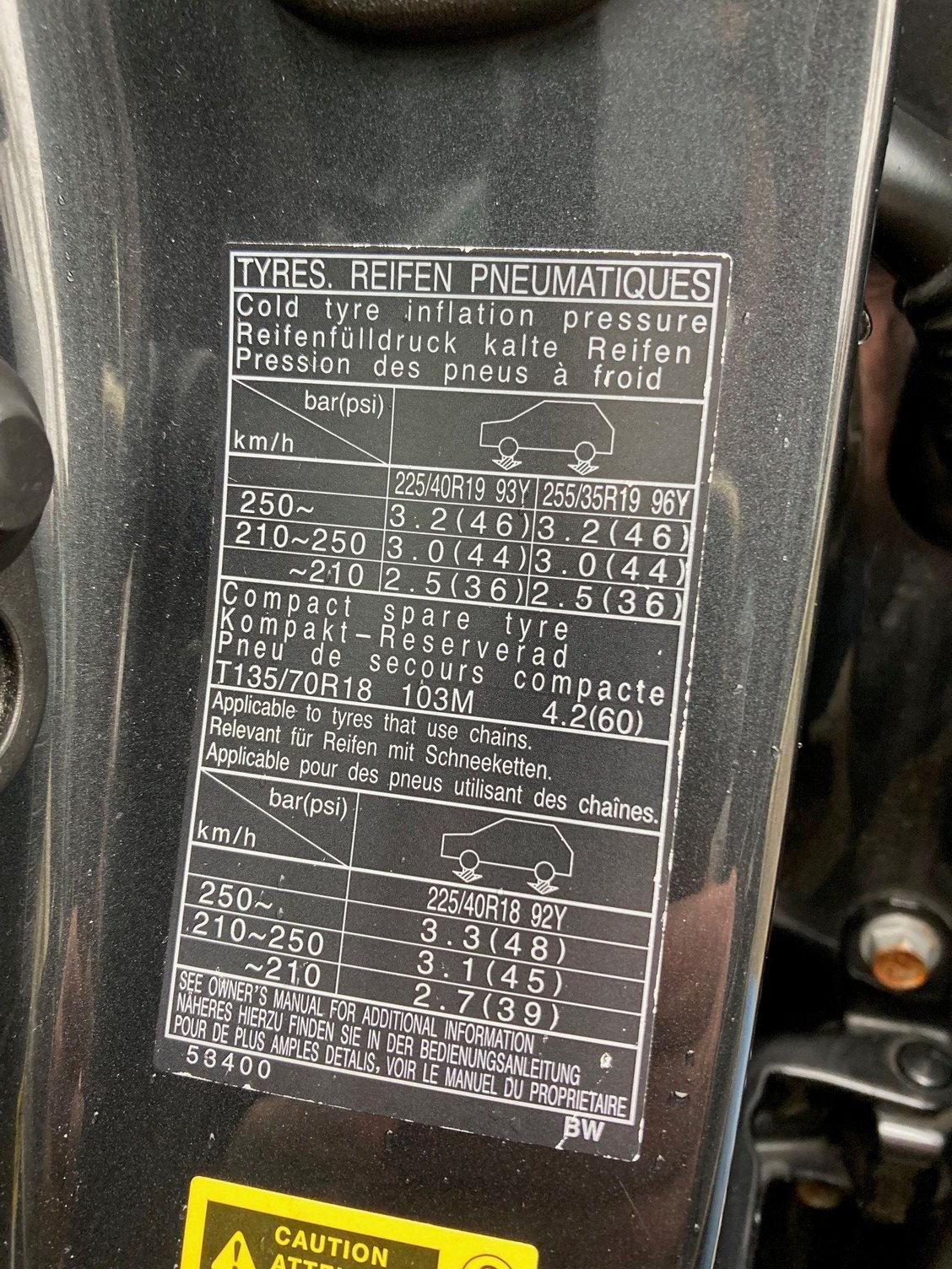

the sticker for the ISF designation Europe
This is interesting data. The tires in the US have a maximum pressure of 44 psi on the sidewall of the tire. I am surprised at these numbers assuming the European versions of these tires have the same limits. It's certainly possible they are different for the European market, and given the specs on the sticker, I can only assume they are. Lexus in the US would never recommend inflation beyond the manufacturer's specification. Their attorneys would have a fit if any engineer did this.
​​​​​​Tire Rack shows max inflation pressure of 50 or 51 psi for the high performance tires I looked up. looks like some H speed rated tires spec 44 psi. I think the tires are the same in Europe except that they specify higher pressures for very high speeds above 210 and 250kph. Guessing that's to lower the rolling resistance and keep tire temps in check at those speeds which are not unheard of on the autobahn.
Don't think so. The load and speed ratings are the same as the North America, 93 & 96 and the Speed Ratings are "Y" or Up to 186MPH (300KPH) Max inflation seems to run about 50PSI for performance tires in those sizes.
However, unlike the American tire sticker that only lists one recommended tire pressure, the European sticker lists three for different speeds
Just checked the sidewall of my PS4S and it's marked 50PSI.
