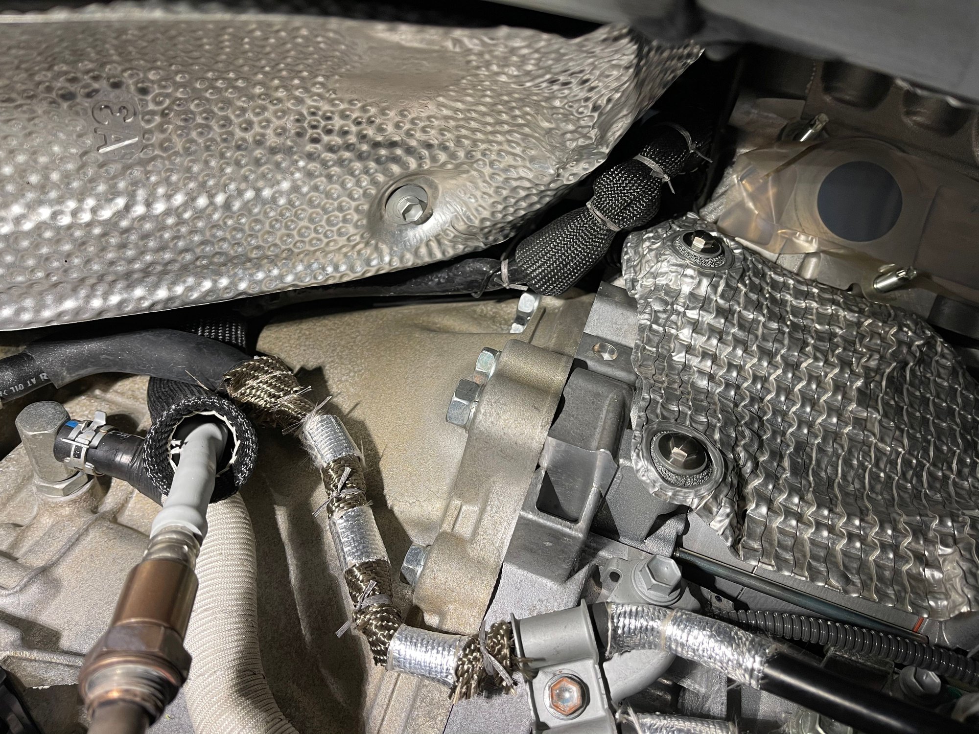

I added a layer of heat shield over the new starter when I installed the novel headers.
also insulated the power steering ECU connectors
Made my own extensions for the O2 sensors and routed them way up almost to the top of bell housing
Also, good idea to heat wrap the motor mounts. whichever one you have.

Wow that looks great. Thanks for the pictures. I wish I had the time and space to do it properly like that. I will try to add some additional shielding to the wires at least.
