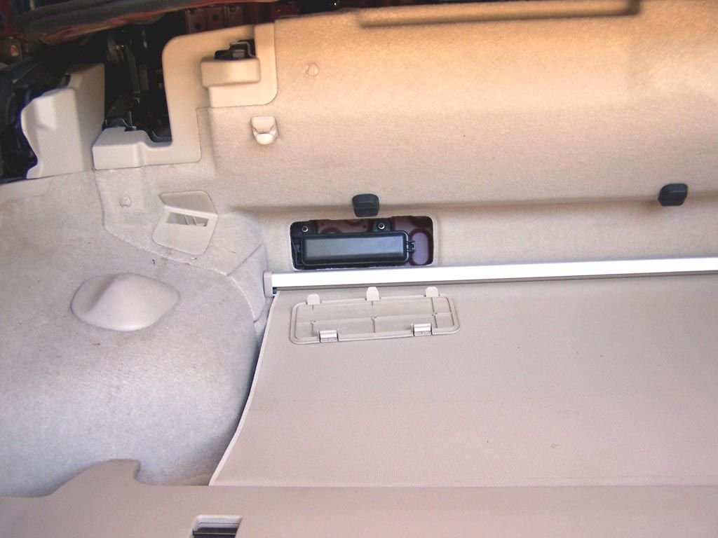

Fuses. In the trunk on the drivers side all the way forward in the back of the rear seat is a fuse box. Unhook the luggage cover and lay it flat on the floor to see the fuse cover.
