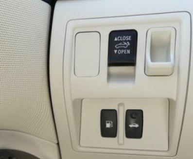

Here is a pic of what the 2010 has instead of the double switch for reference- Thanks everyone! -Jim
This is how my 2010 looks like when I got it. Doesn't look like this anymore though lol. Have a digital air pressure gauge there now. Good luck on your search for your 350C
