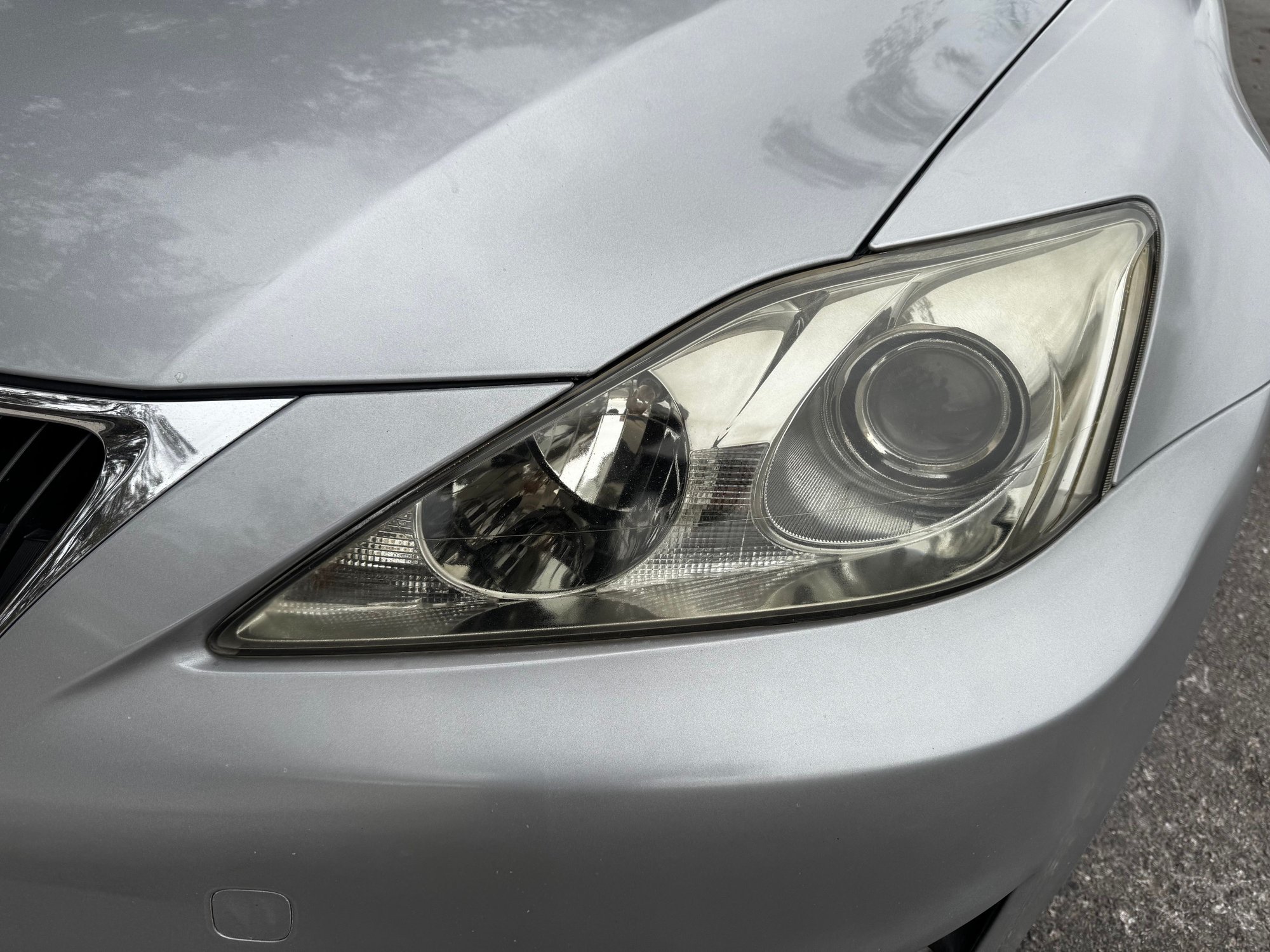

I’m having trouble determining which type of replacement LED bulbs I can put in my factory headlights.
I bought the my 2011 IS 250 used in 2015 and have never had to replace a bulb, which is great, but I want to increase the brightness.
This is what my headlights look like. Are these using halogen bulbs?
Thank you, experts!!

Your 2011 Lexus IS likely came with a Bi-xenon (HID) system, which uses a specific type of bulb for both low and high beams. But remove one of the bulbs from the headlight assembly and look for a part number printed or stamped on the side of the bulb. The number will often be a designation like "H11" for HID or "9005" for halogen.
Important note for handling headlight bulbs - DO NOT touch the glass part of the lamp. If you do, clean it VERY thoroughly as the oil from your skin will cause the bulb to shatter when turned on.
