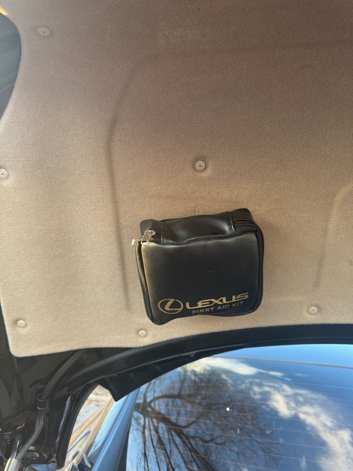

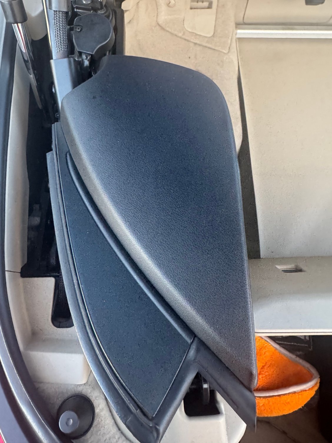

Hey guys back with an update so It looks like it was just a first aid kit that was not letting the two panels come out or back in ( I’ll take a picture of the panels and first aid kit) every time I tried to close with the switch or open it would hear it work but it’s was because of the placement where the first aid kit was it was blocking the panels from moving
Panel would move to the right when switch is activated
By Coincidence the panel would be move to the right where the first aid kit would be that’s why it wouldn’t open
I was able to get to the trunk by using the override with my key fob and was able to open and move the first aid kit, thank god I didn’t agree at the dealer for the diagnose which would be 400 to start plus the labor and all… don’t make the same mistake I did
