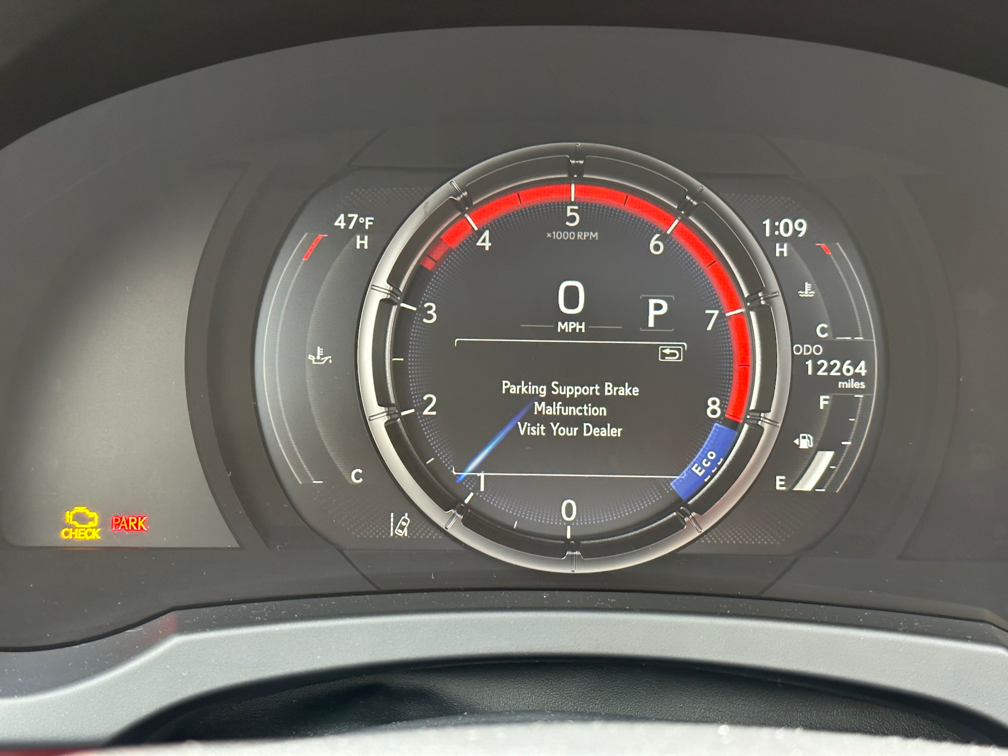

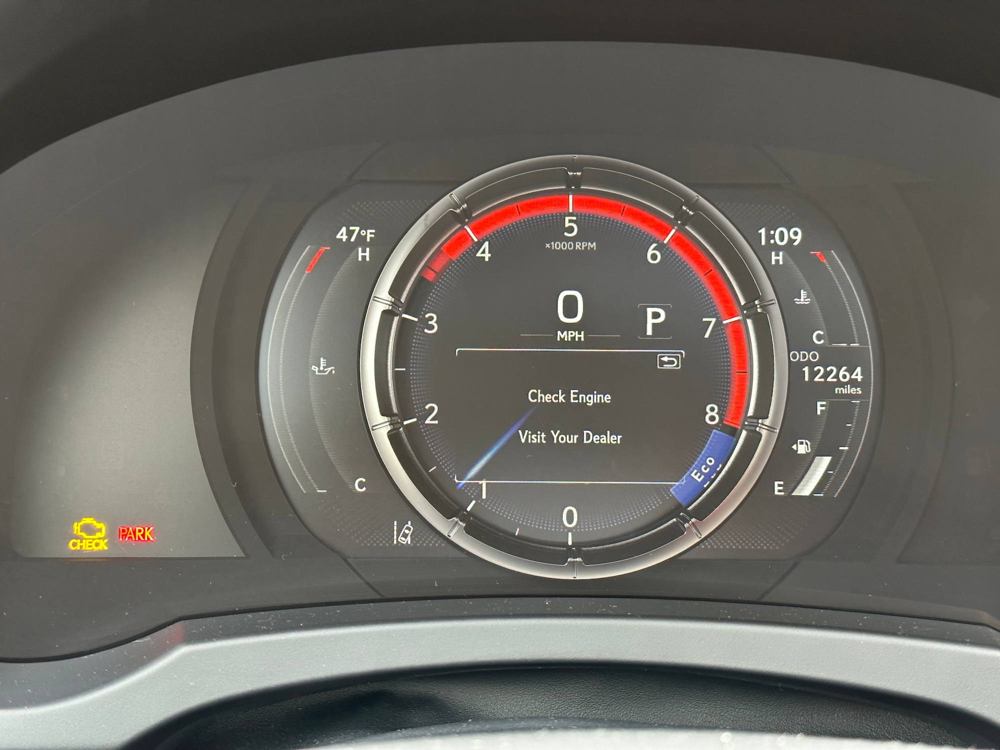

Sooooo, guess it's my turn...Ugh! Thought I got a Check Engine Light pass when I made it to 10,000 miles with no issues. I informed the service department that this is likely a gasket issue, buuuuut they claimed they can only act on the results of the system scan which is as follows:
"Checked for codes and found P013A. Oxygen Sensor slow response rich to lean bank 1 sensor 2. No TSB for this code at this time. Cleared codes. Checked for exhaust leak. No leak found at this time. Road test vehicle. Could not duplicate issue. 02 sensors are in range. Monitors passed. Need to create TAS case and check vehicle again. Customer did not want to leave vehicle at this time. Will reschedule for diagnosis."
No Toyota Service Bulletin was surprising given this is clearly an issue with this model. At any rate, it's cleared for now, but I suspect I will need to return to the service center in the near future as the Check Engine Light may very well return. Will keep you posted...

^^ That sucks....It seems it was happening around this time last year too. Maybe these are prone to Dec/Jan/Feb weather (lol)

Awe hell!! 🤬😞
I’m almost at 10k myself and I thought mileage that high meant you were safe. ::sigh:: Hang in there and thanks for letting us know!
1. Good on you for not leaving your car there, I wouldn’t either.
2. Why on God’s Green Earth were you in ECO?! 😜
