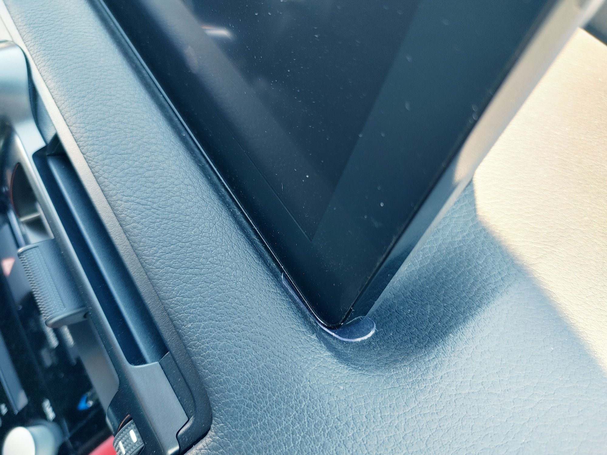

Originally Posted by Muinarc
I see in the video around 4:45 that's exactly what I was looking for. I'll report back when I try some fixes in case anyone else gets this rattle.
Long Term follow Up:
After taking the rear cover off and messing around I settled on the interface of the bottom of the screen and the top of the dash as the culprit. I started buy shoving a business card under the corner (for me this was the passenger side corner) and the rattle was gone for about a month. After feeling like I had this solved I started looking for a more permanent solution.
I wanted something low-friction and that would last nearly forever and not have any interaction with the weather (paper can swell) and eventually I thought of this:
Not this item per-se but the remnant-punch-out piece (oval part where hook goes) from hang tags. I used to work retail as a teen and randomly thought of this after searching for sheet plastic in whatever "mil" thickness I would need. You could still go that route or order something along the lines of what I posted above and cut out a piece, but what I used was FREE! I just looked for one on the floor of the hardware store I was in when I thought of this
After getting the part I needed for this "fix" I trimmed it down a little with some scissors and then shoved it under the right-had corner of the screen. No more rattle! I left the piece slightly long so I can remove it with something like tweezers if I should ever need to, so this is easily reversible. That part of the dash is recessed too so you would never see anything.

I took a picture of where/how the plastic piece was installed in case anyone needed the reference.
