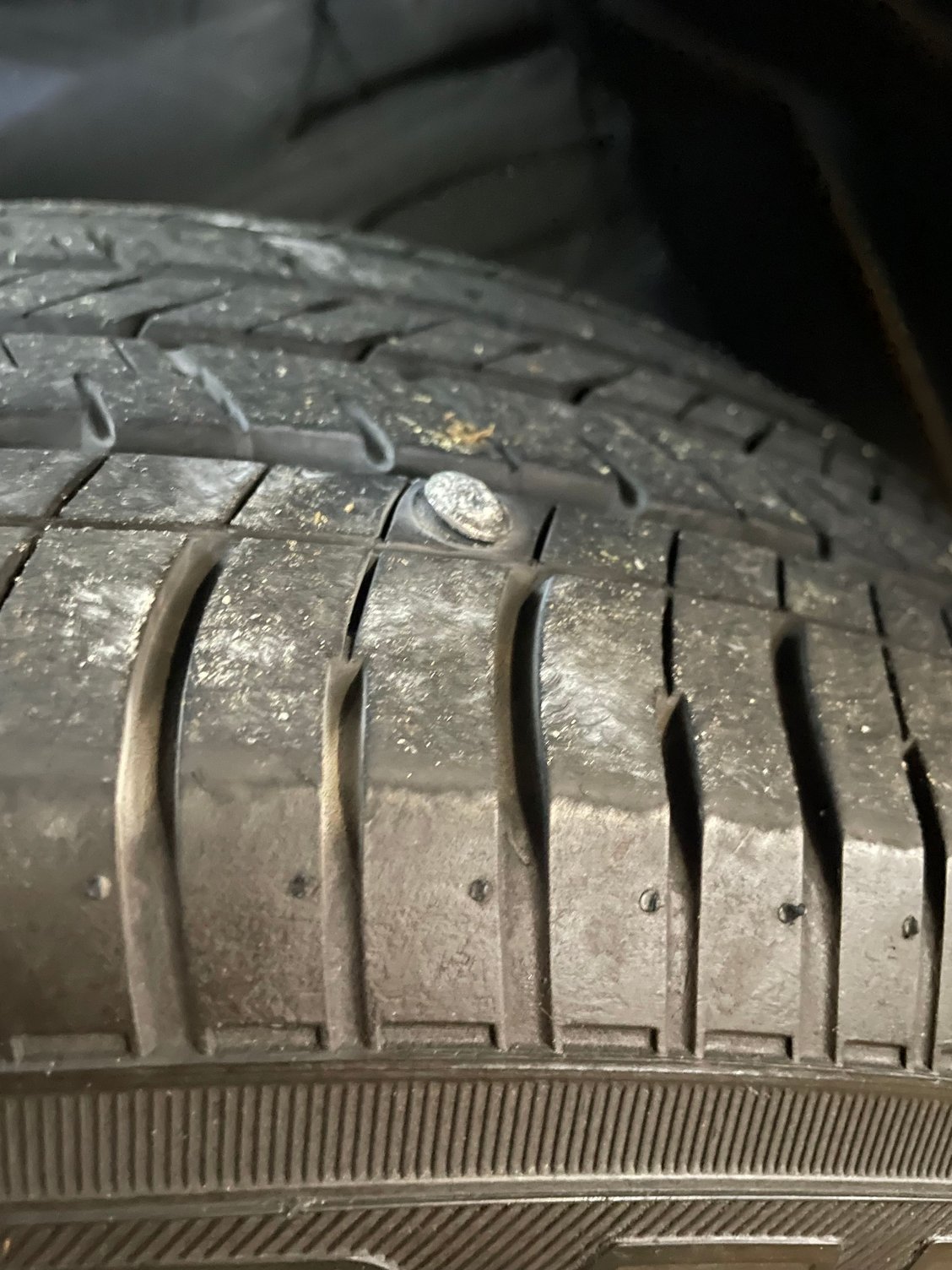

Serious question, can you actually see the slash and do you have a pic of the slash? Or are you just assuming it was slashed? Because like someone else said a slash is a fast leak not a slow leak.

Yeah where is the damage? Is it in the sidewall or the tread? If it's in the sidewall, it's probably unsafe to drive on it especially at highway speed.

I found a screw about 1/4" long in my NX300h about a week before I traded it for the IS. It didn't leak but I could hear it and kind of feel it on the road and every time I checked my tires it was apparently on the bottom side until I finally found it. I pulled it out and no leak . Just goes to show you could have a screw or nail and not know it. As others have asked, do you actually see a slash or cut?

I thought so yes, but as you guys said, it was so slow, turned out to be a nail.
Here’s what I initially saw in the sidewall though…
