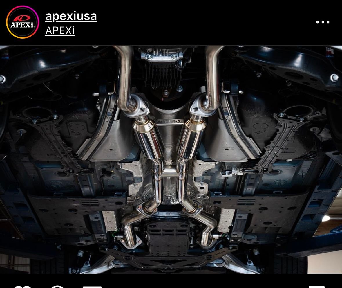

Originally Posted by Bechtold
Any pictures of the installation? Would be nice to see what it looks like as it's not something you would see on the street.
looks like this minus the resonators

Alright serious question: where are the missing underbody panels and center brace? It's suspiciously missing. Does it not fit the Apex catback?

I had no issues putting the center brace back. Plenty of room and well designed. Thanks.
