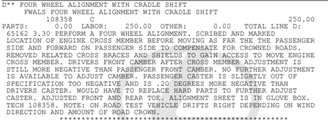

Now I'm on my third set and even after wheel balancing this happened after 14,000.00 miles from third set fresh (third set put on at 65000 and I've attached notes taken by dealer at 65000). Current miles at 69000.
I do not drive aggressively or race my car. I heard some conversations about control arm.
Anyone willing to guess ?

The issue is inner tire wear. This is common on the IS and is fixed by getting new Lower Control Arm (LCA Bushings). You can buy OEM RCF LCA's or you can buy aftermarket ones from RR Racing or FIGS (I've heard better things from FIGS).

From what the dealer wrote, it seems like there could be suspension components that need replacement in order to correct the out-of-spec camber. It seems that excessive camber is causing the inner parts of the tires to wear out prematurely. Maybe try asking the dealer to clarify what they said in plain English?

thanks guys! Will note your thoughts and discuss with dealer guys.
