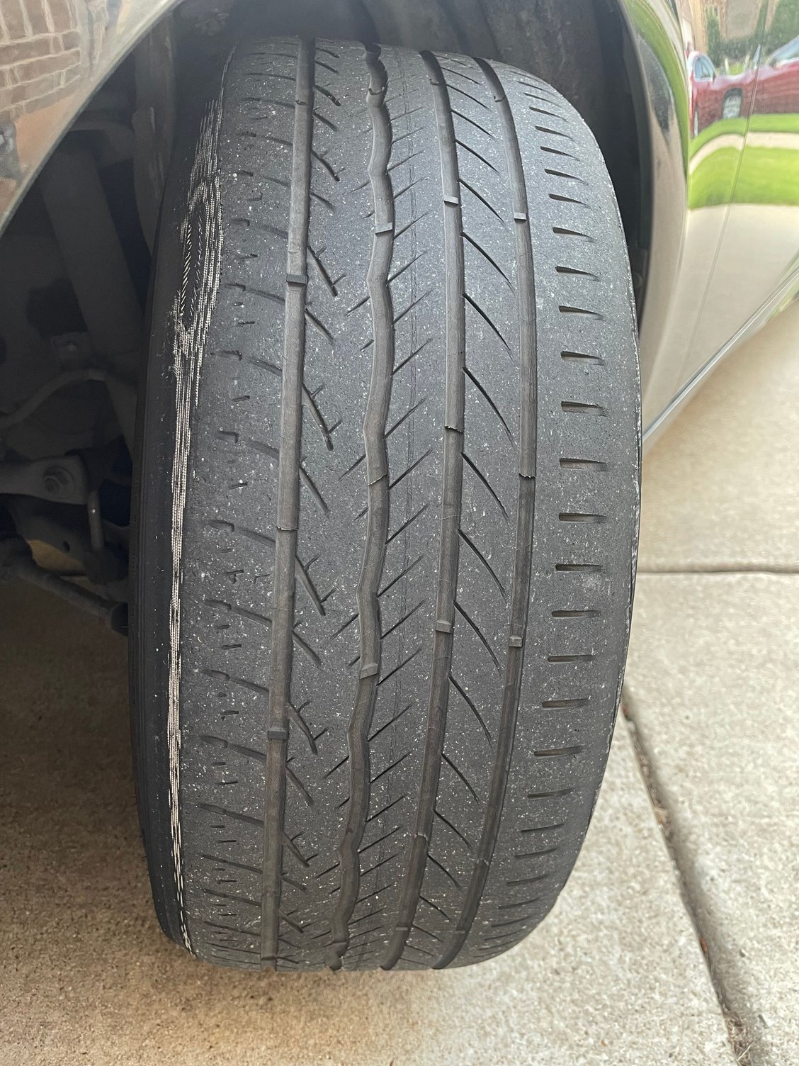

Originally Posted by Nabil3IS
The issue is inner tire wear. This is common on the IS and is fixed by getting new Lower Control Arm (LCA Bushings). You can buy OEM RCF LCA's or you can buy aftermarket ones from RR Racing or FIGS (I've heard better things from FIGS).
That is an issue with the IS but this is more severe than just the inner tire wear issue.

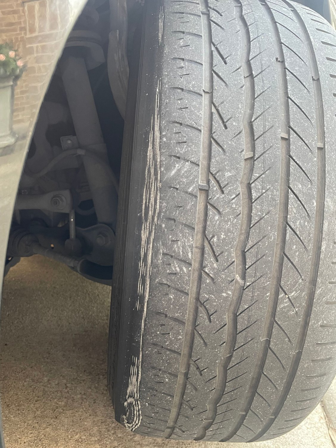

Default I have same issue. 2015 IS350F

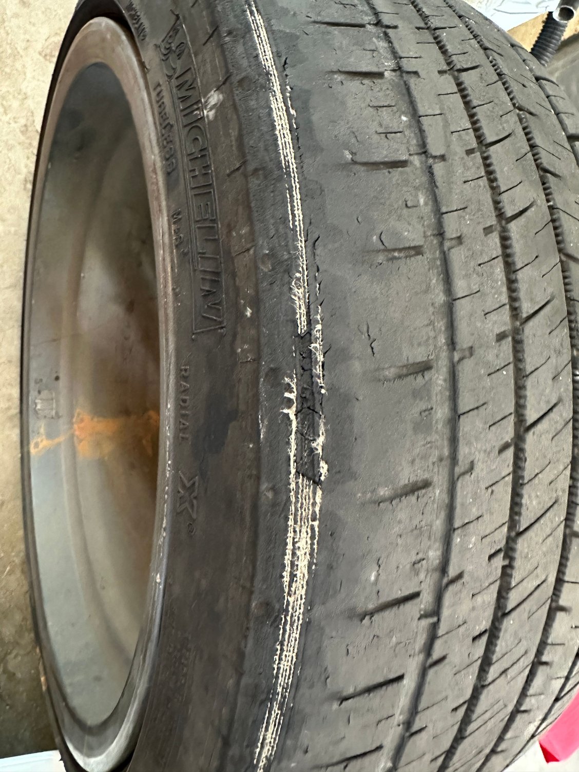

Originally Posted by Pacman1193
Folks.
After I got my 2016 IS200T I swapped the rims via dealer (Park Place).
Year of purchase: 2019
Within a year the tires wore out I thought no biggie and replaced em.
They wore out. Replaced em again.
Now I'm on my third set and even after wheel balancing this happened after 14,000.00 miles from third set fresh (third set put on at 65000 and I've attached notes taken by dealer at 65000). Current miles at 69000.
I do not drive aggressively or race my car. I heard some conversations about control arm.
Anyone willing to guess ?
Mine are the same. 2015 IS350F
WELCOME TO THE CLUB BROTHER. Is that a rear or a front ?
Old Aug 2, 2023 | 06:13 AM
bradwal's Avatar
bradwal
5th Gear
Joined: Dec 2019
Posts: 5
From: il
Default Front
Front Passenger side

WOw, mine is not that bad, you guys drive like this? That long? My front is worn both inner and outer but not much and I felt the car wobbling, I replaced RRACING LCA for months now and it seems to fix the issue. the RRACING LCA makes me Lexus RC350 feel like driving an M2 BMW M-performance.
This issue did not happen with my IS350 3rd gen, I'm trying to figure out how and why this happened on my RC350 but not IS350.
