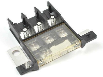

@Pittsy Is correct you toasted the Main Bus Fuse, I happen to me on my GS350, also its a pain in the *** to replace but doable as there are 3 10mm bolts holding main lines from fuse and they are at the bottom and not easily accessible as the fuse is also in a holder. On the GS350 is located in the fuse box just in front of the battery

This is what the Main fuse looks like for the GS350
Here what the one n the IS250 looks like
