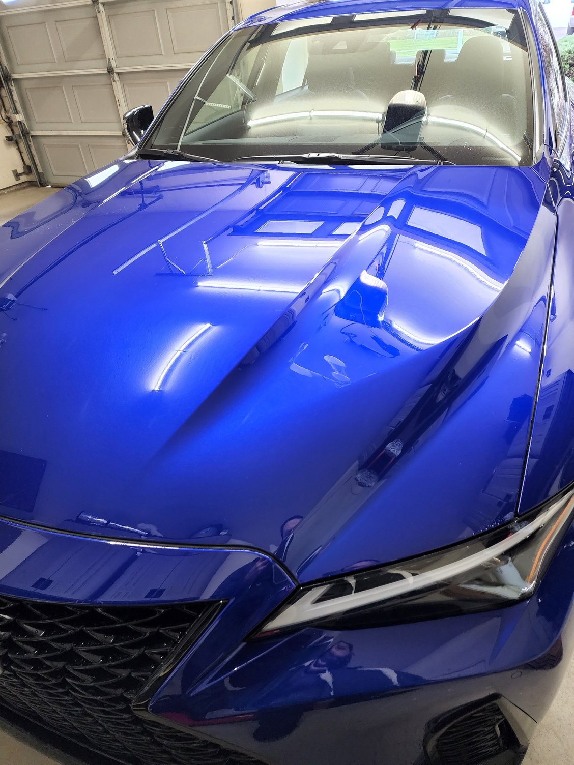

This is just a little teaser for anyone wanting a ceramic coating. I did 1 base layer of Gtechniq crystal syrum lite and a top coat of Gtechniq Exo v4.
I literally drove home in the rain today and this is what my car looked like as I pulled into the garage.
it was the easier ceramic I've ever done, too. Strongly recommend a ceramic coating!

I've used Adam's and Carpro and they both have a "ceramic boost" spray that is supposed to prolong the coating. The Gtechniq does not, that I know of. The Exo top coat will last 12-18 months so I will just reapply it yearly as my maintenance. It's so easy to apply I won't mind the yearly coating. That is the only maintenance I will do.
Oddly enough, I spray the ceramic boost on the RX hood, but skip the doors a lot of times and the hood coating is still working great. The doors are starting to slightly lose their hydrophobic properties after 2 years. I will just spray the boost a little more frequently on them for now. I think we might do a PPF on the front of the RX then I will recoat it with Gtechniq.
